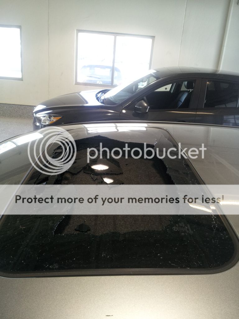

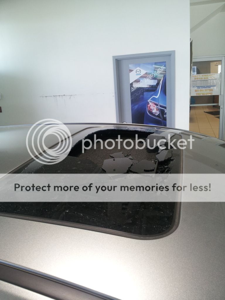

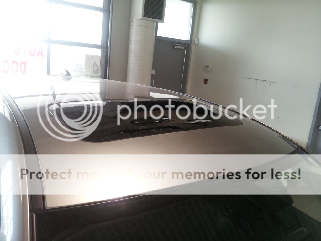

I have a 2014 CX-5 Touring. I was driving when all of a sudden I hear a loud pop. I realized it was my moon roof. It was windy and I had the window all the way one. I have it fixed now, but I have a few questions.
1. Has this happened to anyone here?
If so, what caused it?
2. I'm considering on getting a moonroof wind deflector. Has anyone put one of these on? If so, what are your thoughts about the deflector?
The deflector at the dealership is quite wide. When I set it in to see how it looks, the deflector looks like it will take up a 1/3 of the opening. Plus, I don't care for the look, however I don't want to buy another moonroof. I haven't purchased one, just wanted to get your opinions on the deflector.

  1. I've seen someone had similar experience on a VW Passat board. The guy was driving his Passat on the highway with all windows closed and suddenly his moonroof shattered! I believe it's a very rare incident and caused by cabin air pressure somehow reached to a critical point to make moonroof glass shattered. Was your HVAC system in recirculating mode? And did your fix cover by new car warranty or by insurance?

1. I don't mind the noise and I like the wind blowing on me. Saves me from rolling down a window and getting the thumping nois. I not sure if the circulating mode was on. Most the time it is on when I'm not using the AC.
2. The dealer wanted $600 to fix it so I went through my insurance.

I too don't think you need to worry about this happening again. Do you think it was hit by a rock? Perhaps the glass was defective?
Same thing happened to mine!! Dealer claimed a rock hit it & wouldn't replace it! There was no one around me at the time! Cost me $700
That looks like mine. There was a truck 1/2 aile a head of me when mine just pop. I went through my insurance. Weird that this happened. Hope it doesn't happen again

Well, the pictures above show what my moonroof looked like on my old 2014.............. after a Texas hail storm. Windshield and all other glass were OK, just the moonroof. Car was 3 years old and never had a windshield problem.
