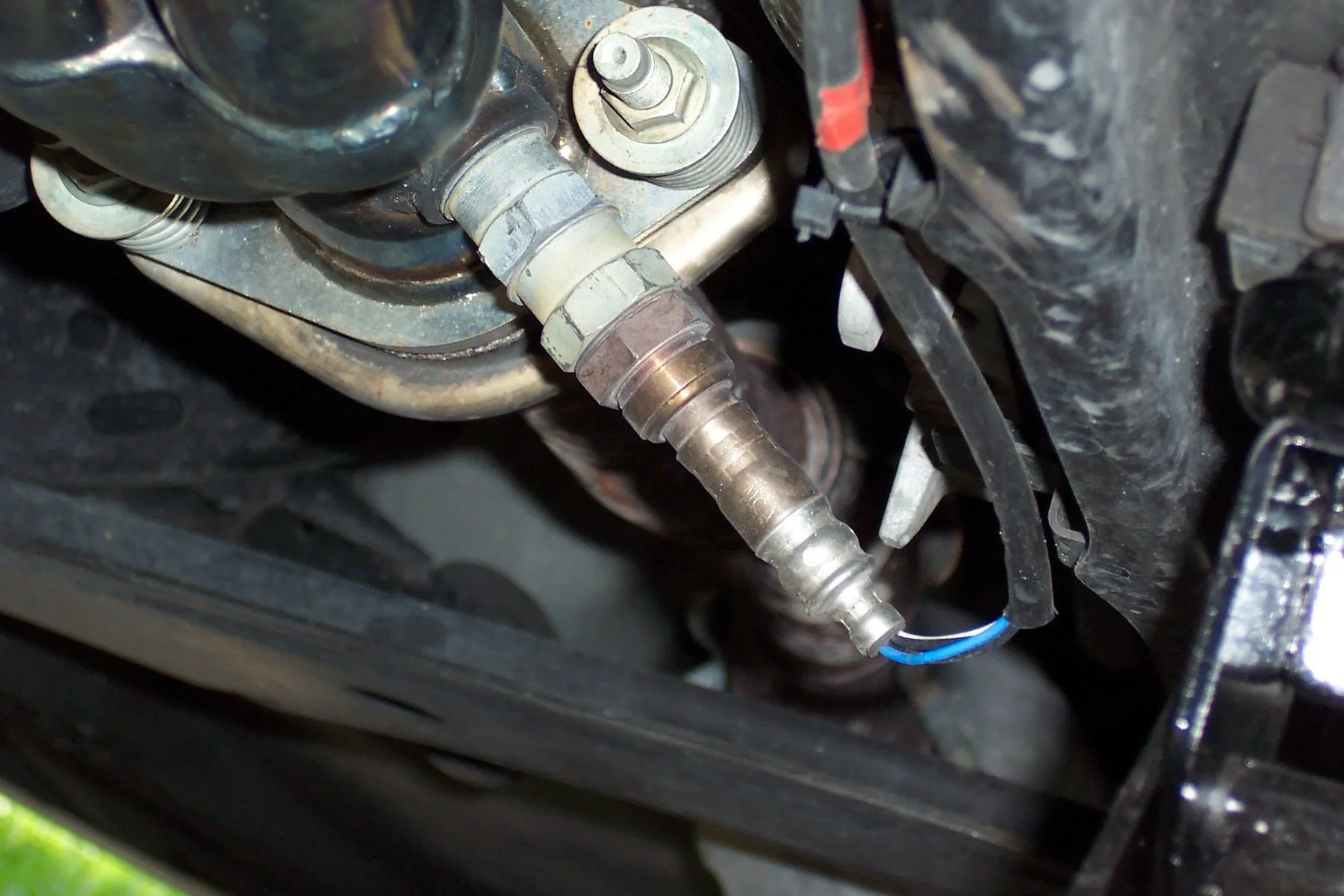

the part # is 42002. That seemed to be useless to the drones here in town. Look for the display with HELP!! int he name. That is where it is. Use a dremel or 1/2 drill be on one of them, screw that one onto the o2 sensor, then into the non-drilled on, then onto the header.
Hope this helps!
tough to say without looking at the top/bottom view. It sure does seem like it though. Here is a pic post install.
