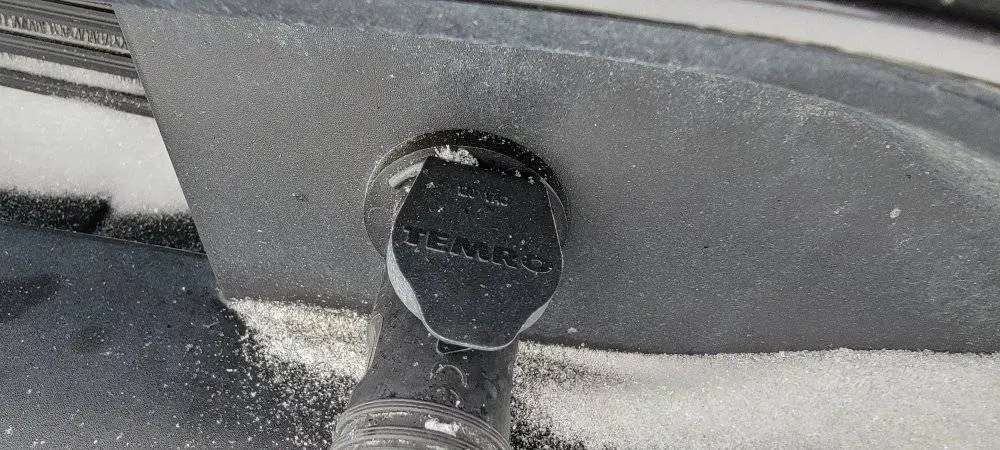

@sm1ke - you have the Mazda block heater installed right? I don't think these are installed for us in B.C. but with a move to the interior on the horizon, it may have to be a future install.
Do you use yours often?
Yeah I have an engine block heater, but I'm not sure that it's Mazda OEM. It wasn't noted as a dealer add-on when we bought the car, but the install looks OEM. You probably wouldn't need it in B.C., but here in MB they are almost a requirement, lol. It gets as cold as -50c around here, and we usually get cold spells of -35c to -40c for weeks at a time. Currently there is an Extreme Cold Warning in effect due to temps of -40c with the wind chill. In Ontario, I think I would get one installed, just in case.
I use mine quite often. Usually once it hits -20c or colder, I plug it in, but with this new battery I'm confident that I could wait until -35c before I'd need to worry about the engine not starting. When it's cold enough, I always try to plug it in, just to ease the start-up wear and tear a bit.
Here's a pic of the block heater that came with the car. It's a capped socket that is installed on the lower front bumper on the driver's side. The cord is easily removed and stored, which is nice in the summer. I'm not a fan of the plug just hanging out of the grille or hood, because when it moves around, it can scratch and damage the surrounding area. The brand of the block heater installed on my car is Temro.
