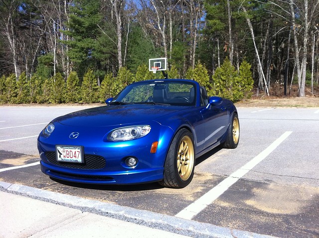

Mia-too! Winning Blue NC FTW

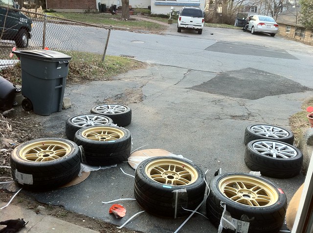

Last night, pulled the trigger on:

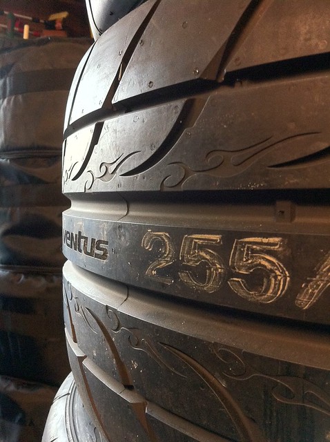

17x9 +45 with 255/40/17 Hankook RS-3's:
Need moar grip!
Plus some black splinedrive mcgard lugs.

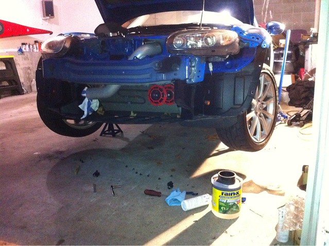

Finally cleaned the air filter last night:
Required taking the bumper off. Definitely not an easily serviceable item. Honestly, I'd prefer throwaway paper filters over AEM DryFlow or K&N stuff.

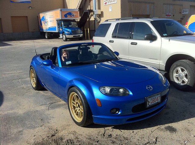

I am now officially BALLIN'!

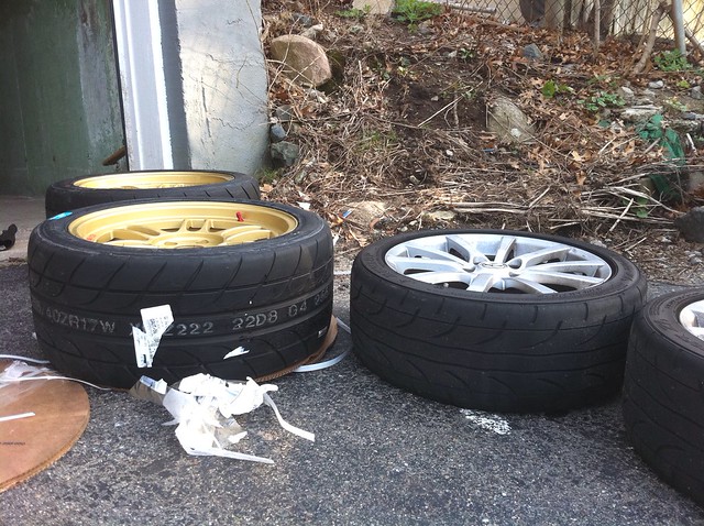

At Marc's house, with a lot of his help, the tires and wheels are on. Waxed inside and outside:
Old vs new:

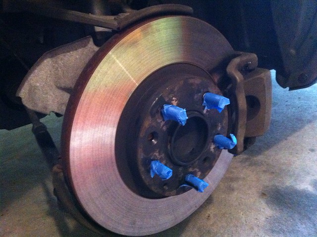

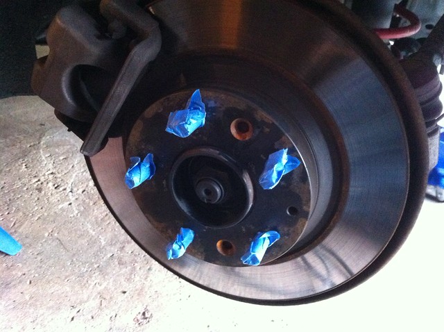

Painted the center hubs and lug nuts black. Before, nice and rusty:
Sprayed the rear axle bolt black too:

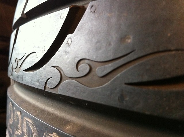

Tire close up, it has silly flames in it!
Flamez yo:

Ballin now!

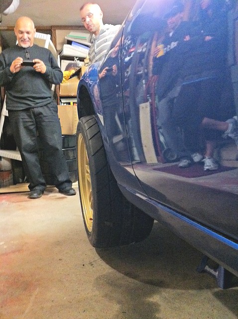

Of course, that's with the rear fenders rolled! It slightly rubs the rear fender still on really deep bumps and does touch the fender liner in the front on the same kind of bumps. So will have to add a touch of negative camber, maybe half a degree.
Haha...holy wide-ass-tires Batman! The comparison photo makes the old tires look like a spare donut-tire.
I feel like I should install some rally-style mudflaps to keep the rocks from kicking up so much
Probably would be a good idea if it looked good. The paint on the car right behind your tires is going to get a beating.
