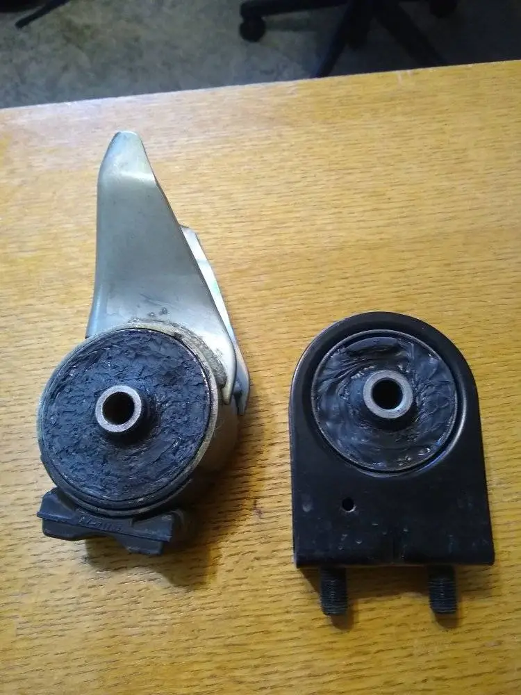

Good thoughts. When I removed my old rear mount, it was definitely worn but not completely cracked or in pieces like I've seen from other members around here. I filled it with some of that 30-duro polyurethane and It's been sitting now for probably 9 months, so it's definitely hardened. I am considering installing it again.
Here is a pic with it next to the front mount that is fully filled with the same stuff. I might have filled it a bit too much. I want the engine to still have at least a bit of room to move back and forth, otherwise the jerkiness transfers to the rest of the car like what happened with the front mount.

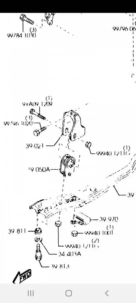

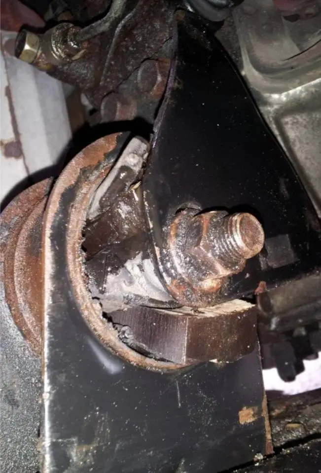

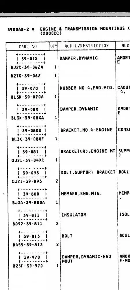

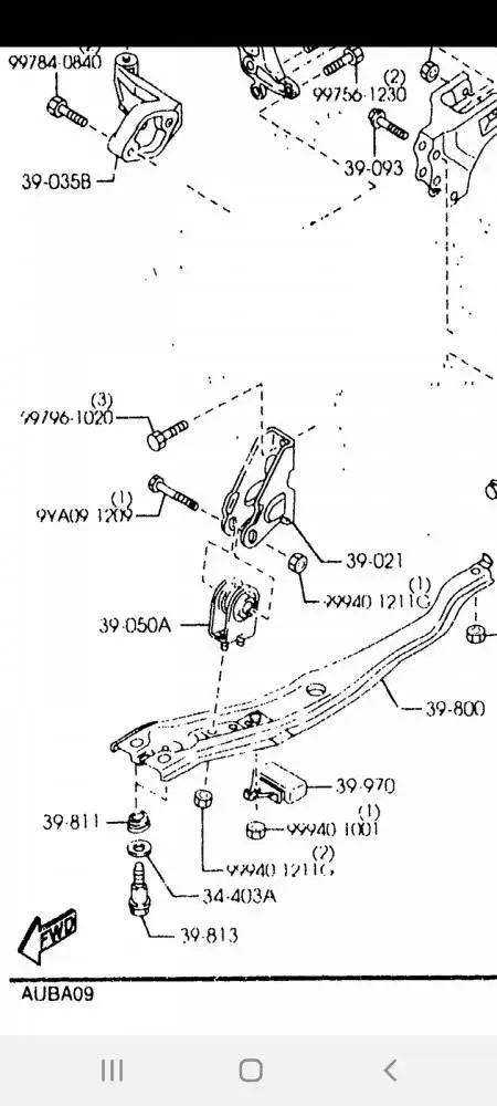

Sounds like you know a thing or two about this. Here's a related question; what if a person fuckered up the bracket on the engine that holds the front motor mount AND the bolt that goes through the front motor mount - where would that guy find the part numbers or order those things? Dealer only probably?
This is a link to the service manual and parts catalog.
I'm sure those parts are in the catalog somewhere.
I remember a few guys that installed hard engine mounts and it drove them nuts.
It was rattling their fillings out of their teeth. Lol
They couldn't see out of the rear view mirror because it wouldn't stop vibrating.
They grew tired of it quickly.
pcb
The Diagram Dude
2002 MP5

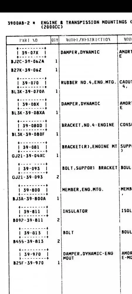

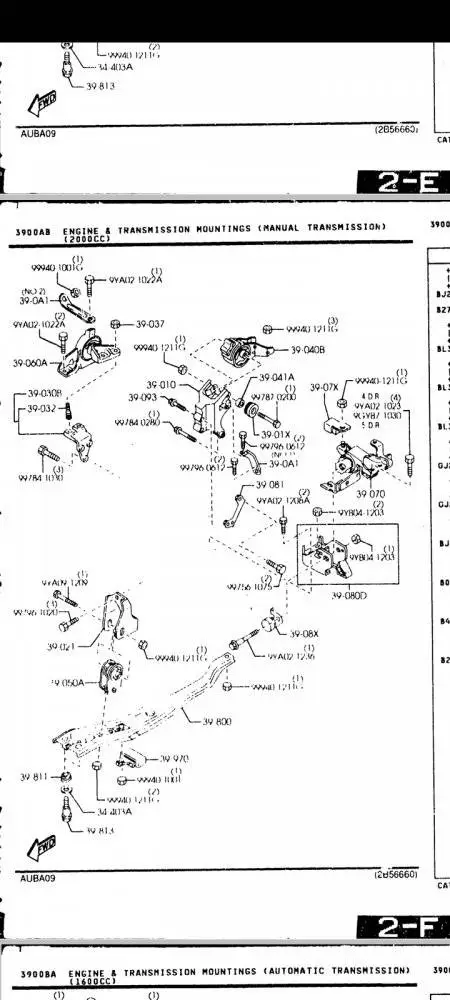

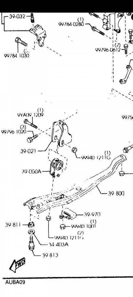

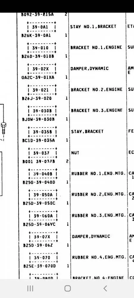

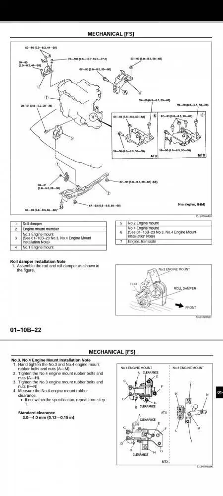

... what if a person fuckered up the bracket on the engine that holds the front motor mount AND the bolt that goes through the front motor mount ...
Found it.
The parts manual is really difficult to navigate, and the pictures are kinda blurry.
You may be able to get a bolt and bracket from a local pick and pull, if you can manage to remove it without damaging it.
