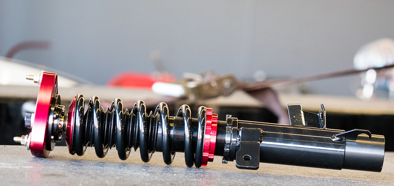

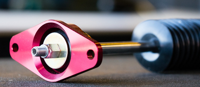

So lets get started with the beauty shots of the coilovers.
P1120172 by tuanies, on Flickr
They're so pretty
P1120170 by tuanies, on Flickr
P1120166 by tuanies, on Flickr

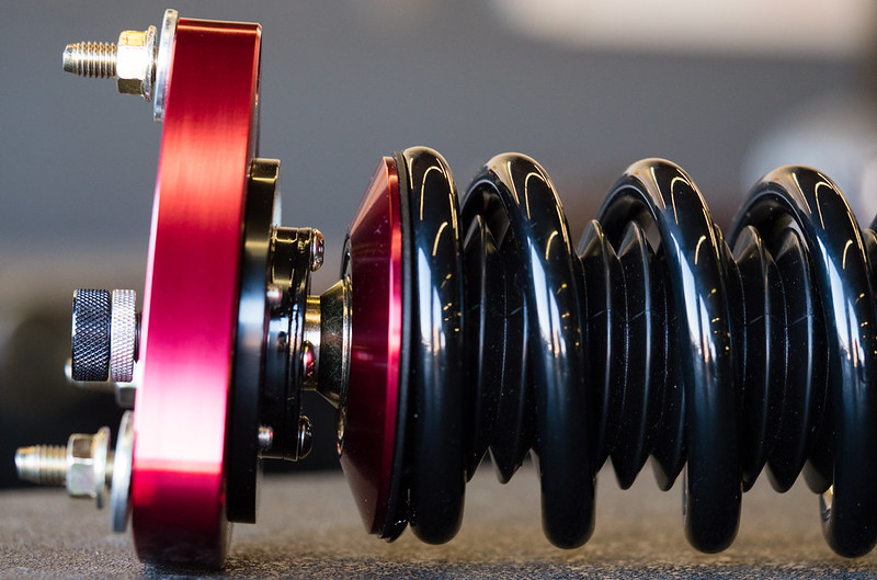

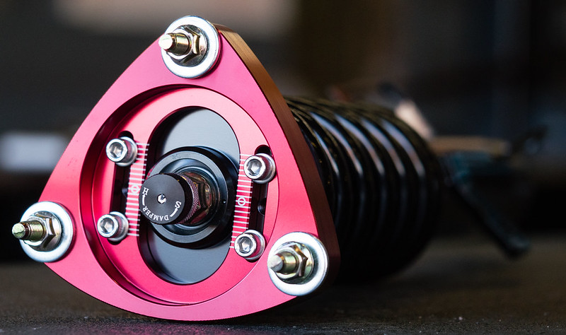

Yes it comes with camber plates, but I have no plans to stance it so its left at the default settings.
P1120162 by tuanies, on Flickr

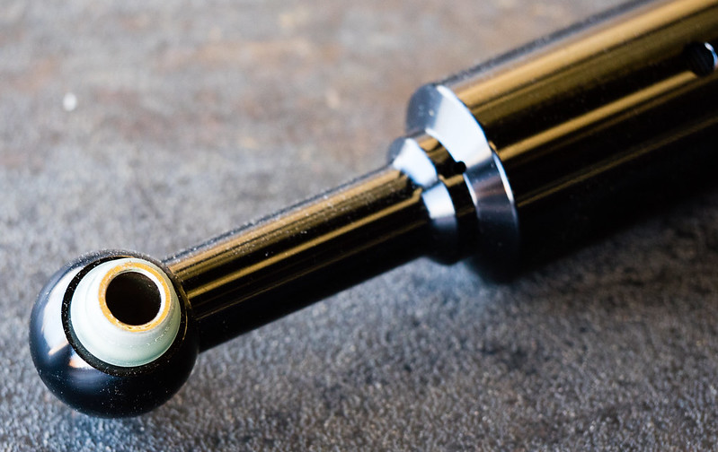

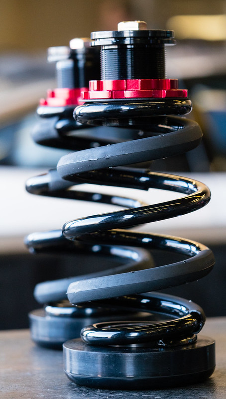

Some shots of the rear struts and springs
P1120167 by tuanies, on Flickr
P1120169 by tuanies, on Flickr
P1120176 by tuanies, on Flickr

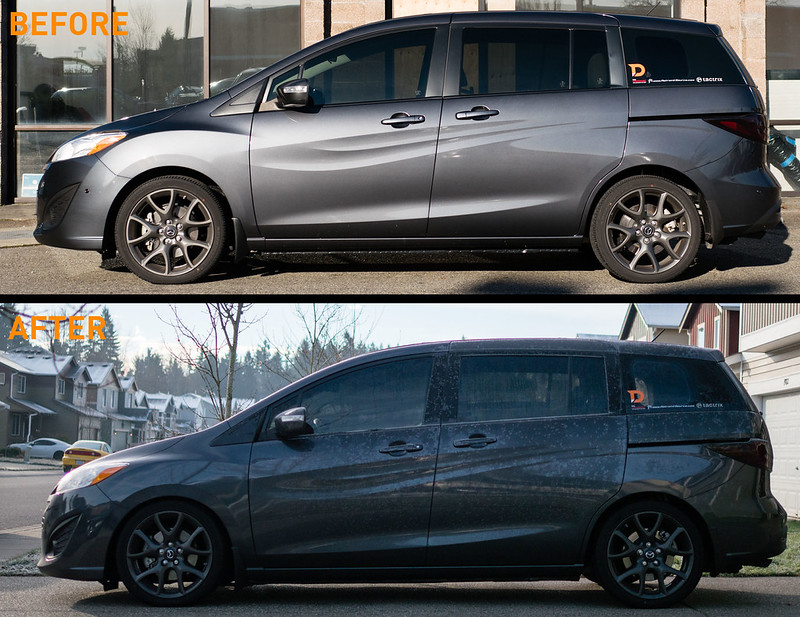

A before shot of the car

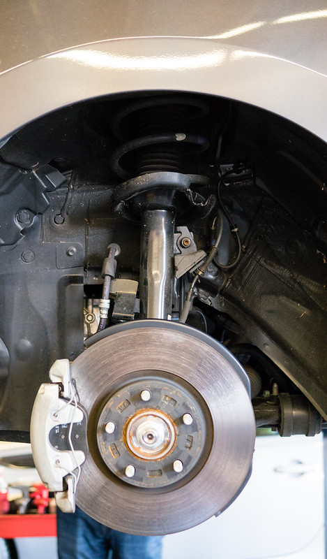

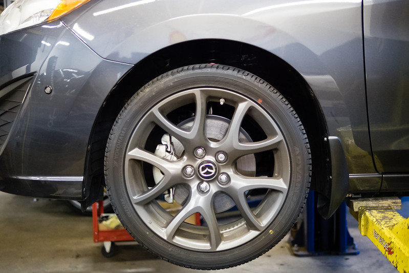

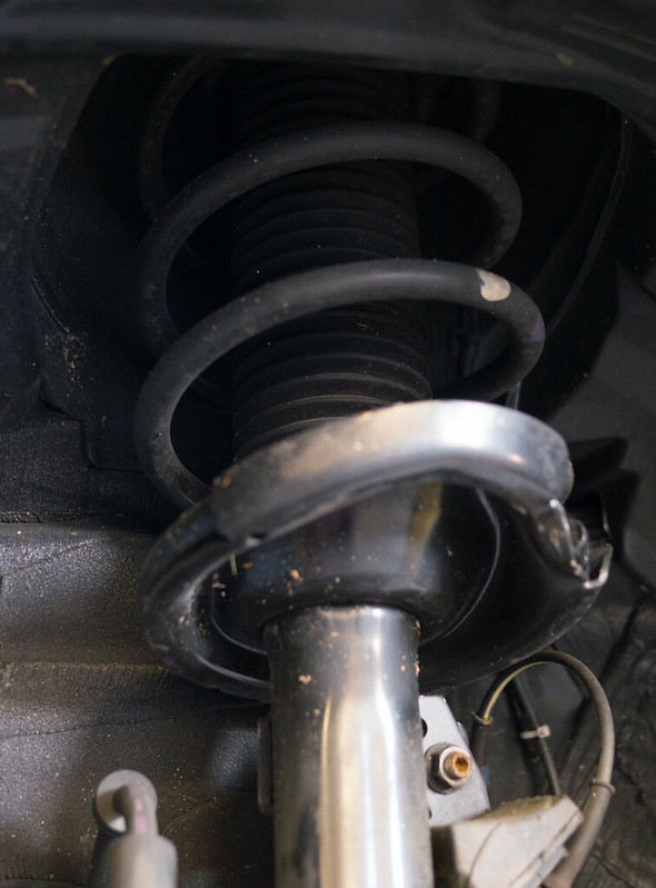

Let's start with the front. Check out how much travel there is with the stock setup.
P1120179 by tuanies, on Flickr

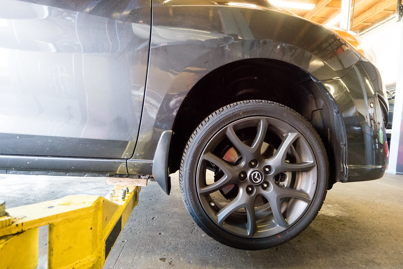

Wheels are off
P1120184 by tuanies, on Flickr
Close up of the stock strut
P1120187 by tuanies, on Flickr

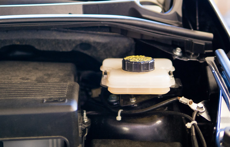

This is only applicable to manual Mazda 5's. The clutch fluid reservoir has to be removed to get access to the strut tower. I'm not sure if automatic models have anything there or not.

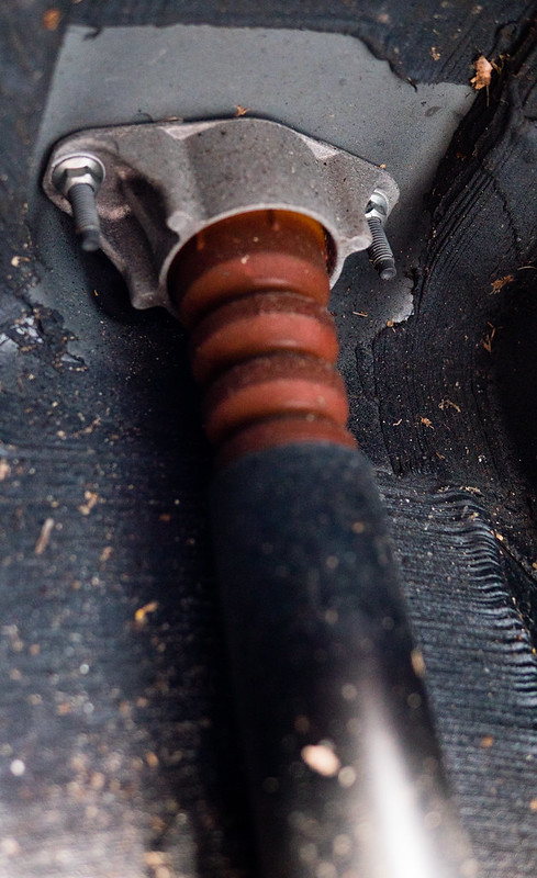

P1120189 by tuanies, on Flickr

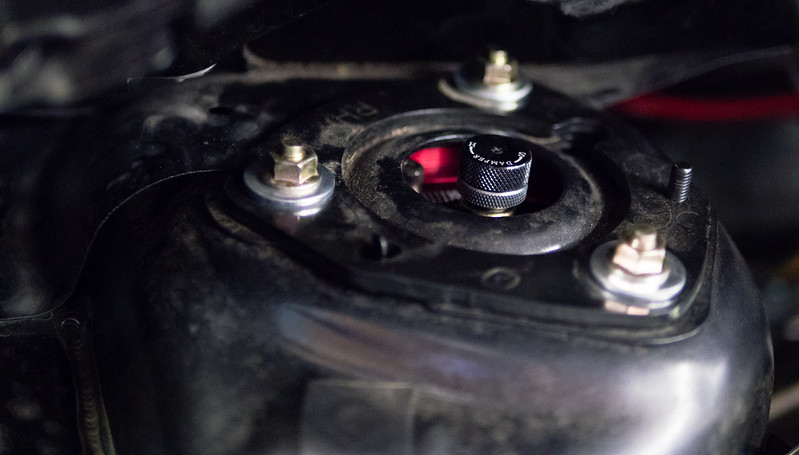

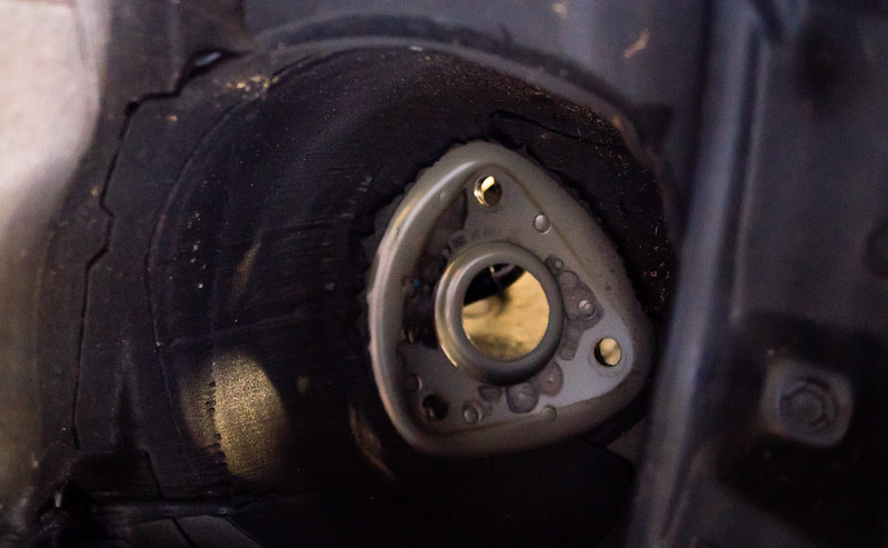

It's out! If you want access to the camber plates after installation, you'll have to enlarge the center hole of the strut tower. I opted not to do this since I have no plans of adjusting camber at all.

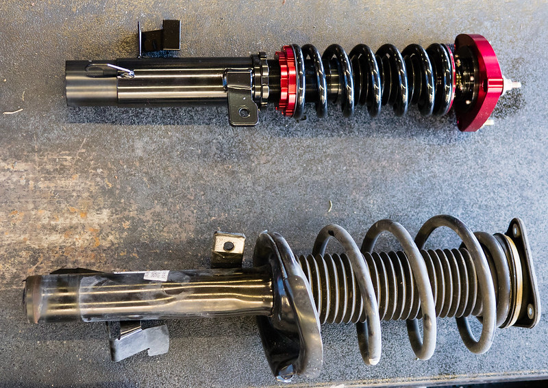

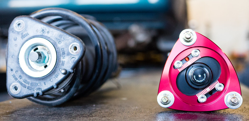

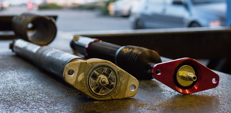

Stock strut versus the new coilover.
P1120192 by tuanies, on Flickr
P1120193 by tuanies, on Flickr

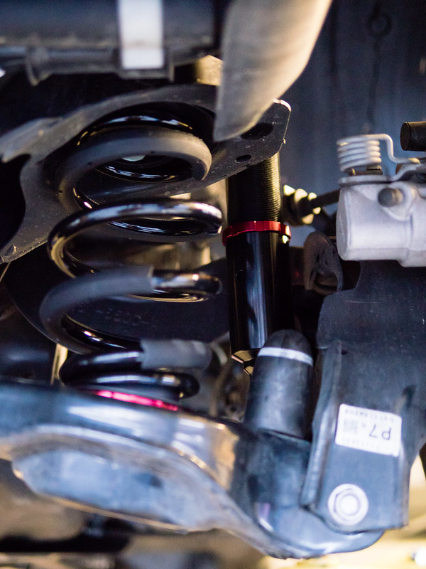

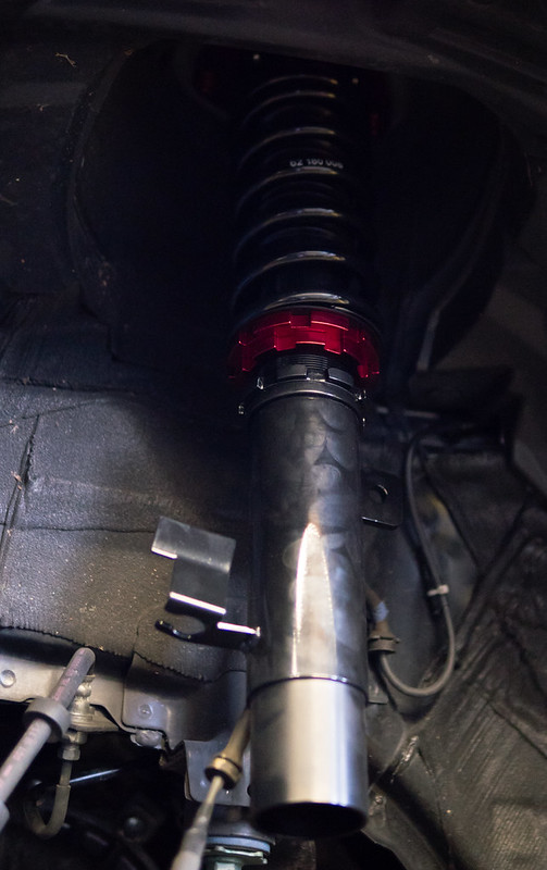

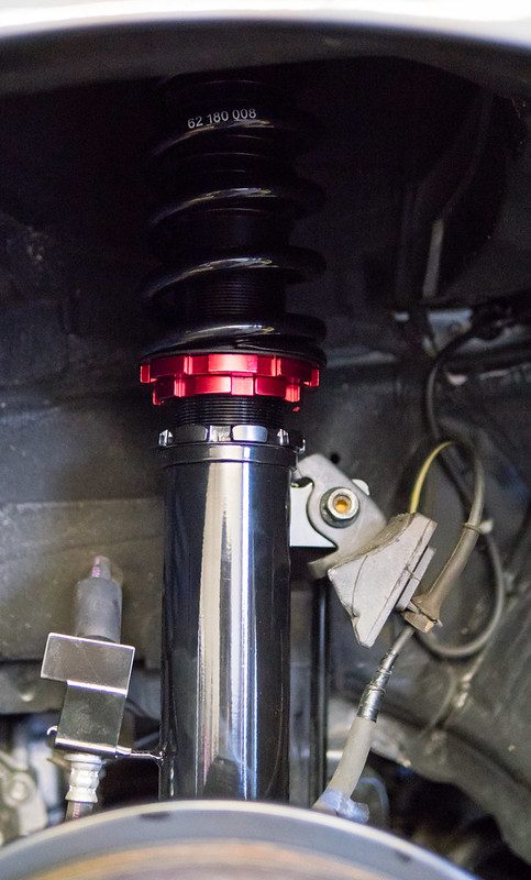

The factory brake line and ABS sensor brackets attach perfectly like stock.
P1120200 by tuanies, on Flickr
For some reason I forgot to take a shot of the coilover installed without the wheel, but here's a shot with the wheel on. The new setup doesn't have as much travel up front.
P1120219 by tuanies, on Flickr
The damper adjustment knob is easily accessible on the passenger side. The driver side is slightly annoying due to the clutch fluid reservoir but its not that big of a deal.

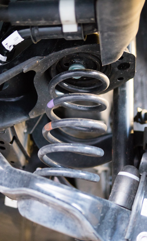

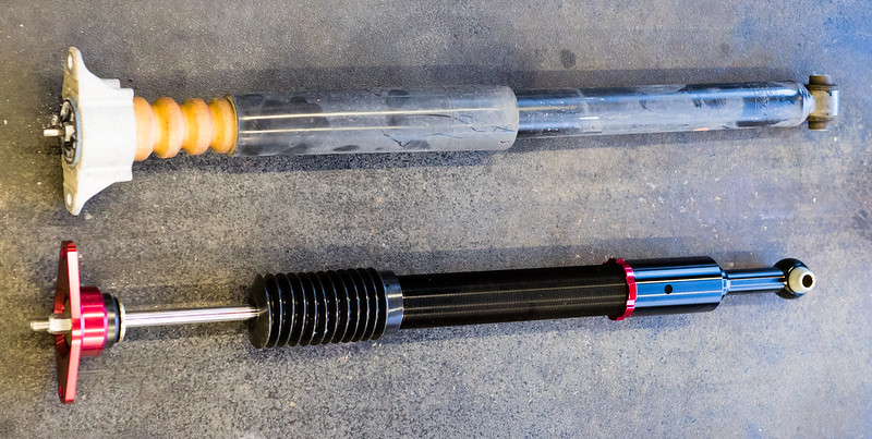

Stock spring versus new one.
P1120207 by tuanies, on Flickr
Rear struts
P1120211 by tuanies, on Flickr
Stock versus coilover
P1120210 by tuanies, on Flickr

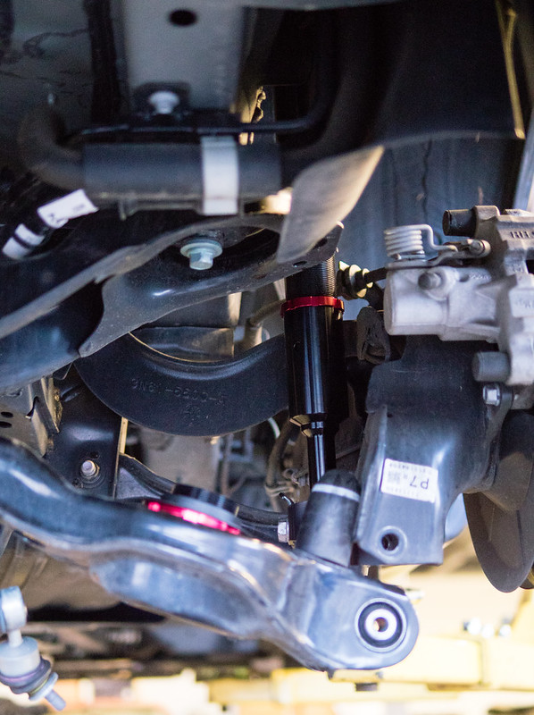

Strut installed
P1120218 by tuanies, on Flickr
New perch in place. We left the default settings but will have to go back and adjust it to get the rear a little lower.
P1120214 by tuanies, on Flickr
Spring in place.
P1120217 by tuanies, on Flickr

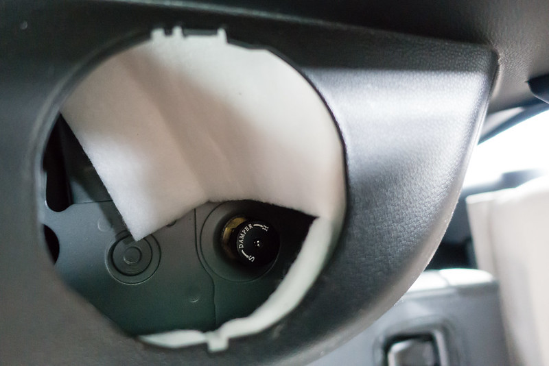

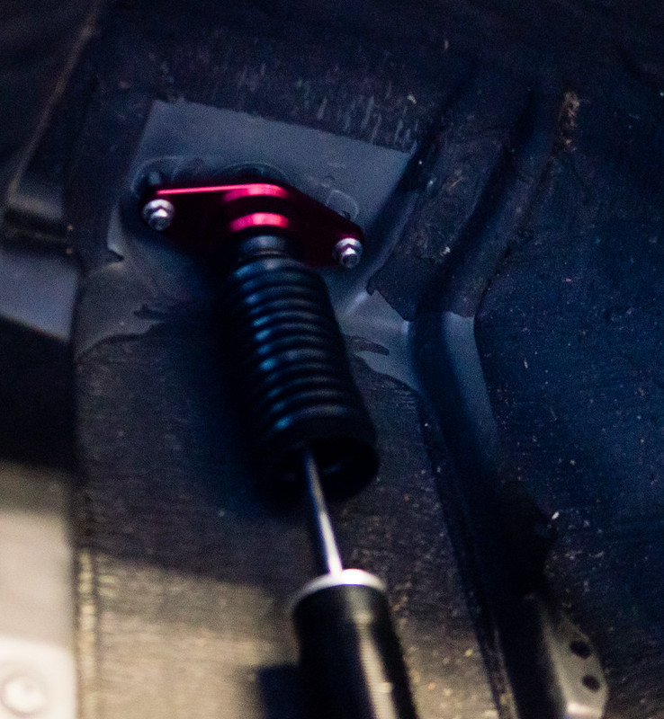

The nice thing about the 5 is there are cup holders where the rear struts mount up to. All I need to do to adjust stiffness is to pop the third row cup holder off and turn the knob.

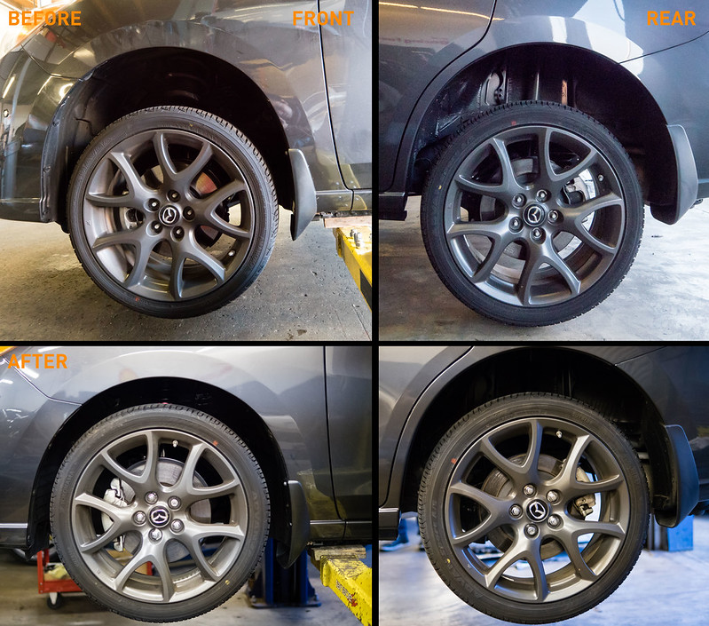

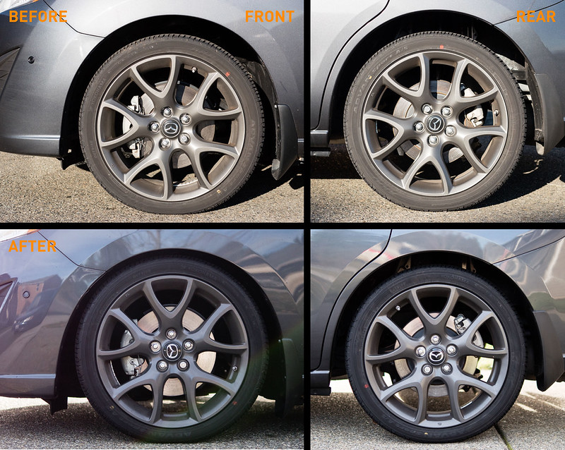

We bottomed out the front and rear struts on the car to get the car at that ride height. The front is perfect where it is for me. We need to adjust the rear spring perch to get the back end just a little lower to reduce the wheel gap.

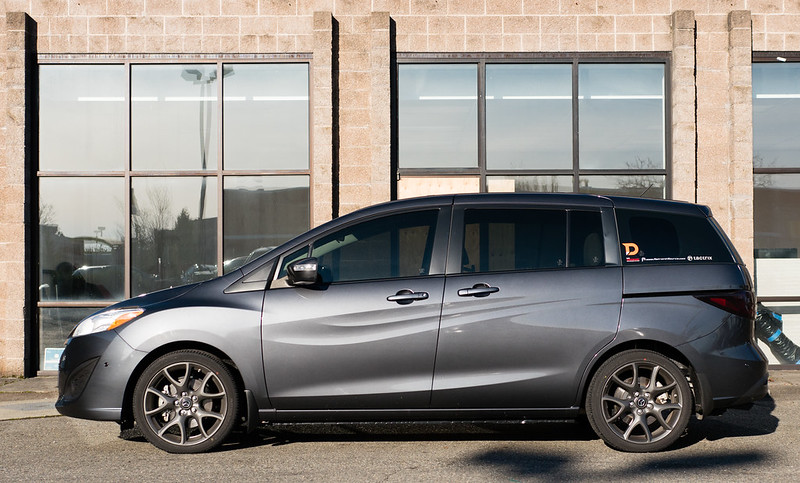

Comparison shots.
Side-comparison by tuanies, on Flickr
suspension-travel-comparison by tuanies, on Flickr
fender-gap-comparison by tuanies, on Flickr
My impressions of the Megan Racing Street series coilovers for the 2nd gen Mazda 5 are good. At the softest settings, I'd say the ride is a little more comfortable than stock. I'm still playing with the stiffness adjustments and currently have them set to 16 clicks up front and 8 clicks in the back. There's 32 clicks of adjustment The handling improvements are very noticeable when you try to push the car. it doesn't feel as top heavy anymore and feels pretty close to the current third gen Mazda 3, in terms of handling. Combined with my GenPu MS3 wheels wrapped in Yokohoma Advan Sport A/S rubber, I'm very happy with the driving dynamics and ride quality. The 16 clicks is a little bit stiff so I'll probably turn that down a bit, but otherwise I'm happy. I still need to get it in for an alignment next week though.
P1120172 by tuanies, on FlickrThey're so pretty
P1120166 by tuanies, on FlickrYes it comes with camber plates, but I have no plans to stance it so its left at the default settings.
P1120162 by tuanies, on FlickrSome shots of the rear struts and springs

P1120154 by tuanies, on FlickrLet's start with the front. Check out how much travel there is with the stock setup.
P1120179 by tuanies, on FlickrWheels are off
P1120184 by tuanies, on FlickrClose up of the stock strut
P1120187 by tuanies, on FlickrThis is only applicable to manual Mazda 5's. The clutch fluid reservoir has to be removed to get access to the strut tower. I'm not sure if automatic models have anything there or not.
P1120189 by tuanies, on FlickrIt's out! If you want access to the camber plates after installation, you'll have to enlarge the center hole of the strut tower. I opted not to do this since I have no plans of adjusting camber at all.
P1120194 by tuanies, on FlickrStock strut versus the new coilover.
P1120193 by tuanies, on FlickrLet's get the coilover in place.

P1120188 by tuanies, on FlickrStock spring versus new one.
P1120207 by tuanies, on FlickrRear struts
P1120211 by tuanies, on FlickrStock versus coilover

P1120217 by tuanies, on FlickrThe nice thing about the 5 is there are cup holders where the rear struts mount up to. All I need to do to adjust stiffness is to pop the third row cup holder off and turn the knob.

P1120220 by tuanies, on FlickrWe bottomed out the front and rear struts on the car to get the car at that ride height. The front is perfect where it is for me. We need to adjust the rear spring perch to get the back end just a little lower to reduce the wheel gap.
Comparison shots.
fender-gap-comparison by tuanies, on FlickrMy impressions of the Megan Racing Street series coilovers for the 2nd gen Mazda 5 are good. At the softest settings, I'd say the ride is a little more comfortable than stock. I'm still playing with the stiffness adjustments and currently have them set to 16 clicks up front and 8 clicks in the back. There's 32 clicks of adjustment The handling improvements are very noticeable when you try to push the car. it doesn't feel as top heavy anymore and feels pretty close to the current third gen Mazda 3, in terms of handling. Combined with my GenPu MS3 wheels wrapped in Yokohoma Advan Sport A/S rubber, I'm very happy with the driving dynamics and ride quality. The 16 clicks is a little bit stiff so I'll probably turn that down a bit, but otherwise I'm happy. I still need to get it in for an alignment next week though.
