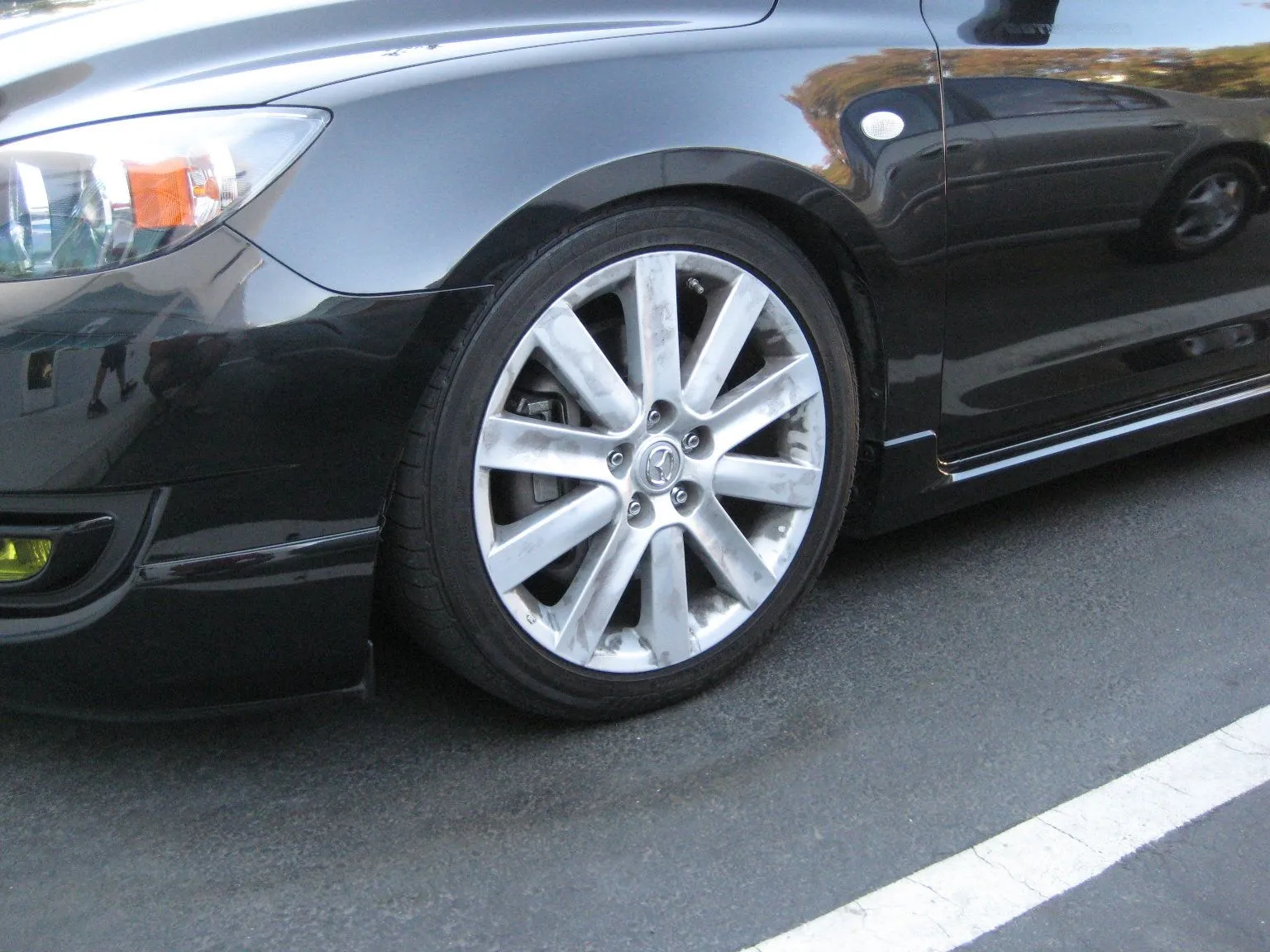

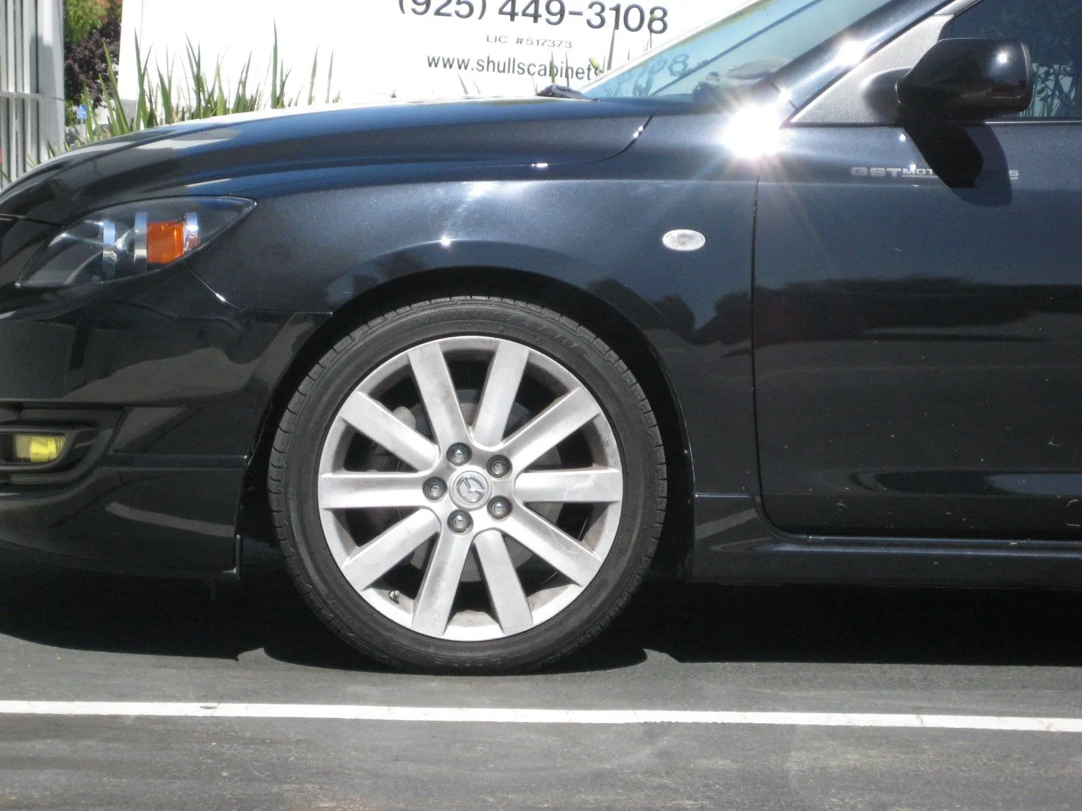

i got my bc coilover installed....didnt really drive it yet....still waiting to have my top hat cut plus alignment/corner weight....

how low can the bc drop the car... im looking to get rid of my cobbs and possibly go with coilovers but i really am looking for like 1 finger - 1 and a half, front and rear on the 225/40/18s
any one have pictures with that setup

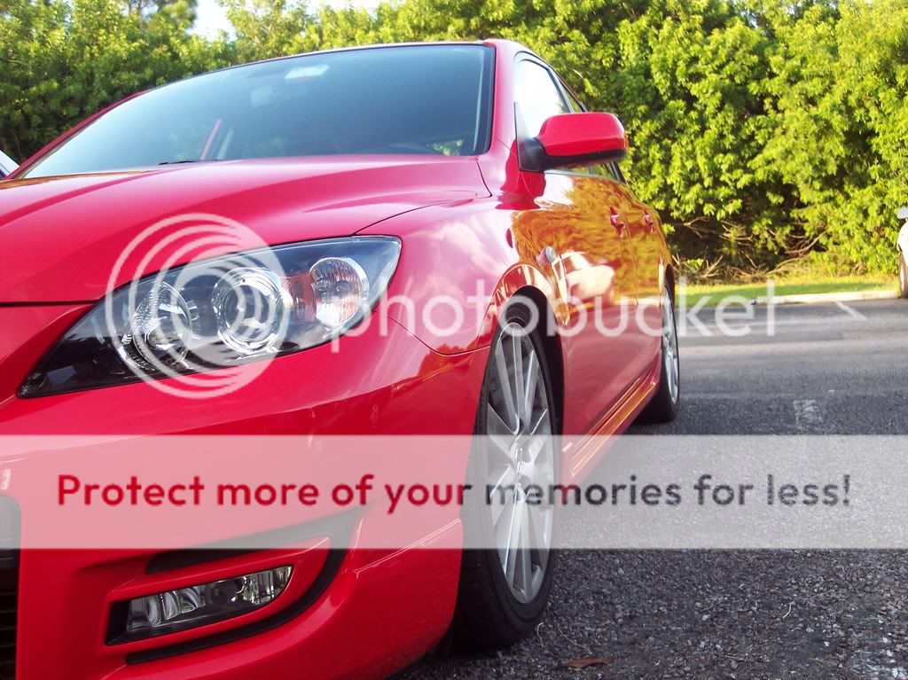

I have BC's and this is low as itll sit without scraping all the time. (sorry for the blurry pics, only ones i have with it this low) Its the red speed3 tucking the tires way up there. Great product all the way around
I dont have it sitting this low anymore
