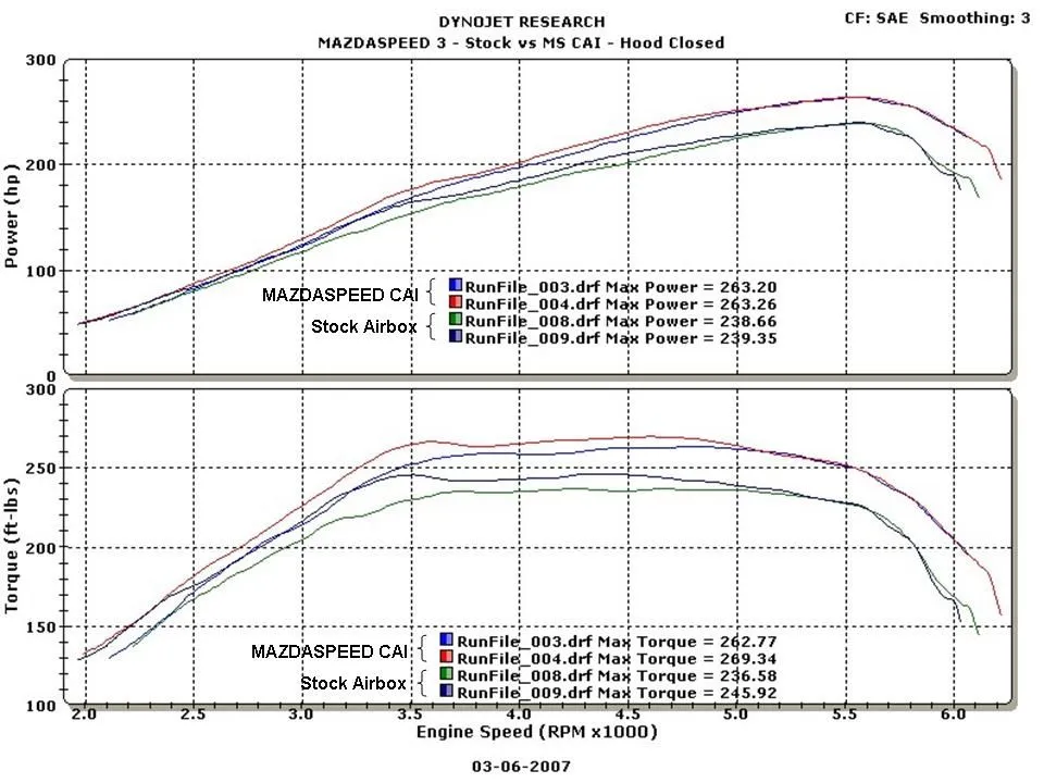

MAZDASPEED 3 Stock vs MAZDASPEED Cold Air Intake - 3rd Gear
MAZDASPEED CAI Cost $325.00
Dynojet Research Dynos were run on 2 different days. Dyno with MAZDASPEED CAI was run on 3-5-07 and Dyno with stock airbox was run on 3-6-07. Yes, I had to take off the MS CAI and re-install the stock hardware! Actually, I'm still stuck with the stock HW cause I don't have time to change it.
Dynojet Research Dyno on MAZDASPEED 3 in Stock Configuration
  • Ambient Temp=64 deg. F
  • Atmospheric Pressure=29.80 in-Hg
  • Humidity=50%
  • Correction Factor=SAE 0.98
  • 2 Large Cooling Fans placed 5 ft. from front of car
  • Hood Closed
  • Runs in 3rd gear only
  • Runs started at about 2k RPM and stopped at about 6250 RPM.
Dynojet Research Dyno on MAZDASPEED 3 with MAZDASPEED CAI
  • Ambient Temp=63 deg. F
  • Atmospheric Pressure=29.90 in-Hg
  • Humidity=53%
  • Correction Factor=SAE 0.97
  • Hood Closed
Results:
  • 10.14% HP (24.2 HP)
  • 10.28% Torque (24.8 ft-lbs)
