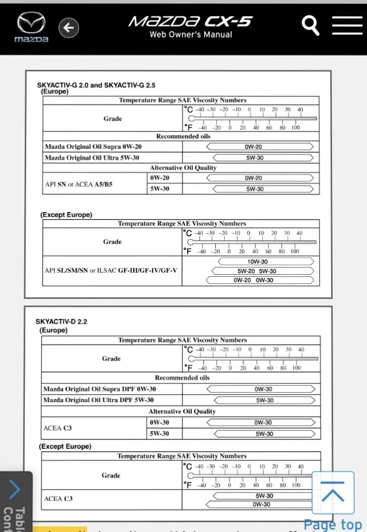

It must be noted that like all Eu compliant diesel cars, these Mazda diesels have very exacting requirements for the engine oils to be used, which must meet JASO DL-1 or ACEA C-1 standards, and they are full synthetic, low sulphur, mid SAPS, and are relatively expensive.
If they are not used, and if they are not changed at the recommended service intervals, be that by distance or time, the engine will almost certainly suffer DPF failures as well as excessive clogging in the intake shutter valve.

C1 or C3 oil in CX5 diesels depends on the MY. Until KF series, C1 or JASO DL1 was the recommended oil. Since KF, C3 is recommended. At least here in Aus that is the fact.

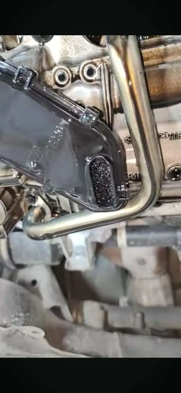

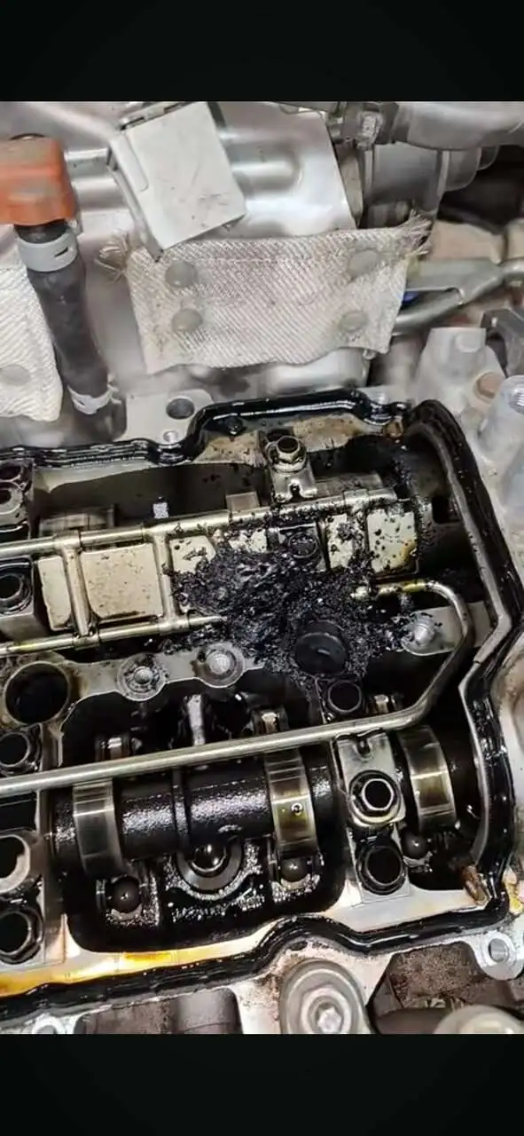

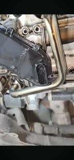

Seems you can't trust what the dealers are saying. These motors did have injector seal failures as made of the wrong material. Ask them to check the injectors for "blowby" and oil pick-up stainer in the sump. Should be a simple check. My mazda6 had the fault, mazda spent over $10k to rebuild the engine and gave me a hire car for 9 weeks. The car was 6years and 120,000km outside warranty
