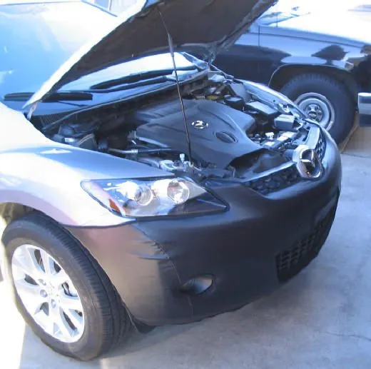

MazdaCX 7 mask installation.
Alpha Wolf
Mazda, CX7, Touring Model, Liquid Platinum

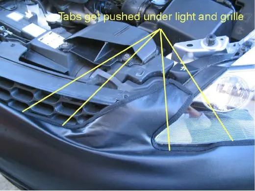

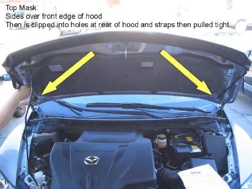

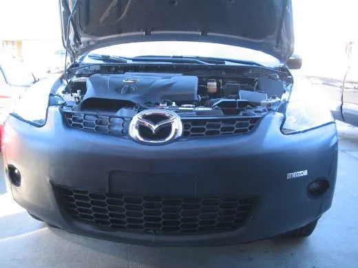

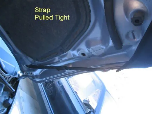

Pretty easy.
Clean the front of car first.
You will need to pull out one strand of thread to remove covering for fog lights (I did that) and also for front license plate (I did not do this).

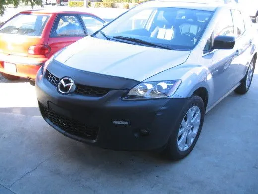

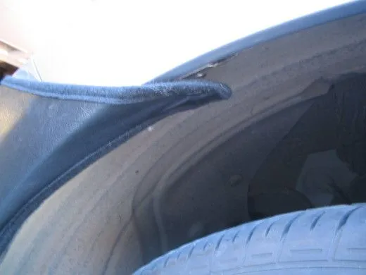

A Few More Pictures..
just make sure you take it off and clean under it veeery often. Those things tend to destroy the paint much faster than rock chips ever would sadly.
Thanks for the install info though!
Yep..
I have used this type on my bugs, trans am etc...
Already had to take it off and clean it as the wifey took it out for a drive in the rain without taking it off first.
Never had a problem with them ever messing up the paint as long as you take it off and clean it when you wash your car and when it gets wet.
Way better than having the front and hood chipped away the first time you get stuck behind a truck or a car on a road with chip seal or pea gravel

Not sure what you are stating. The mask is black as are most of this type.
Hence its name....
Comes off in seconds unlike paint chips all over the front of your car.
