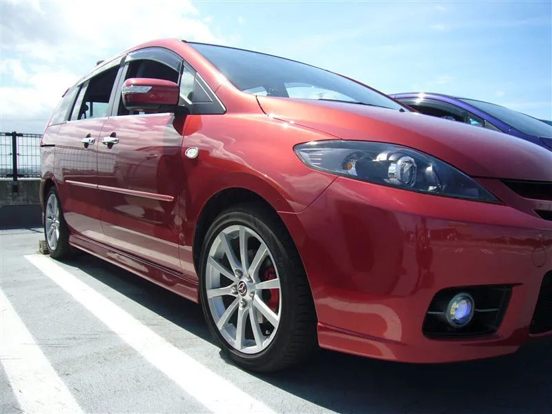

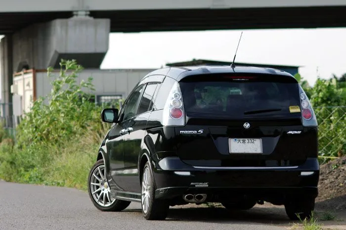

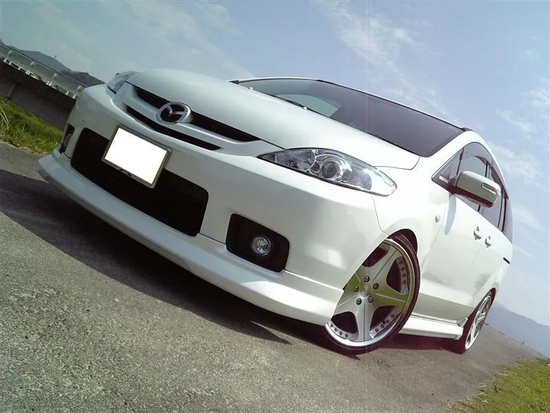

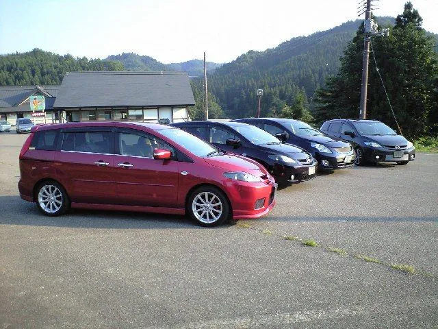

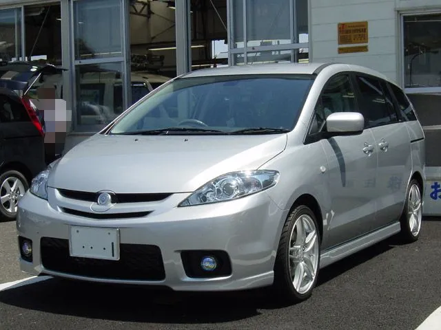

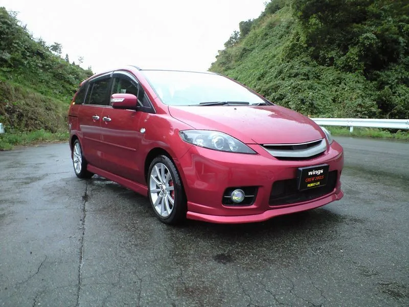

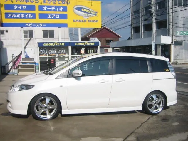

Found some sick mz5's off a japan site... enjoy.....
i like the dual outlet muffler on the black one. and the rx-8 wheels on the green one look great.

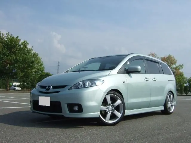

Hi everybody just want to ask what is the spec of the RX8 wheels that is can be used on a 07 Mazda 5.
Thanks and more power to mazda forum

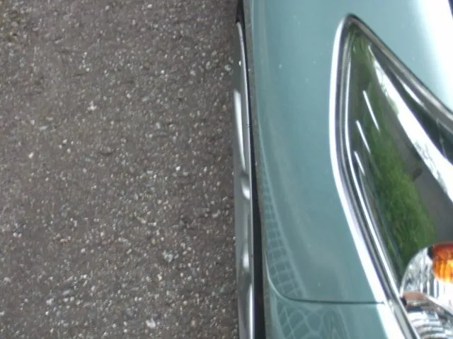

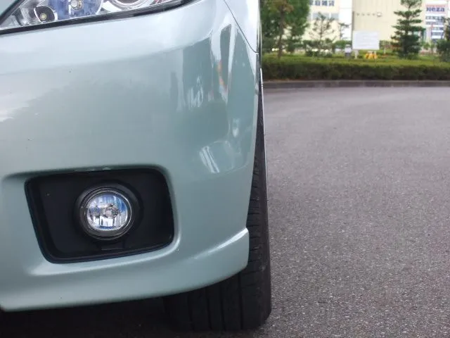

18" RX-8 are 18x8 with a 50mm offset... they will stick out in the front just a bit... if you plan to go with them.. you could use a 3mm spacer for the rear to bring it flush with the fender...
I was also thinking of the RX-8 18"s. Sorry for belaboring the point, but... mounting as they are will result in the fronts sticking out a bit as in your photos and the rears set into the wheel well by 3mm? This wouldn't be too noticiable without the spacers right? Any other pics?

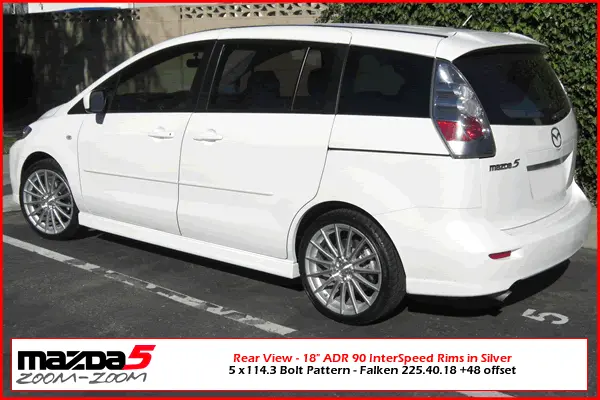

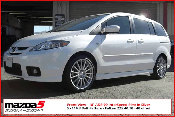

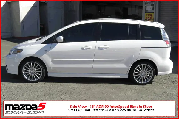

January's Improvements:
- ADR 18" Interspeeds
- Fujita Intake
- Mazda5 Door Sills
February's Improvements
- H&R Springs
- MazdaSpeed3 Rear Camber Adjustment Plate
- ICW SwayBar Kit (front and back)
- White Eyelids
March's Improvements
- Tower Bar
- Drilled & Slotted Rotors
- Exhaust
I'll post more pics @ the end of March :-)
Should be more to see then.......
