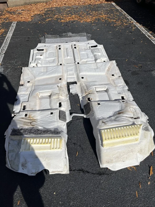

Mazda5 sound deadening complete
Sorry, can't remember. Probably 1 pound though, because I was able to get it behind the door cards pretty easily.
Thanks! I was figuring/hoping just 1 lb should be effective after deadening and closed cell foam on the floors. Wheel arches next!
