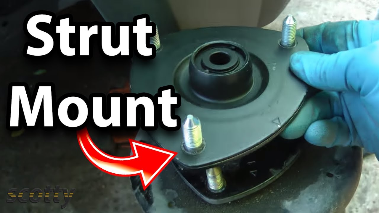

Ok I was not aware of the strut top bearings, aren’t they part of the whole strut mount assembly?
Thank you.
The strut mount is generally a replaceable part from the assembly:
(Around 1min36sec in)
