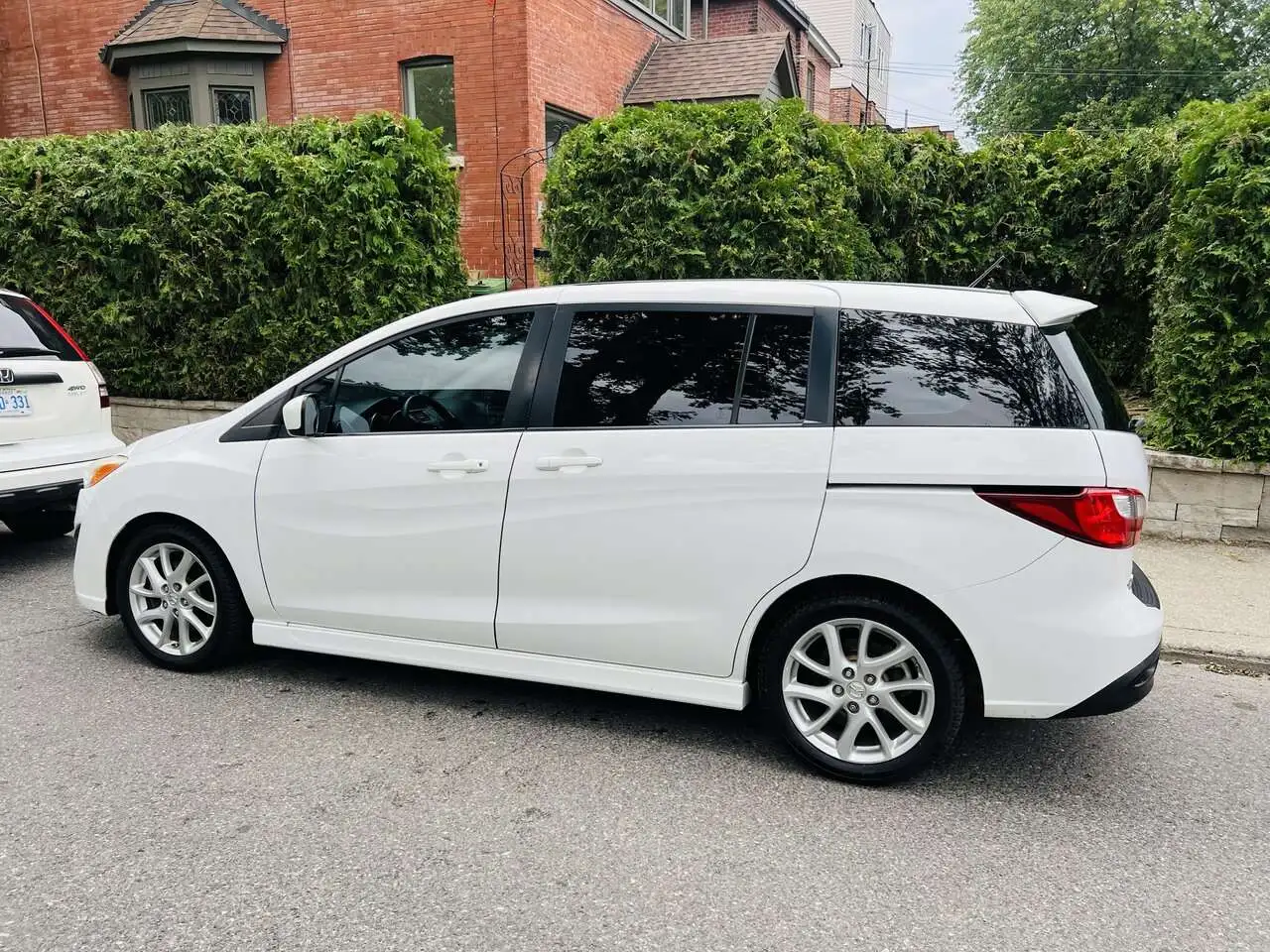

The car is 13 years old and has 230,000 k’s on it. It’s in excellent condition and I plan on keeping it a long time. For the sake of a 15 min. fluid change, and C$75, it makes sense to change it. Esp. when you consider the iffy 2nd gear synchro issues prevalent in these transmissions.
