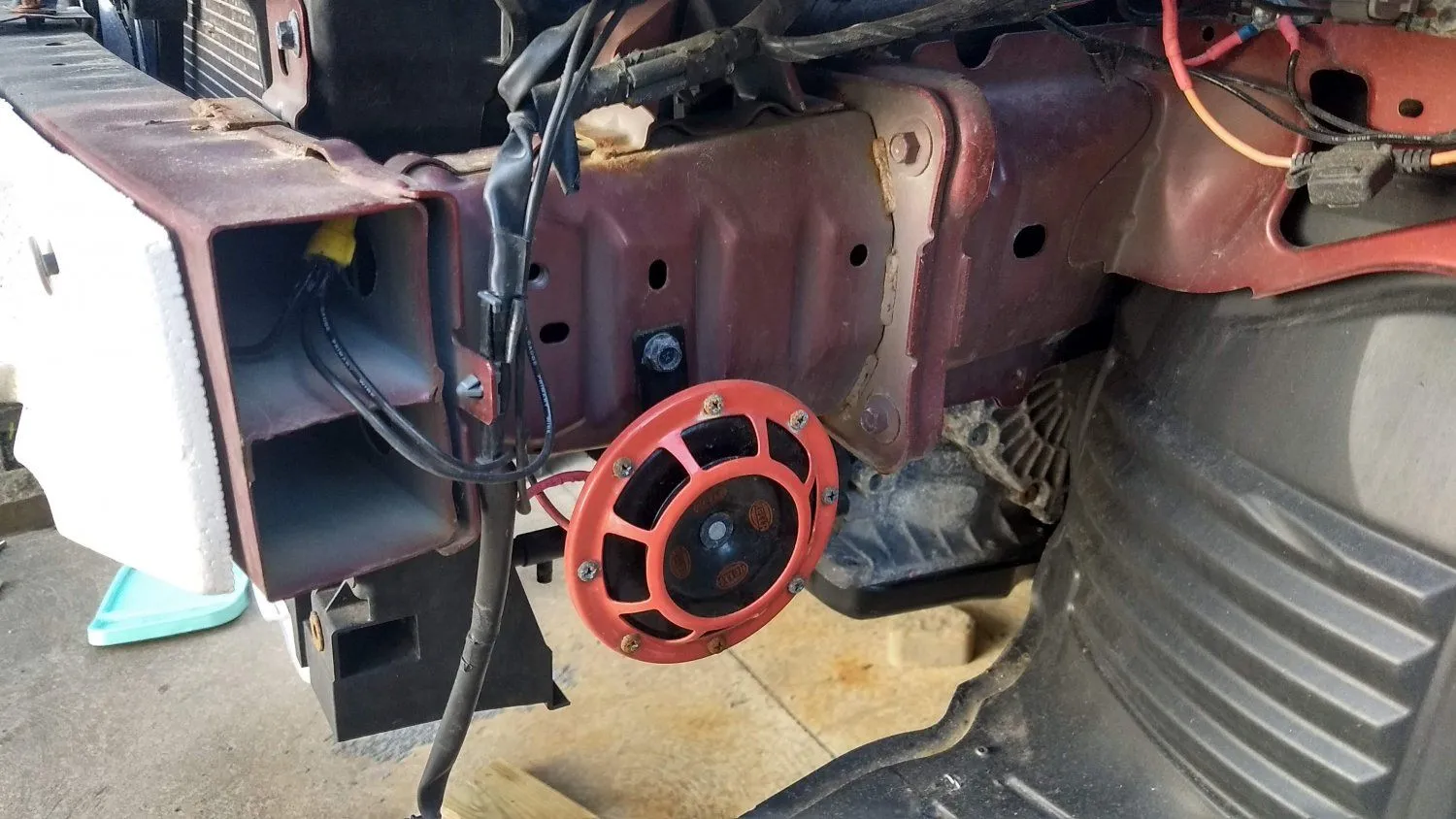

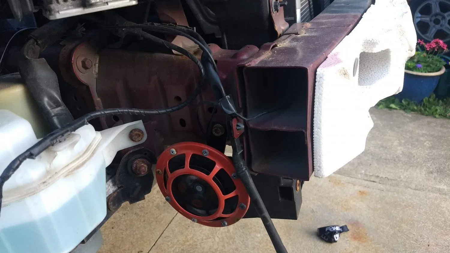

The stock horns on the Mazda 5 are dangerously weak. I recommend replacing them for your safety. I am using the Hella Supertones on my '12 and they have worked great for 3 years now. Much safer on the highway now. They have a japanese sound to them and are VERY loud. More of a "meep, meep", not a "honk".
Just be sure to crimp or solder all your connections and also use shrink tubing to seal them. My grounds were going bad after the first year, so I went back and cleaned the salt corrosion off them and put di-electric grease on them to keep the corrosion at bay. Much better now.

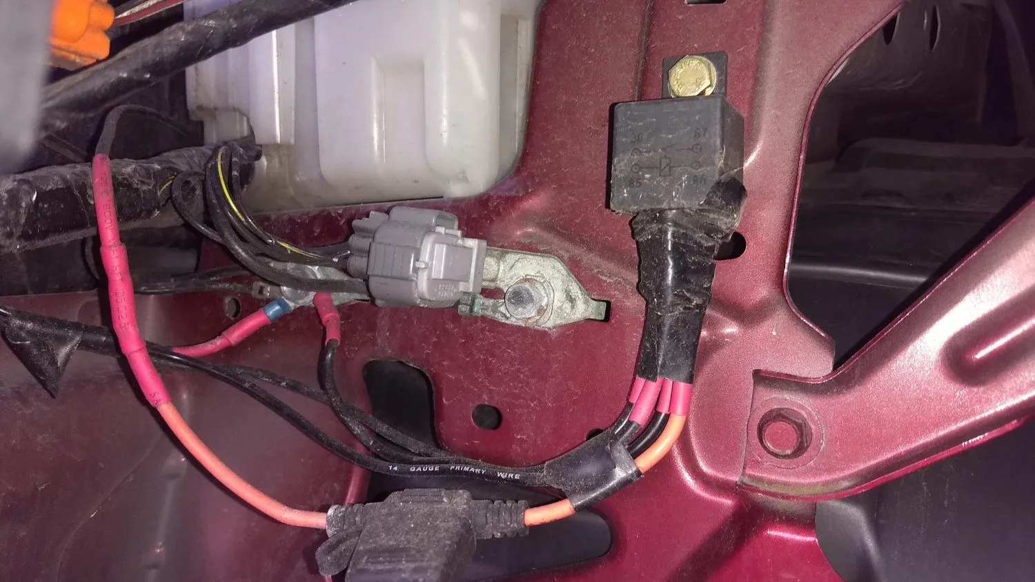

Basically, I just took the signal going to the old horns and ran it to a new relay to isolate the circuit. I ran a "+" lead from the fuse box by the battery and put an inline fuse on it to keep it legit. I had to fabricate some small brackets for the horns out of scrap I had and mounted them on the left and right frame rails aft of the crash bar behind the bumper. The wire runs thru the crash bar to the passenger side and powers the other horn. Then the circuit is grounded to the frame rail factory ground by the water pump.
I mounted the relay and grounded it to the frame just under the fuse box under the hood.
If you are not familiar with how relays work or are not comfortable with wiring, then find a mechanic that can do it for you.

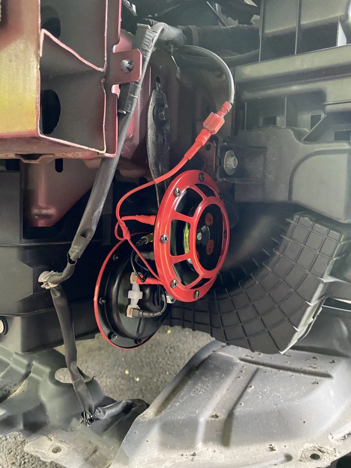

Part of the issue is for some reason Mazda decided to only install high tone horns in many of their cars in the US market. Just adding a low tone makes it sound like a normal horn. Super tones are definitely nice. Incidentally they work just fine without the relay, and a splitter going from the factory wiring. There’s already a relay in the box for the horn. If I were talking about installing a much larger horn, or trumpets then I’d definitely use a relay.
I recently installed a set in my sister’s ‘08 to replace a mini air horn which crapped out. Used the Factory bracket with one extension from the horn box attached at the nut of the top horn.

I installed a set of Hella Trumpet horns without relay. It's been working fine for a few years now without any issues. I prefer the Trumpet sound over the Supertones...Less meep and more honk.:)

Absolutely. I’ve installed paired horns on several cars without adding A relay. There’s already a horn relay in the fuse box.
After trying the Supertones, I can agree with this. No extra relay necessary.
After 4 years, the Supertones were rusted and didn't work anymore. I replaced them with the basic Amazon snail style horns and it is great. Super loud. I do like the tone better too. Bonus is that these won't rust out like the ST ones.
