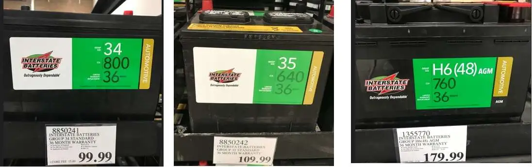

The Interstate (4yr, 6mo old) only has 36 mo. exchange :(
The previous Kirkland (JCI) was so much better.
Put in a new 34 (b/c I was stoopid and this time it died on me while driving).
Still can't beat Costco prices.
Left car parked for 2 day + 2 day deep freeze depleted the battery to 8.56V... Had to make a nuisance trip to Costco to swap for another 34. I miss the original JCI batteries 😭
