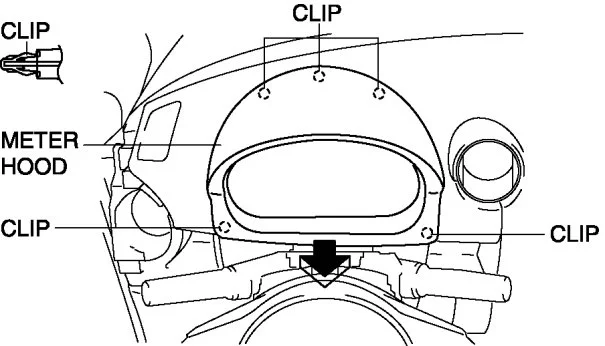

3. Remove the meter hood. Pull the meter hood in the direction of the arrow shown in the figure and remove it while detaching the clips.

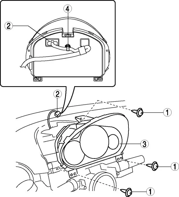

4. Remove in the order indicated in the image.
5. Install in the reverse order of removal.
