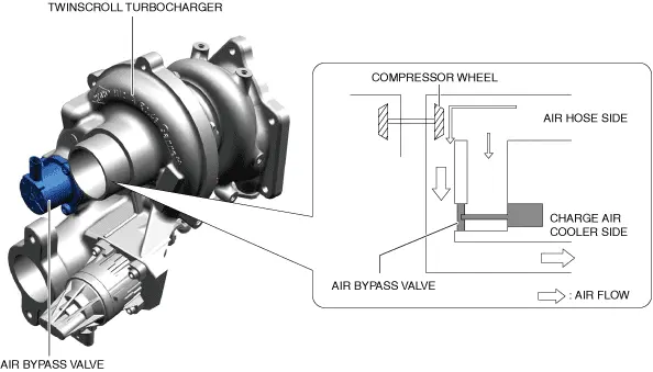

So to clear up the confusion, the turbo in every Mazda 2.5T is a Dynamic Pressure Turbo, aside from the CX-50. On the CX-50, the turbo is a twin-scroll design. If you use the Mazda Build and Price tool, you'll see that only the CX-50's Turbo is described as a Twin-scroll Turbo, everything else is a DPT.
Why they made the change, I don't know.
Now THAT's really interesting. Since that's the newest model I assume all the future 2.5T engines will come like that. Maybe a cost reduction factor again (or reliability, or??)
I assume this is the marketing department getting it wrong, but it would be interesting if they would have changed the design.

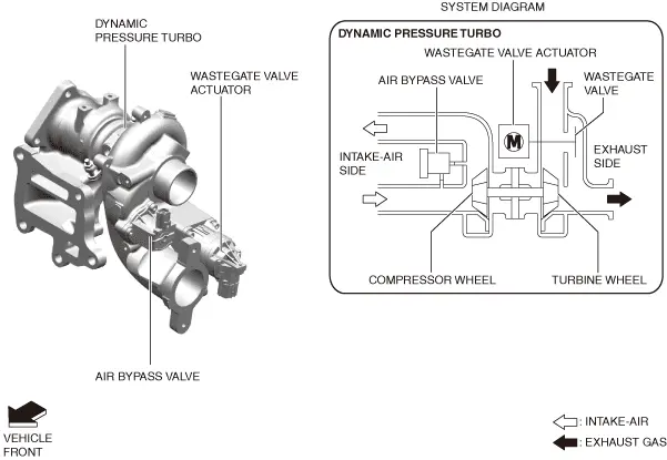

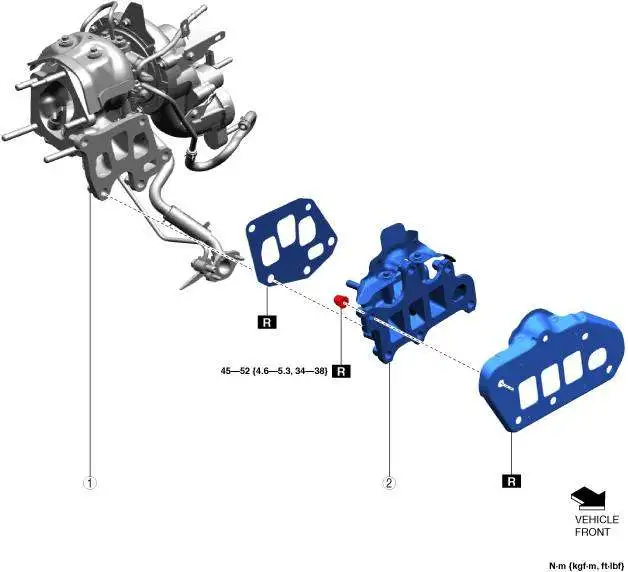

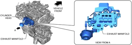

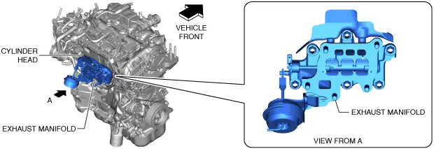

Mazda uses a new turbo for the CX-50 that is a twin scroll that no longer uses the dynamic pressure system.
Interesting, i see it still has the 4-3 exhaust scavenging set-up. It would be interesting to see how it feeds into the turbo. Also quite surprised the power delivery would be identical with the old and new set-up. I am surprised no one mentioned any differences yet.
I think those diagrams are of the dynamic pressure system, not twin scroll.
Ahh, OK, I stand corrected. Like youri I was confused by the 3 outlet manifold. Then I guess cyls 2 & 3 are merged upstream, and 1 & 2 merged in the turbo housing.
