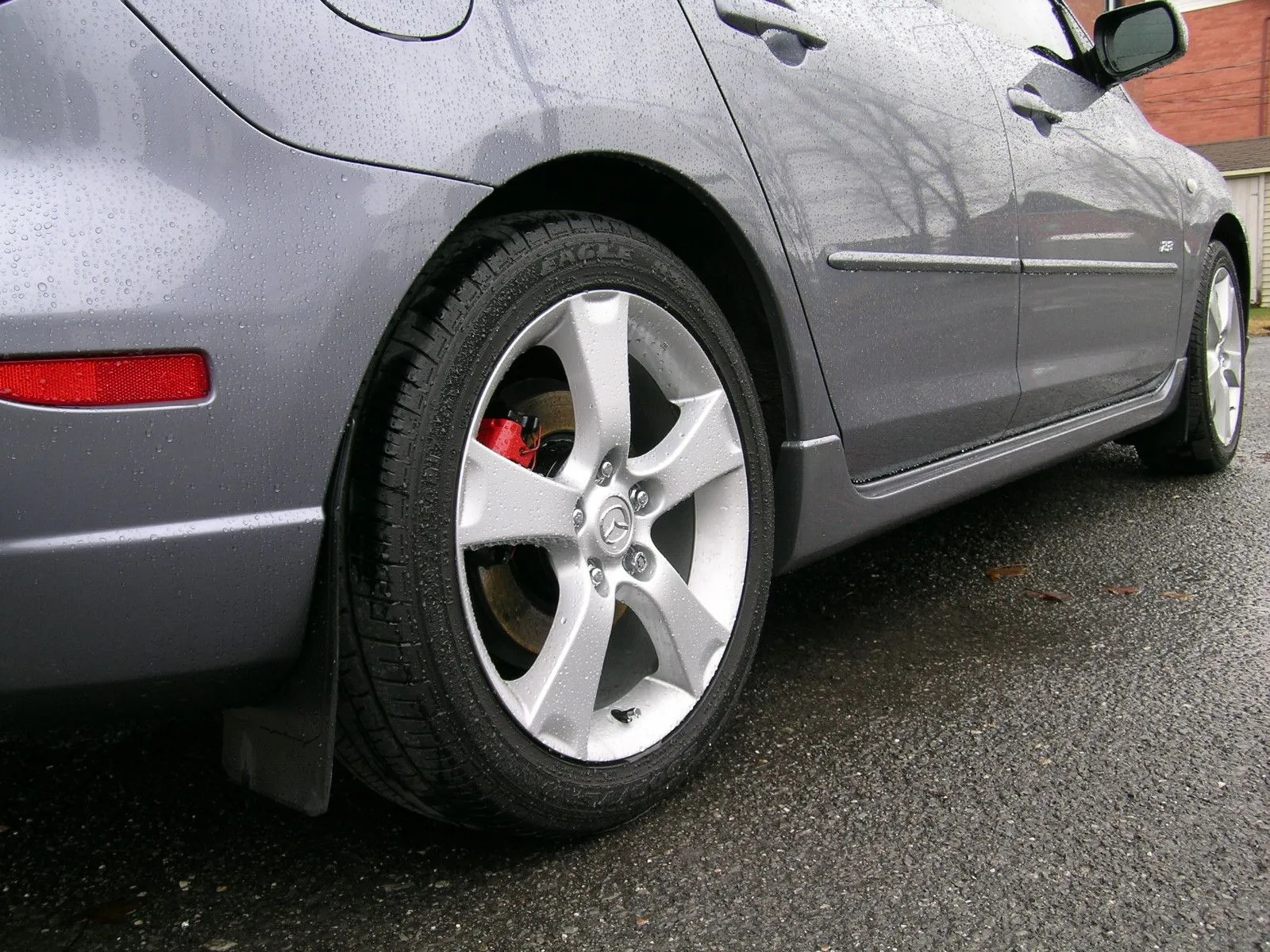

I beleive there are no splashguards from MAZDA for the 5 doors. :confused:
But, to protect my body sides, I bought splash guards from Canadian Tire, at something like $10can a pair.
Does the job well, no complaints. And look isn't too bad either.
Have a look.

Oh i went to CR before and saw those guards, but by what means do u put them on? I mean there isnt any hook ups on the car..
Just used two srews per mud flaps, which are provided with the mud flap kit.
I fixed them through the plastic body side extensions. I aligned the screws so that they did not came in contact with sheet metal.
Yes, you this will make holes in your plastic body sides.
Yes, it is a solid installation. I went through a whole winter with this setup, and no problems at all.
Little advice, make sure the car is on a levelled surface when installing the flaps.
I used a measuring tape and a level to ensure a symetric installation, and to ensure the flaps are parallel to the pavement.
