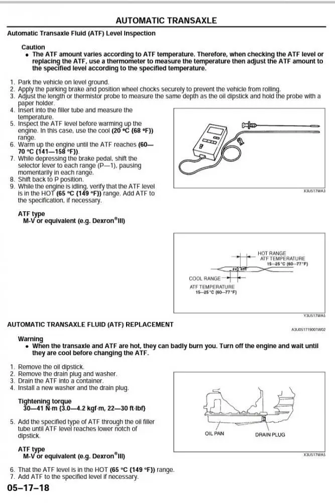

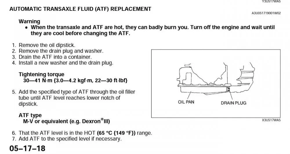

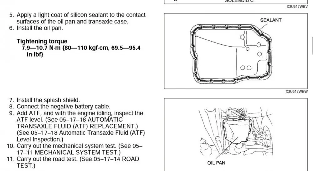

  1. What are the torque spec for the Transmission pan bolts & drain plug?
  2. When measuring old ATF and restoring to that level, am I looking to fill the ATF to the top of the cold dipstick line?
  3. After filling up with ATF, taking a test drive, and checking the dipstick, is the ATF suppose to read inbetween the low/top lines of the hot end (60c) of the dipstick?
This is the information for the 2002 Mazda Protege and Protege5. (I own a Protege5)
I assume that your transmission is the same ?
I don't think that the digital thermometer and probe is necessary, but the big thing is to make sure your engine is idling when you check your dipstick.
Doing a simple oil level check cold and hot is probably sufficient.

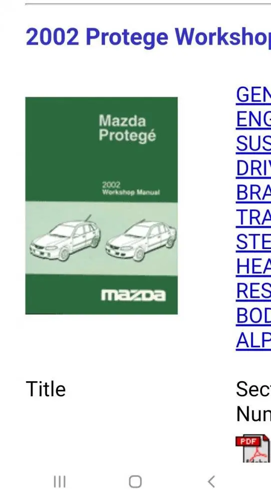

Here is a link to the full service manual for the 2002 Mazda Protege...

This is the service manual download. The 2002 Protégé and Protégé5 are pretty much the same car except for the hatchback on the P5.
