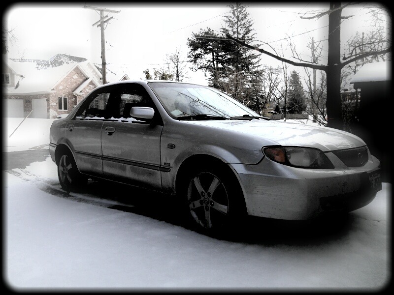

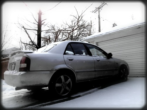

Shot some recent photos of my car with my smartphone. This is my inspiration to get cracking this Spring and put some work into it! (springs/struts, exhaust, , rear sway bar, sticky tires, better wheels)
