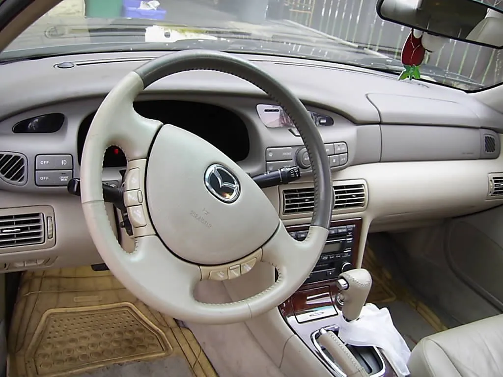

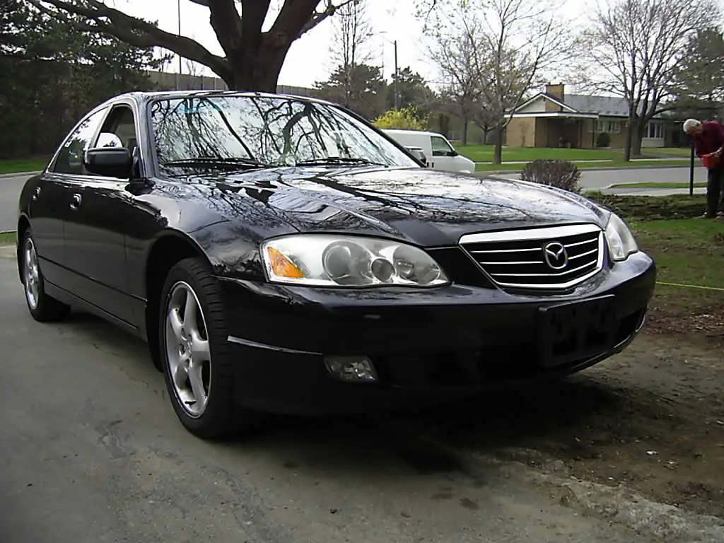

i've just got myself a millenia S 2.3L miller circle engine. its been good to me so far.

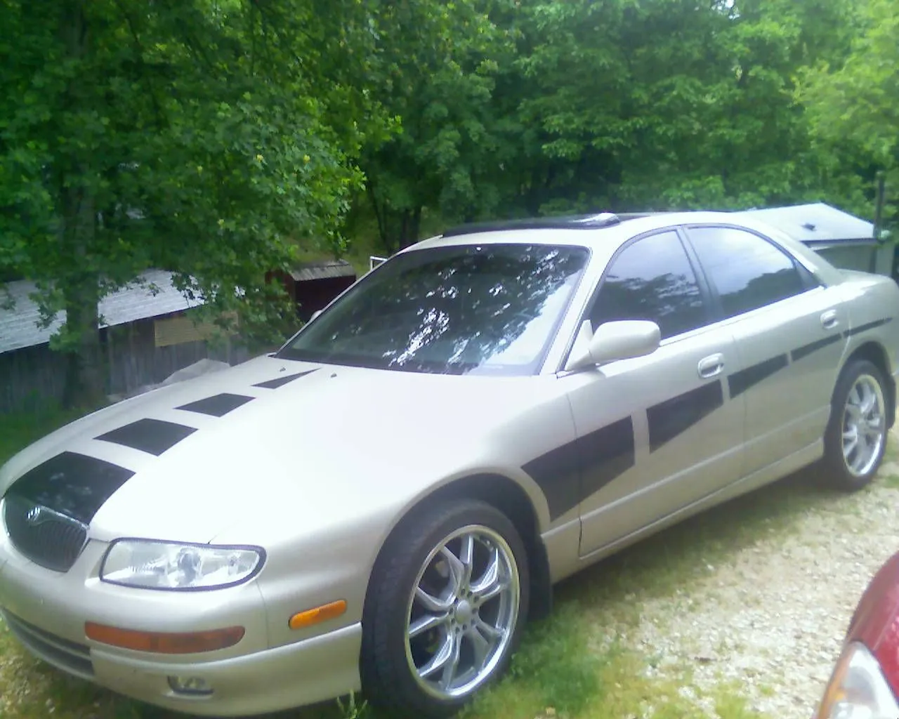

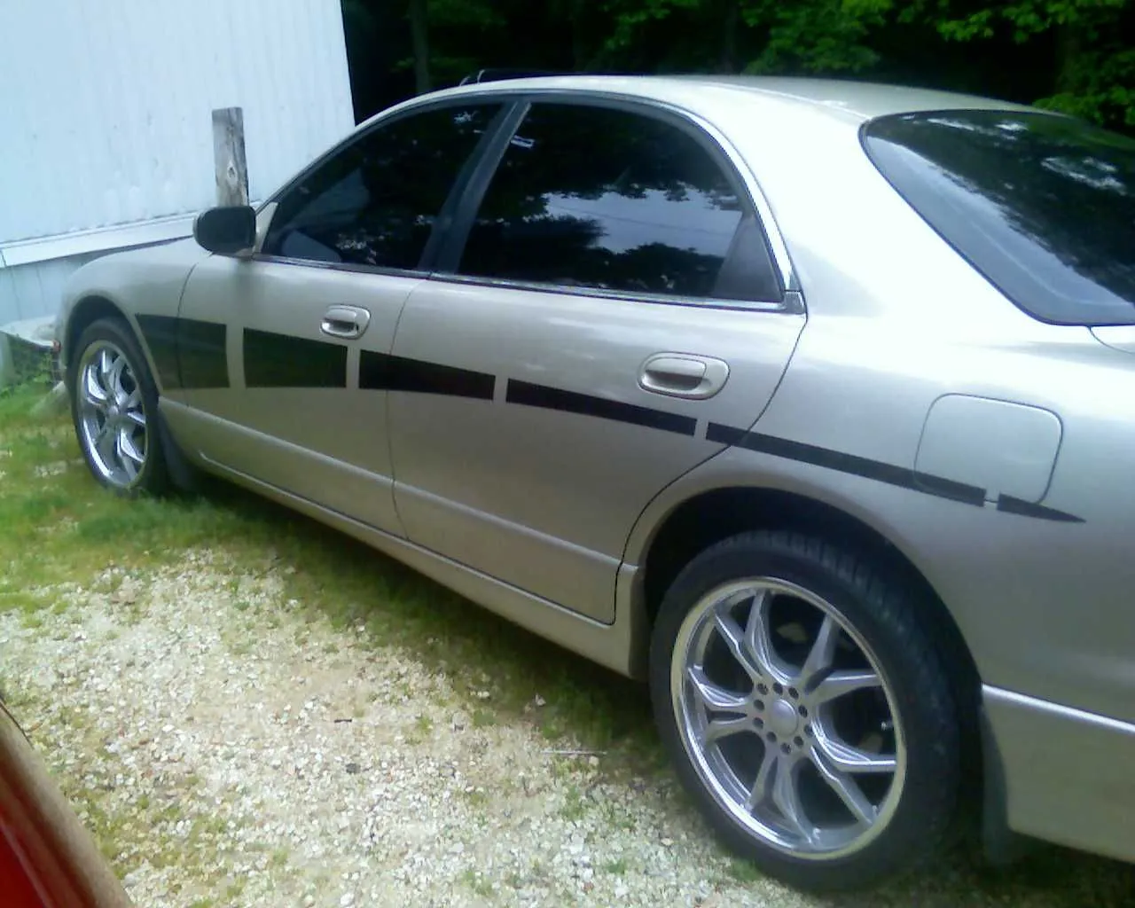

Hey i just got my Millenia like 3 or 4 days ago. Traded my Cougar for it, the tranny was about to go out in it, so i traded a guy for this. Think he got jeaped!!! This car has CAI, 3A Racing exhaust, aftermarket gauges that change from blue to green, it's chipped, it has underbody neon kit, Alpine headunit, 2 10 inch Sony Xplod speakers, and a Directed Audio 800 watt amp. So like i said i think the other dude got ripped off. As to what everybody else is saying...this car will get up and go...your doing like 90mph before ya know it. As i said this one is chipped and he told me he had it dynoed at 230.7 hp. As into how much i can believe that idk...but that's what he says. I'd like to learn some more about modding it...since like others have said it basically has the same engine as a probe. So as in turbo's etc i would like to know more about!!!
