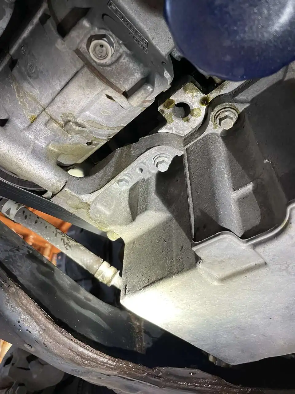

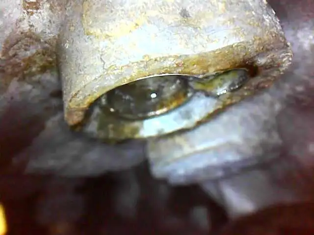

My 08‘ just started puking out the weep hole behind the alternator today. Luckily it happened just as I pulled in the driveway. I dont think any coolant got in the oil though. I’ve really liked this car and it is still in excellent shape being only a few miles from turning 165k miles. Don’t think I have the time or energy tackle it myself right now so I’ll call for estimates to see if it’s worth fixing. We’ll see.
