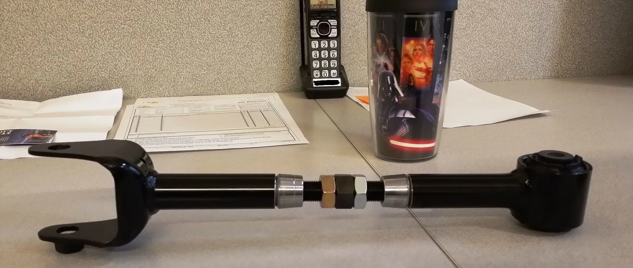

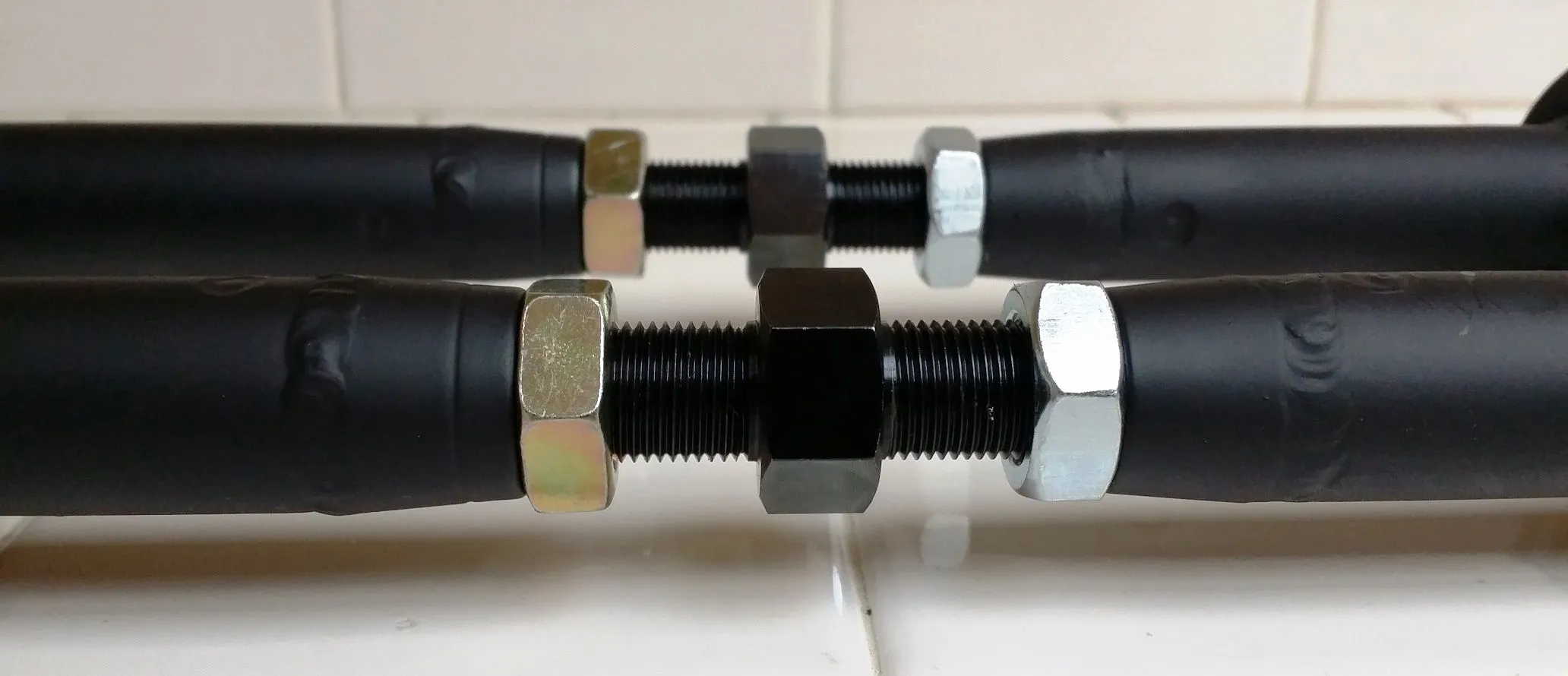

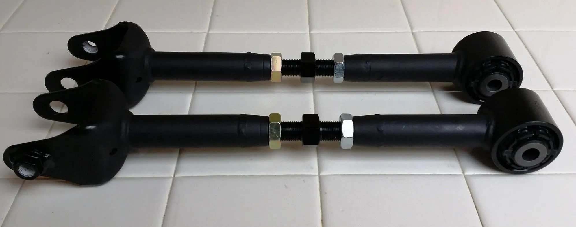

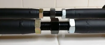

I have modified the factory lateral links. I have made them adjustable. I have purchased new ones, from Ebay(~$54/each), https://www.ebay.com/itm/MAZDA-GENU...ash=item4b32ad993f:g:ZRUAAOSwKOJYHN63&vxp=mtr, https://www.ebay.com/itm/Allstar-Pe...ash=item5417715691:g:mqYAAOSwyDxXhLU-&vxp=mtr and these: https://www.ebay.com/itm/5-8-18-RIG...m=192372286287&_trksid=p2047675.c100011.m1850
If I remember correctly, I had to cut out 2.250", from the factory arm and I had to increase the hole slightly.
Do you have any pics by any chance . Want to see what you meant by modifiying the lateral link arms.
attachment.php
attachment.php
attachment.php
Most likely, I'm the only one, who has this setup.
I don't remember the company's name, but an Australian suspension company's owner told me, that this is the best way to do it. It will bring inward, the bottom of the wheel.
With the camber arm(mounted up), the wheel has to be pushed outward(closer to the fender).
P.S. It was K-mac Suspension(Kevin), who suggested that I should do it this way.
http://k-mac.com/
