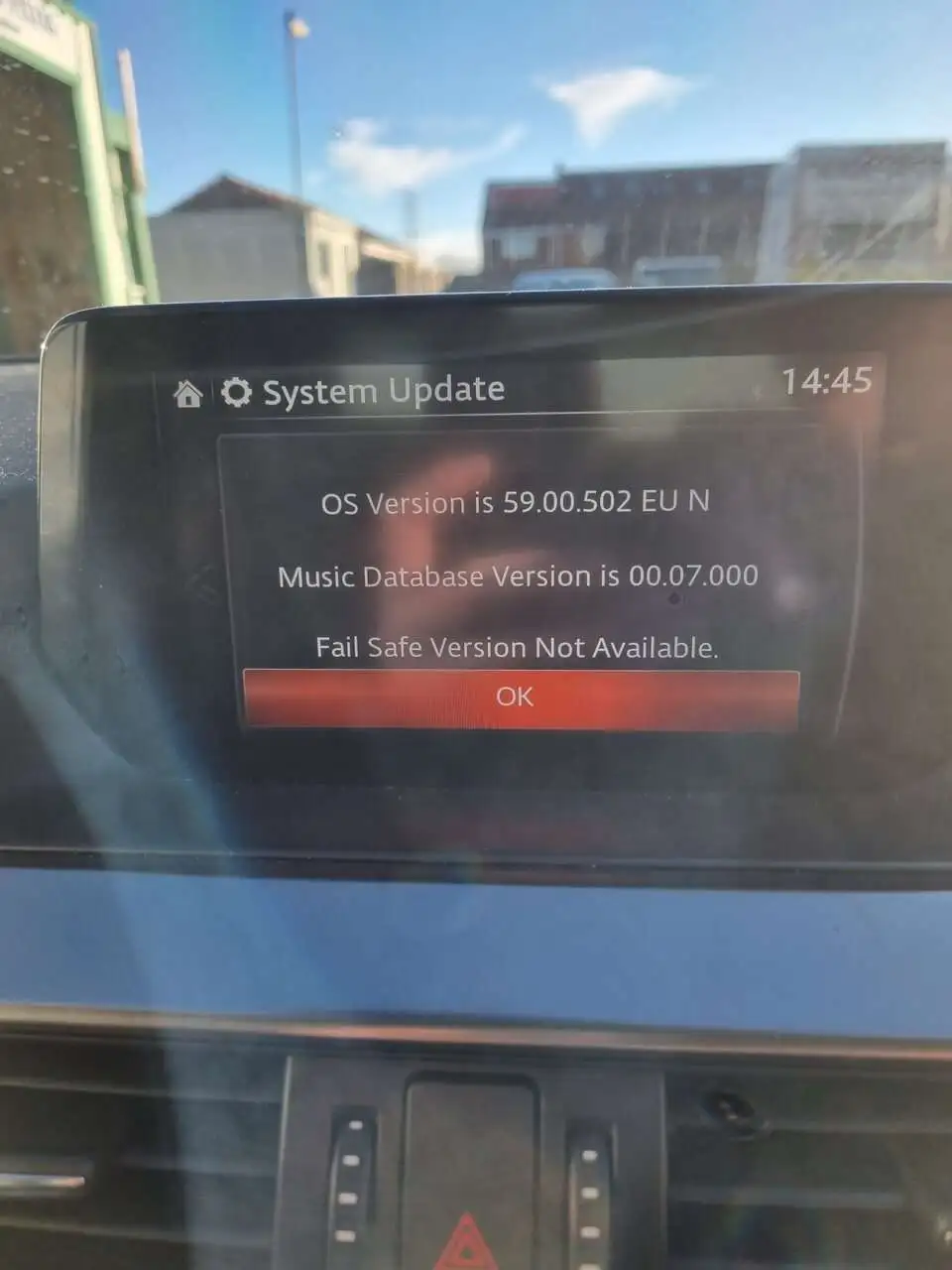

Not sure what happened here. I attempted to update from the current version to 70.00.367A and it all stopped, wouldn't do a thing. It says Fail safe not available and won't find any update file on the USB stick, it previously found it. The unit still appears to work as it should but I want to complete the update.
After reading a post by Ash8 it looks like I should have updated to 70.00.100 first which was the two part install.
Any help will be massively appreciated.
