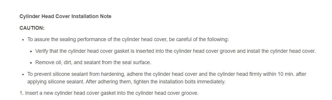

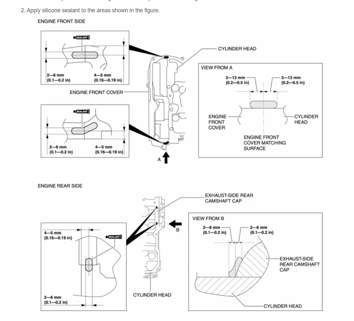

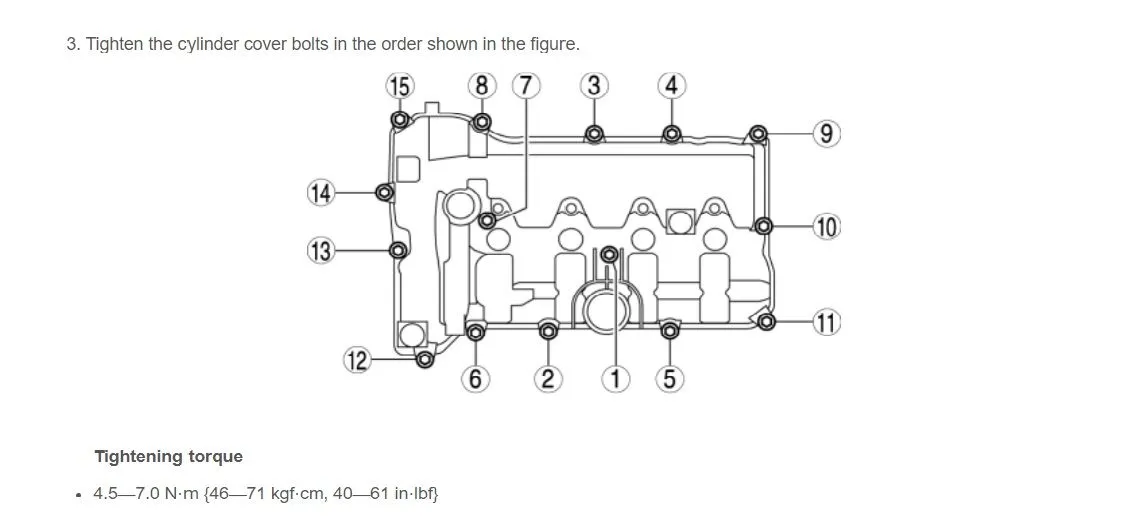

From Mazda CX-5 Factory Workshop Manual, the liquid gasket felixd mentioned in the video is the silicone sealant said in the manual which needs to be applied at several locations in addition to valve cover gasket. Any silicon RTV suitable for high temperature should be fine.
