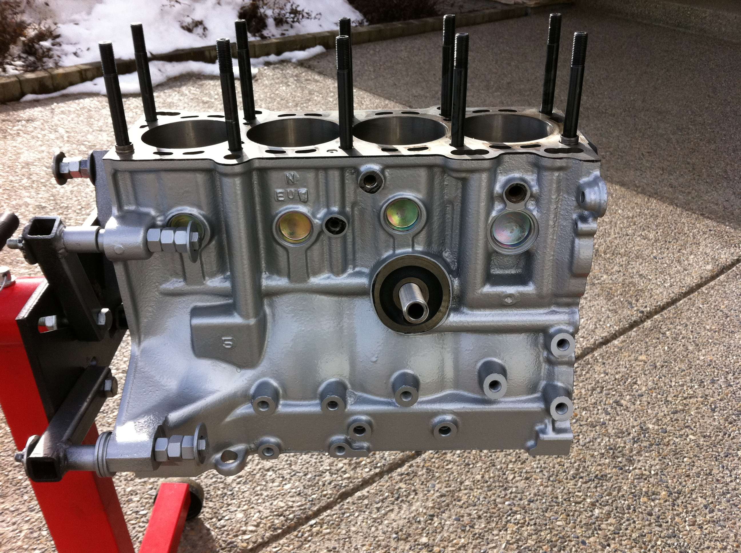

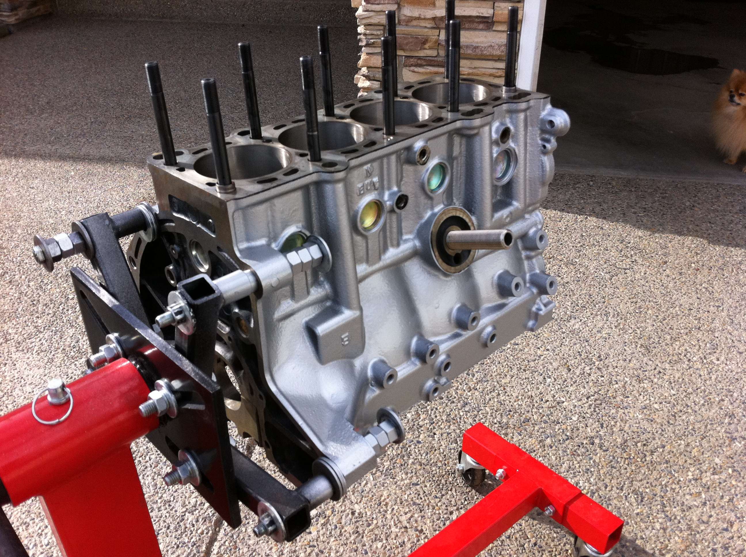

Took it out, degreased, scrubbed, and rinsed it really well. Blew the entire block dry with compressed air, and smeared all the vital areas with a thin coat of oil to keep the rust away for now.
Prepped and masked the block, and sprayed it silver this time around. Used DupliColor Engine Enamel, 3 coats of silver, 2 coats of clear. Added a few detail touches like the "FS" lettering. I think it turned out pretty good.
The holes I didn't mask were all chased with the proper sized metric tap to make sure they are down to bare metal and the bolts can be installed freely.

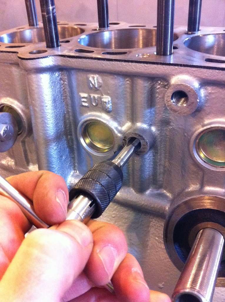

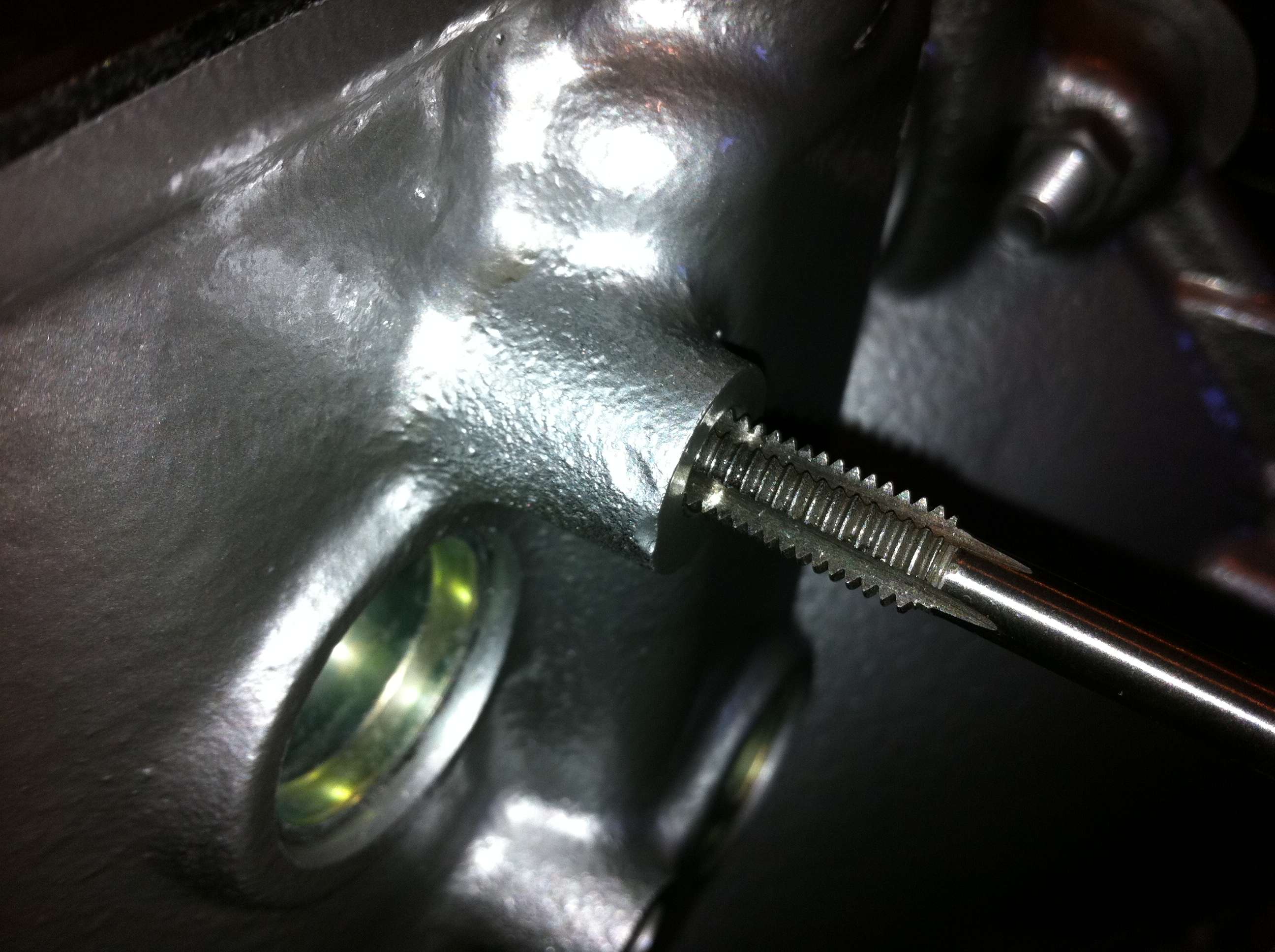

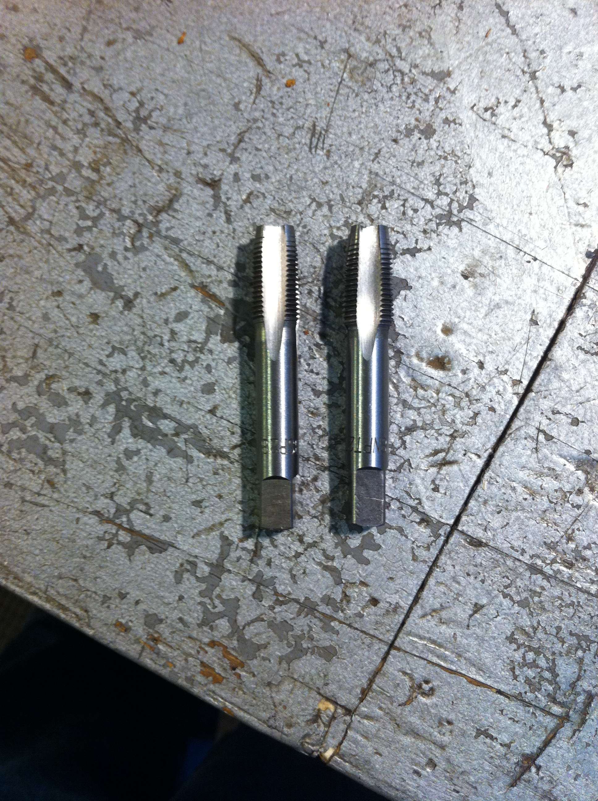

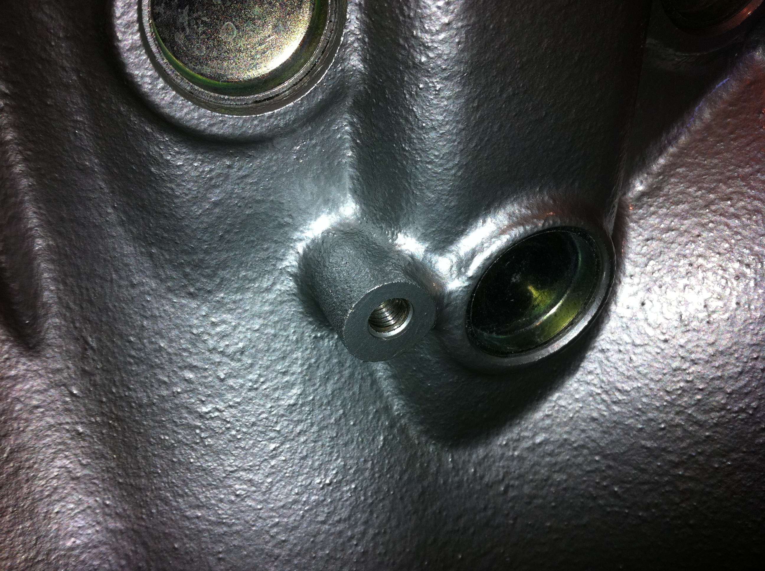

The block as it comes stock, has an oil pressure fitting threaded with a 1/8 BSPT (British standard pipe taper) which features 28 threads per inch. Most aftermarket oil pressure sensors are threaded in 1/8 NPT (national pipe taper) which has 27 threads per inch. Not a big difference, and most of the time the two are interchangeable for the first quarter inch or so, but rather than use a BSPT to NPT adapter, I decided to tap the block itself to a 1/8NPT size. Tapping cast iron is a bit tricky, but use lots of lube and go slow and it can be done.
Showing BSP vs NPT:
Tapping out to NPT:
Some might argue this was pointless, but I like to do things right.

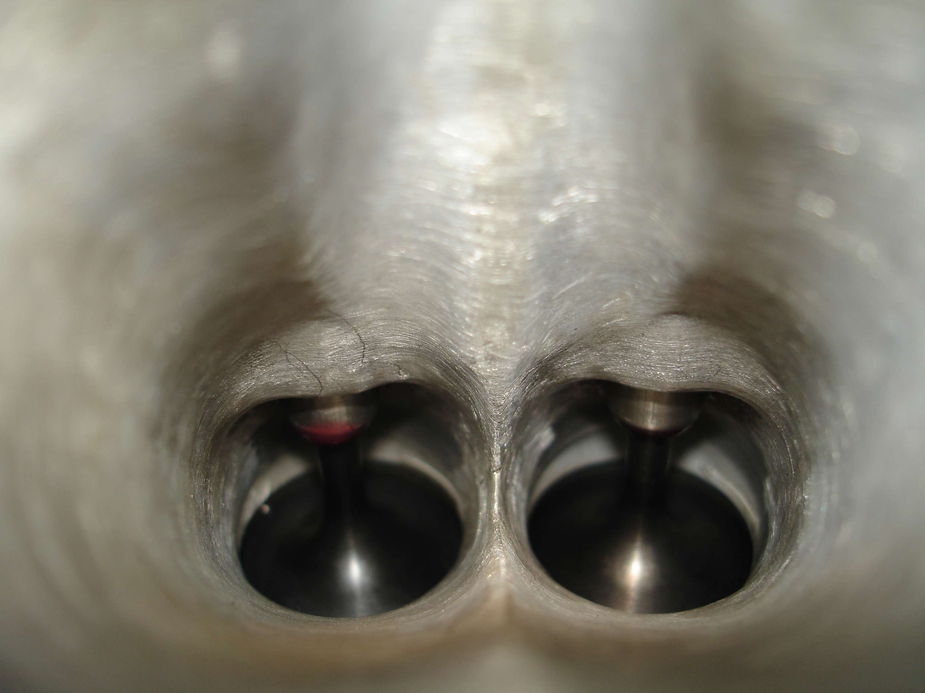

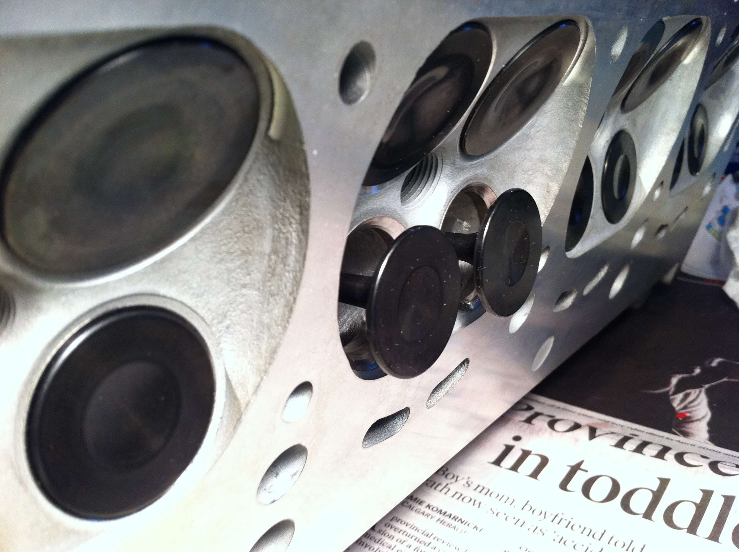

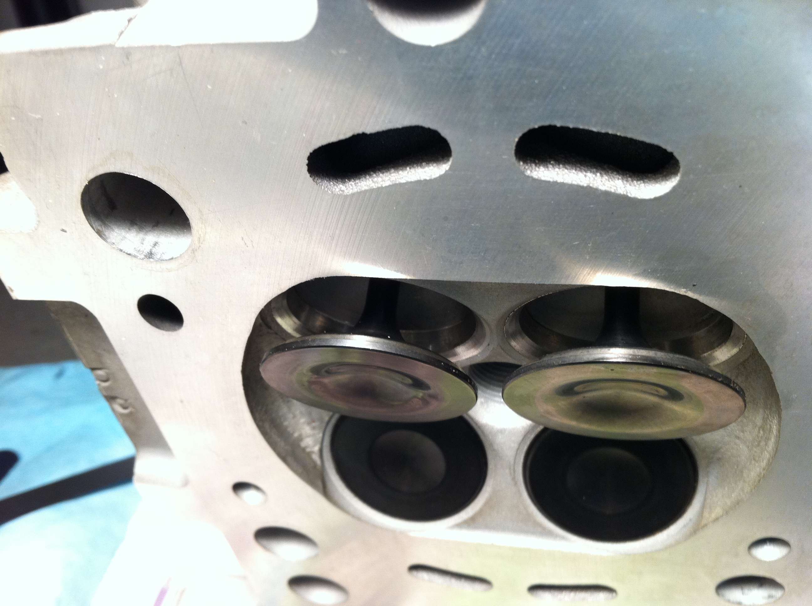

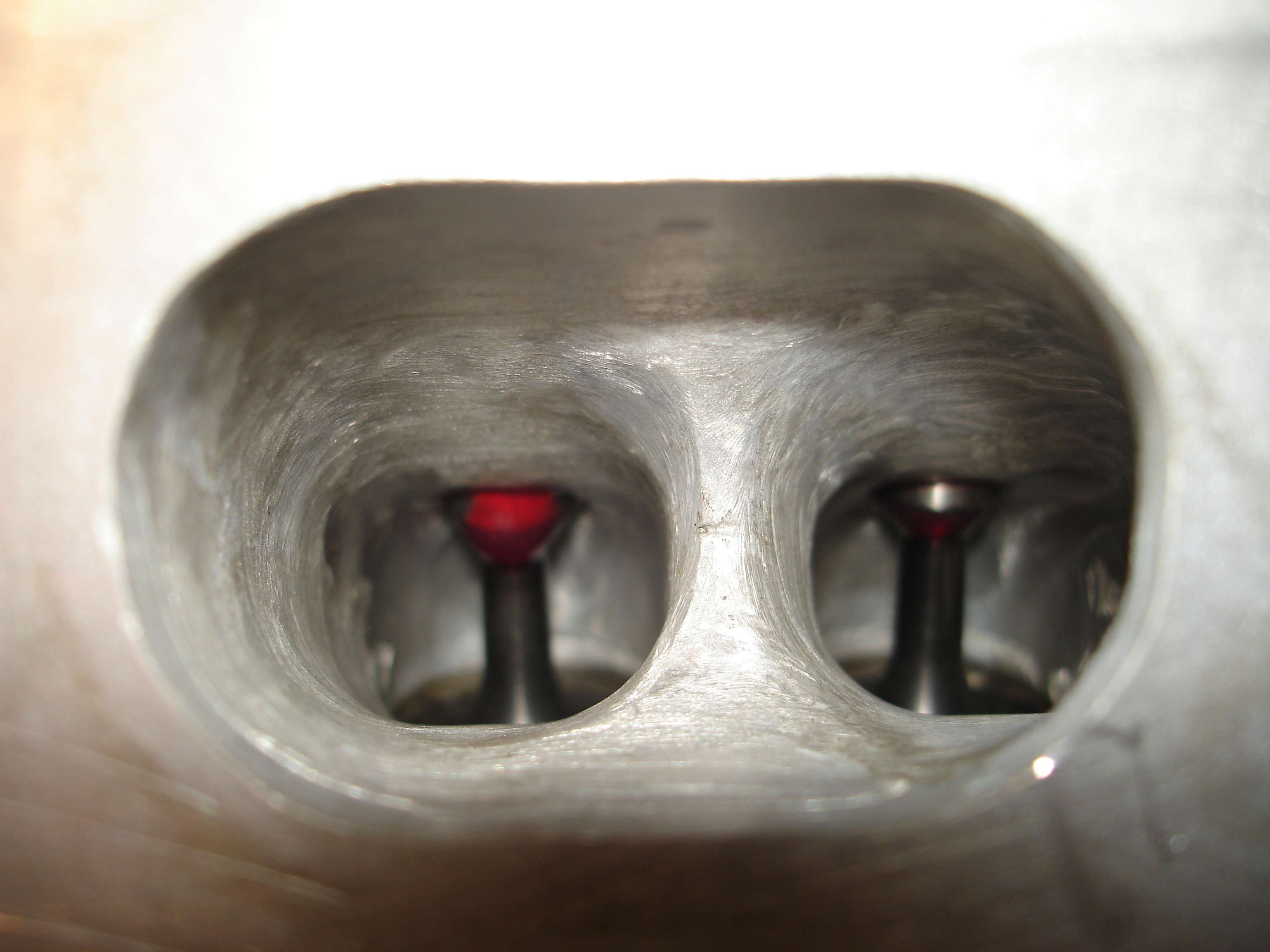

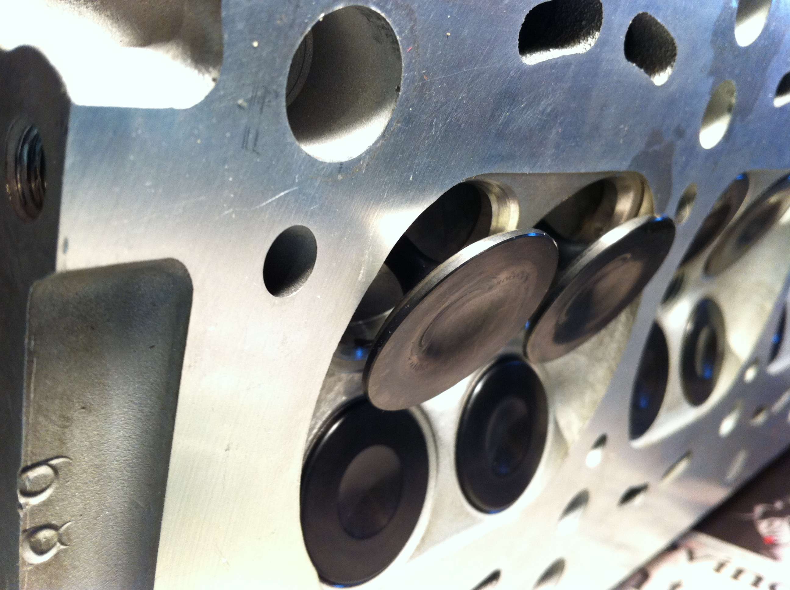

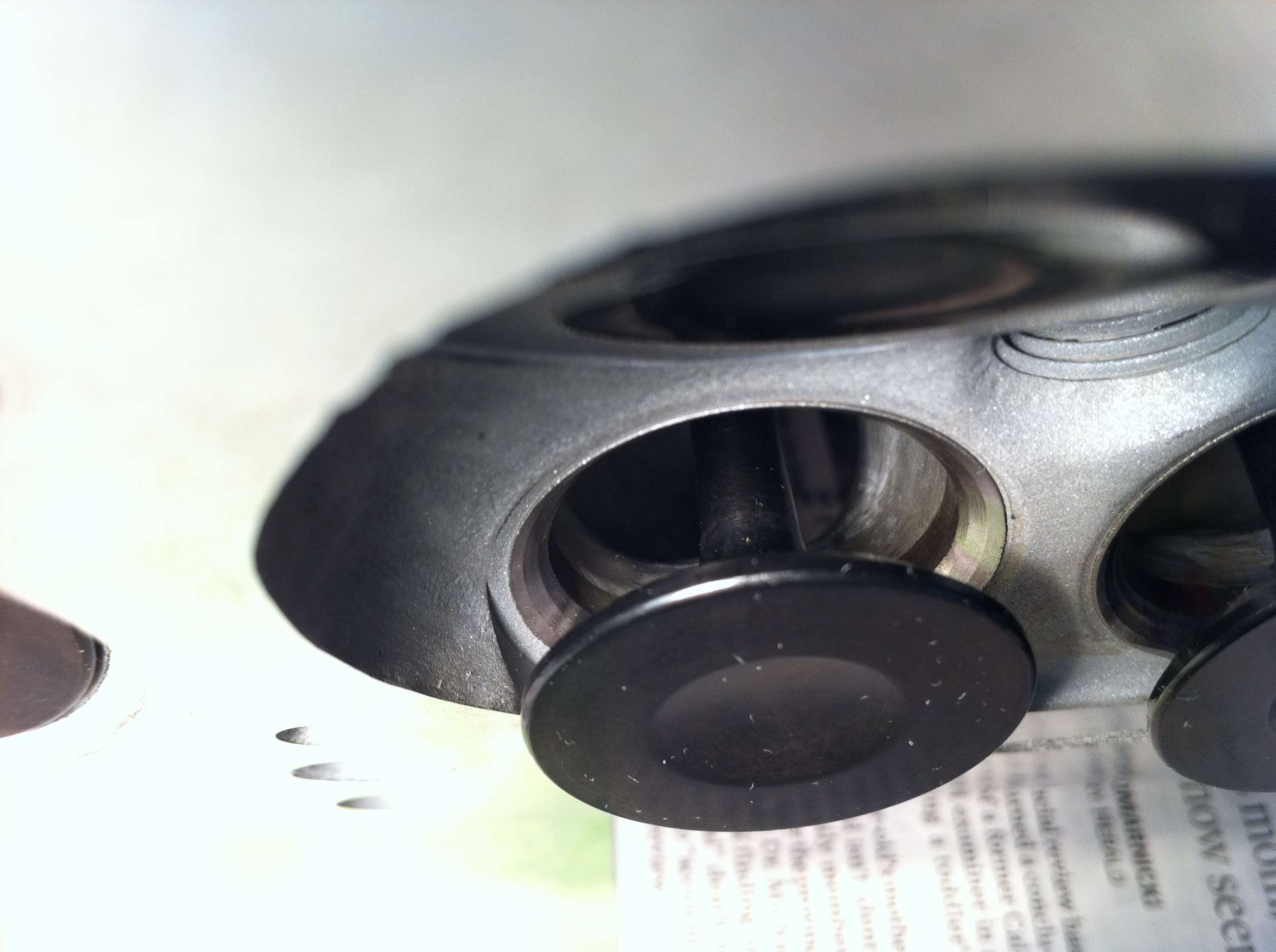

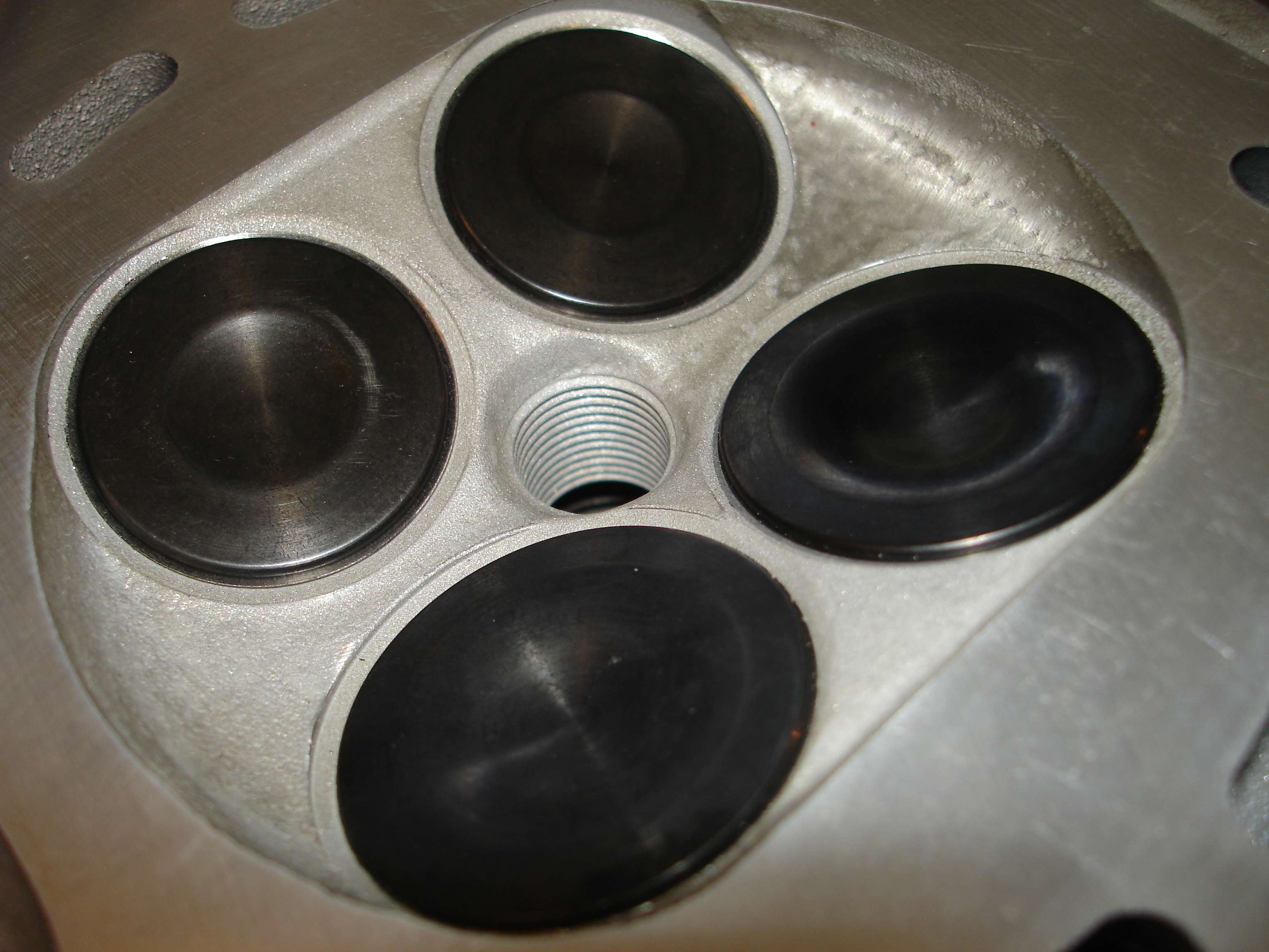

Picked up the head today. Supertech 1mm oversized valves, dual valve springs, and titanium retainers. Valve seats re-cut, a serious port job was performed, and the head was decked and reconditioned.
Chamber:
Exhaust side:
Intake side:

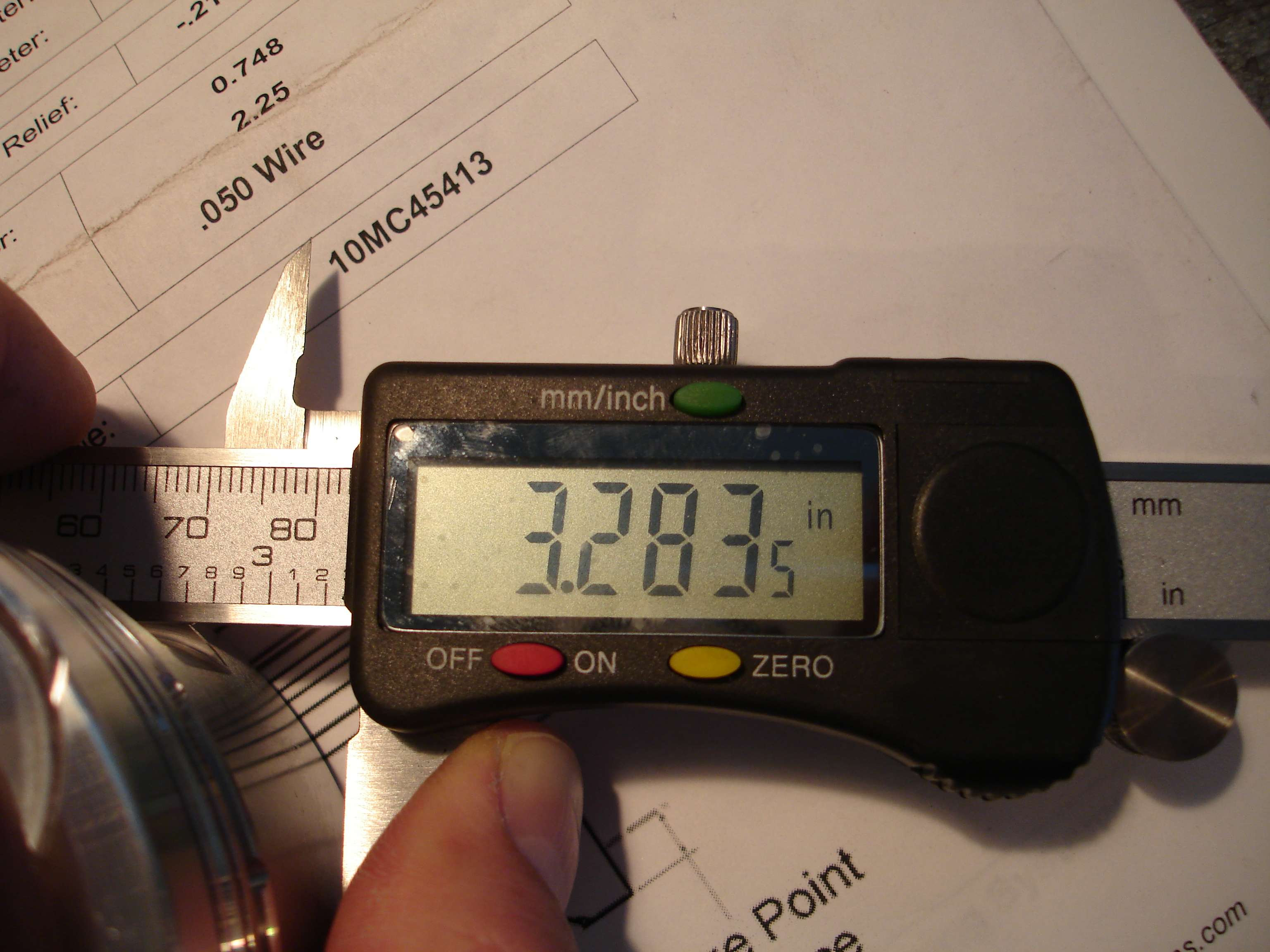

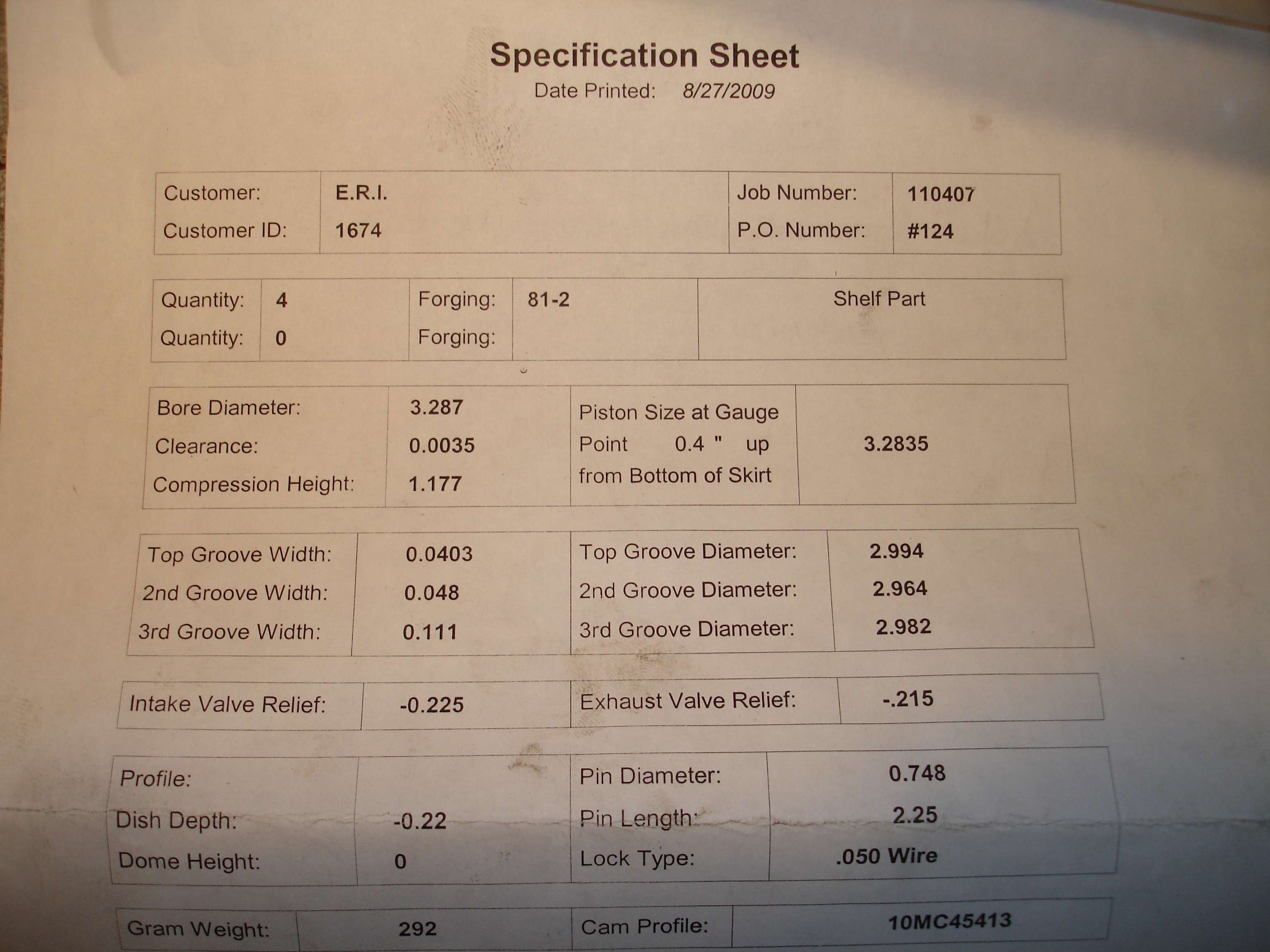

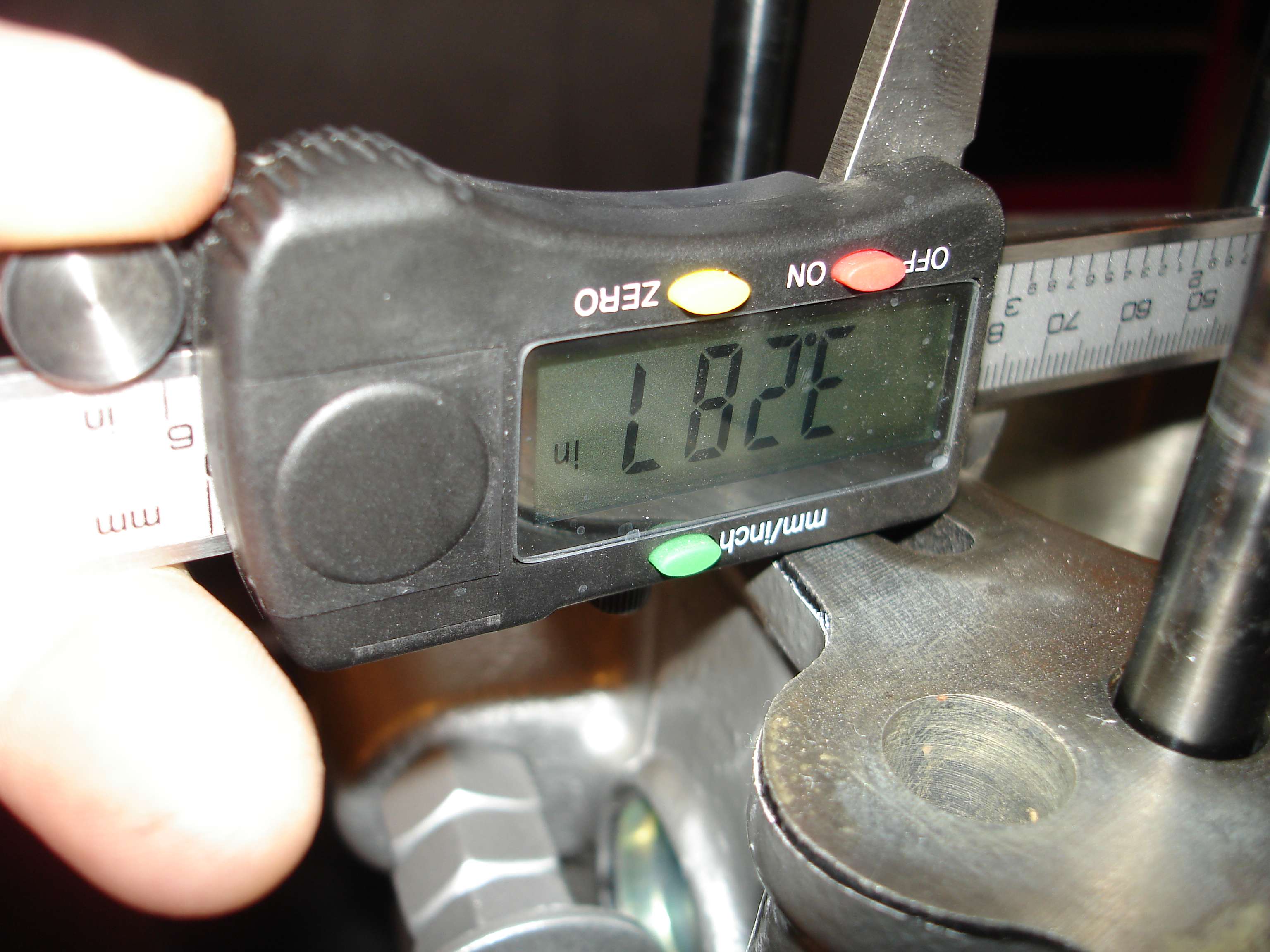

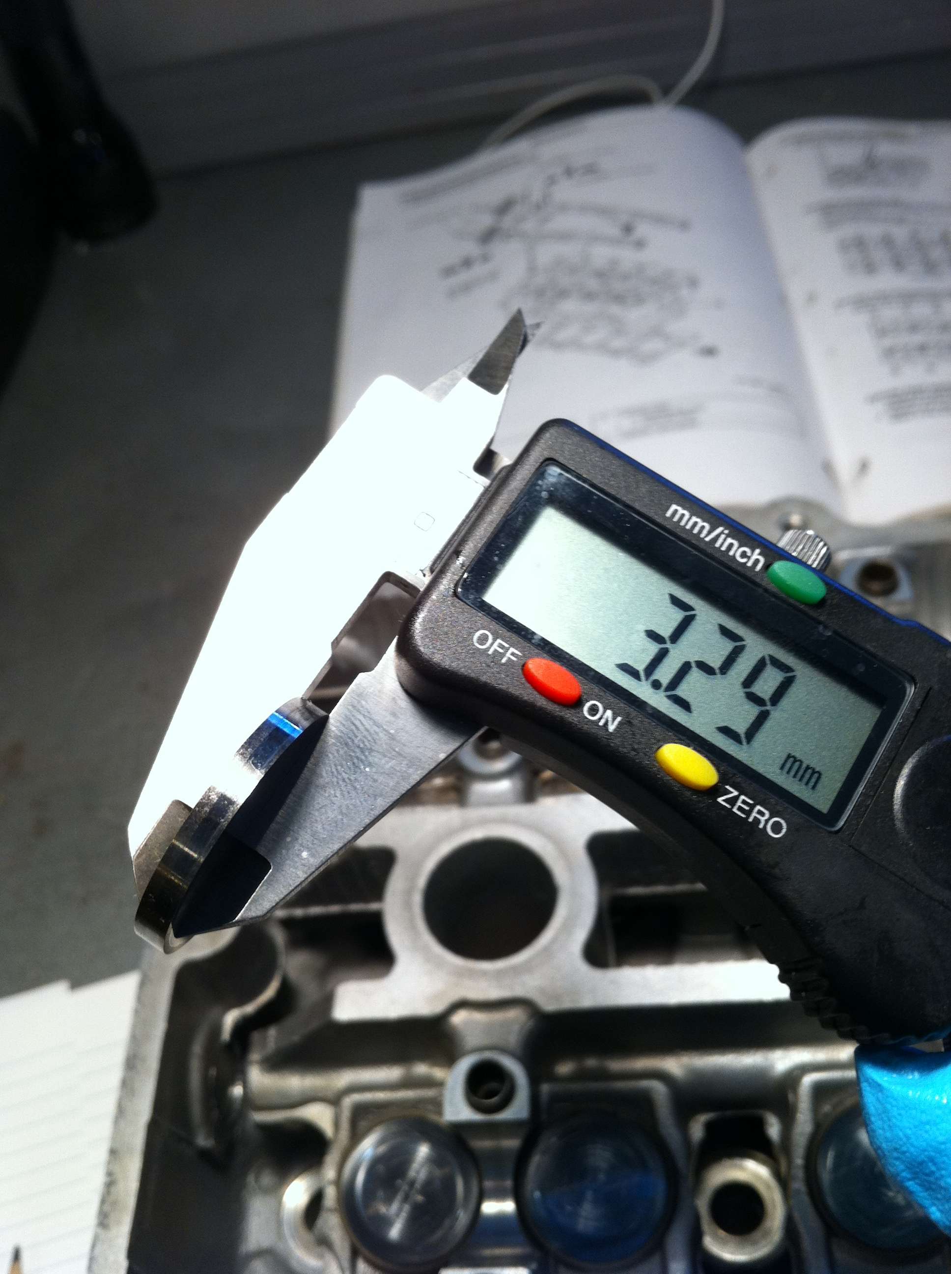

Took some measurements today with regards to the pistons and block. My machine shop already did this for me, just wanted to double check as best I could. Normally, you'd perform this measurement at three points down the length of the bore, but for today's purposes I just used the top as the cylinders were just honed and have no taper.
Spec sheet from CP showing the measurements we're after:
It was hard to hold this and take a pic at the same time, but as you can see the piston is bang on:
Onto the cylinders, I know it's upside-down, but again, 3.2870", bang on. All 4 pipes checked out the same.

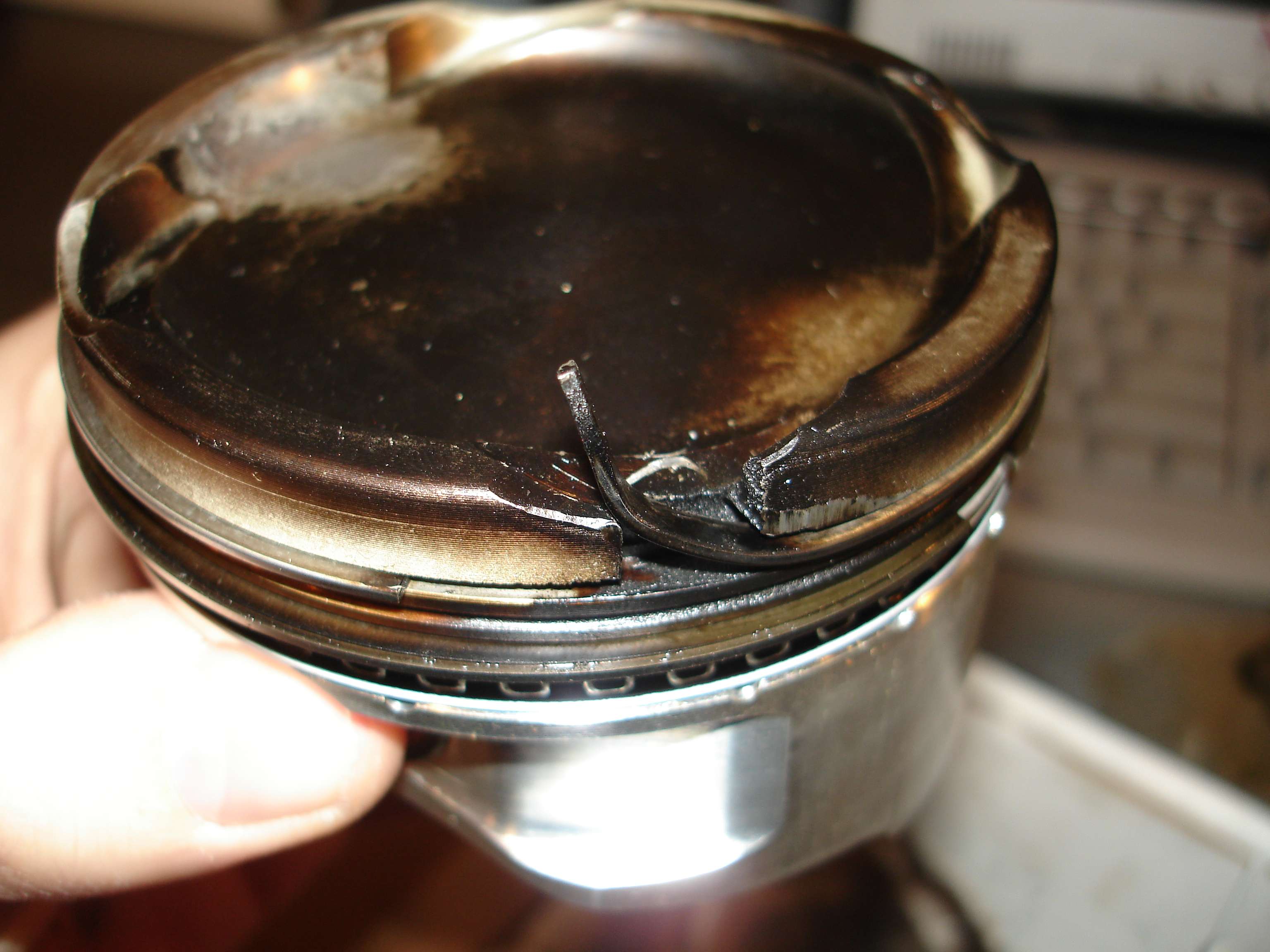

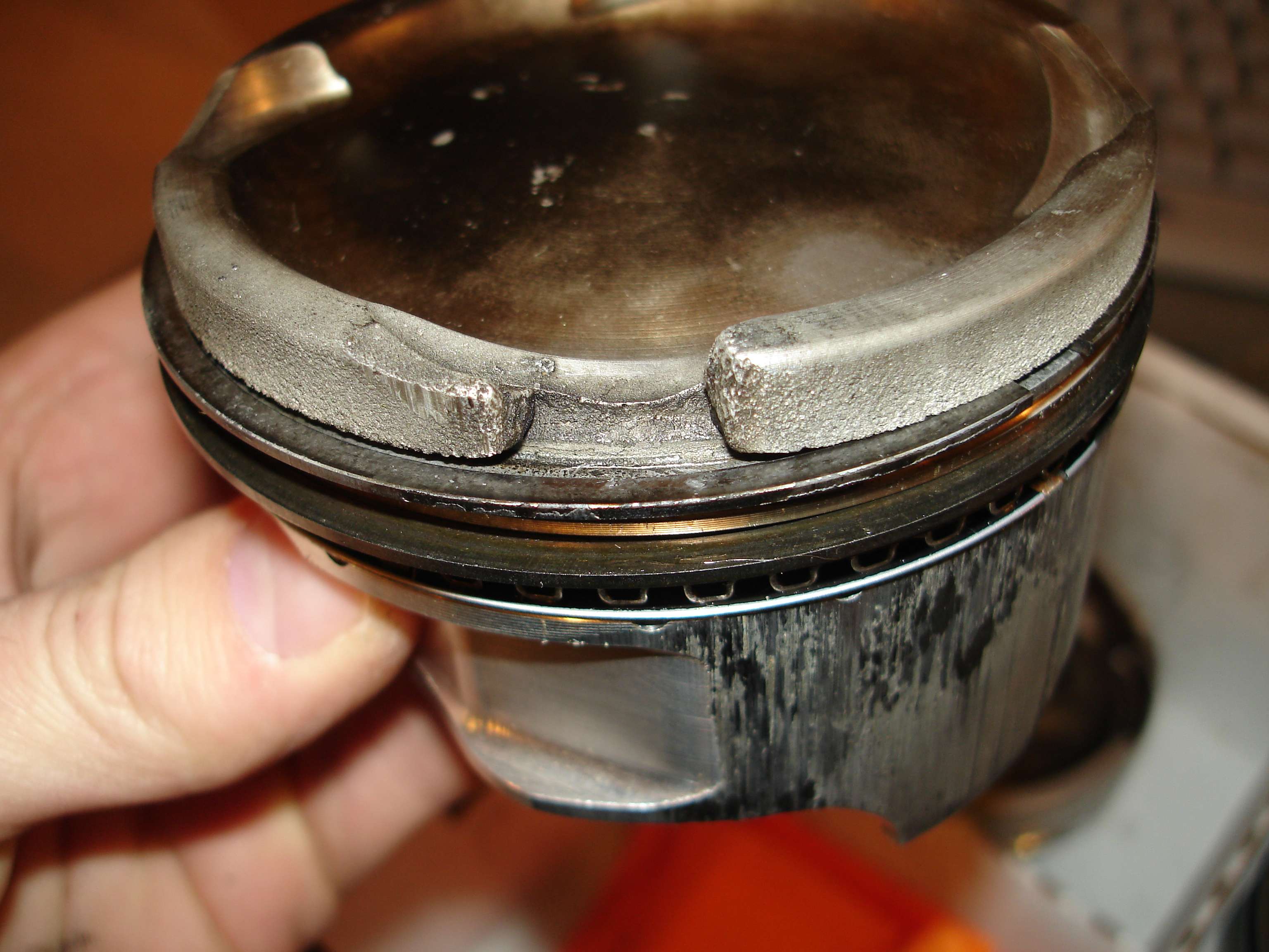

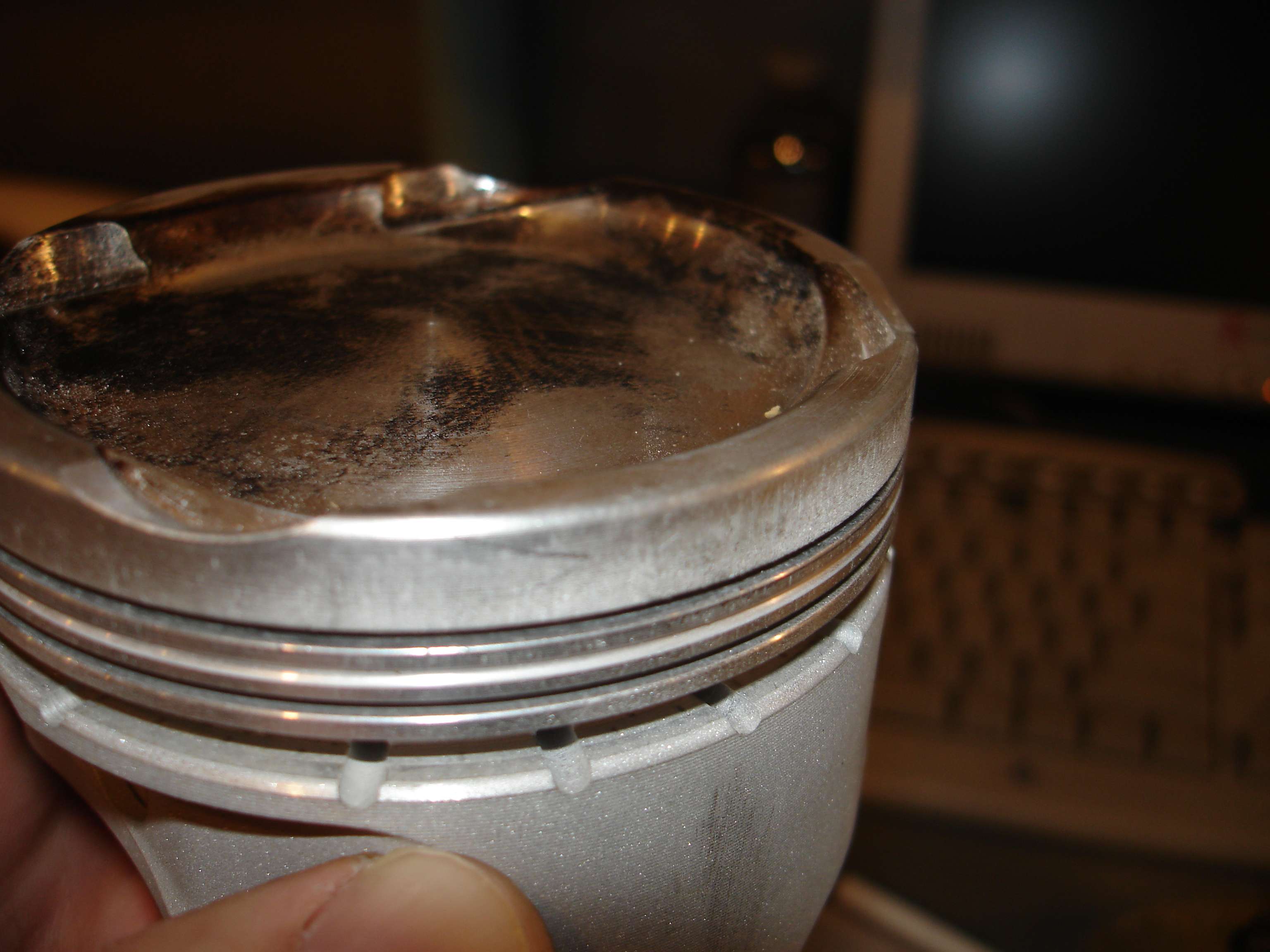

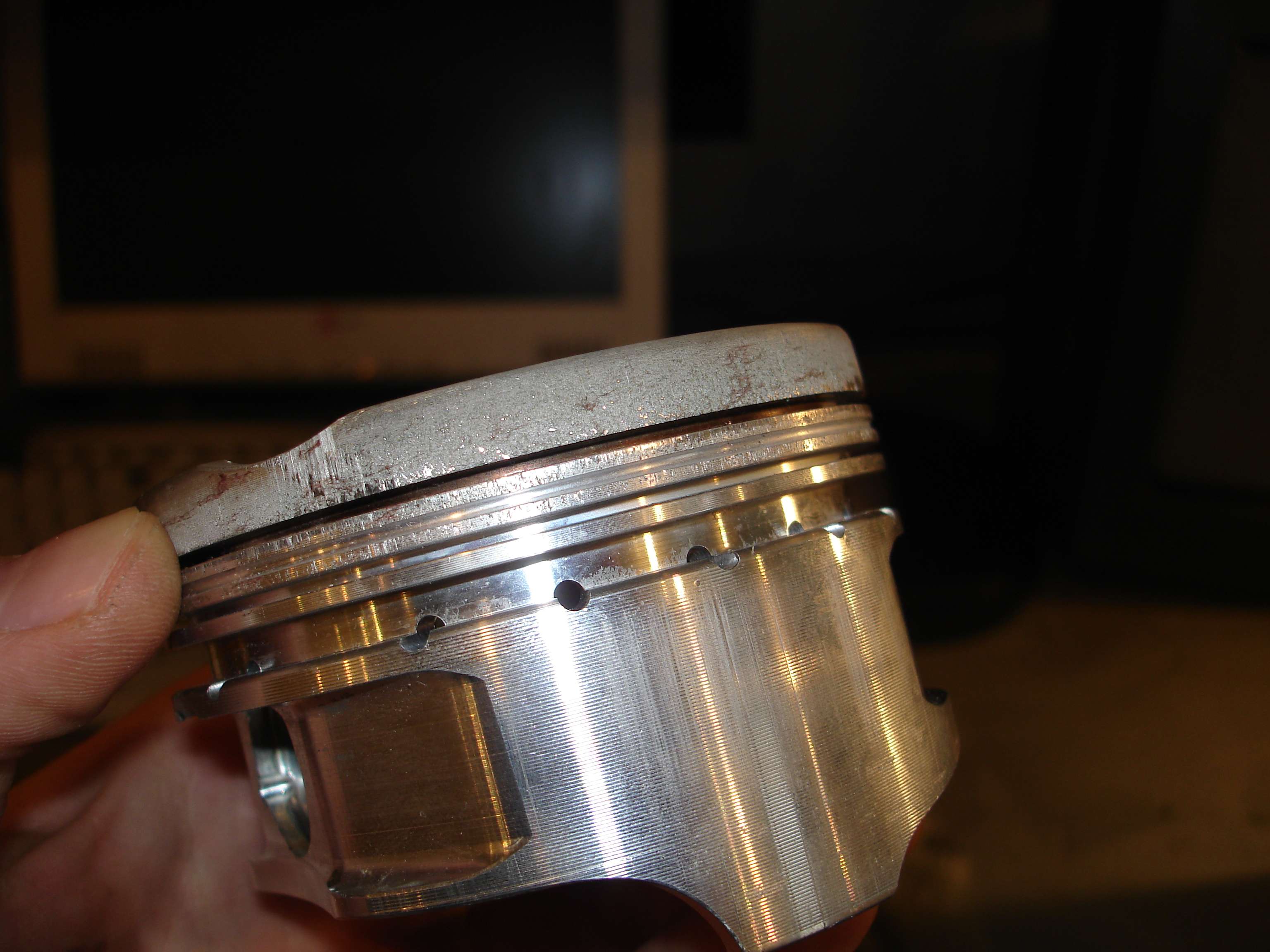

A little off topic, but this is why I decided to wo with CP pistons this time around. My LAST 4 sets of Arias were destroyed. Each of these pistons is from a different set:

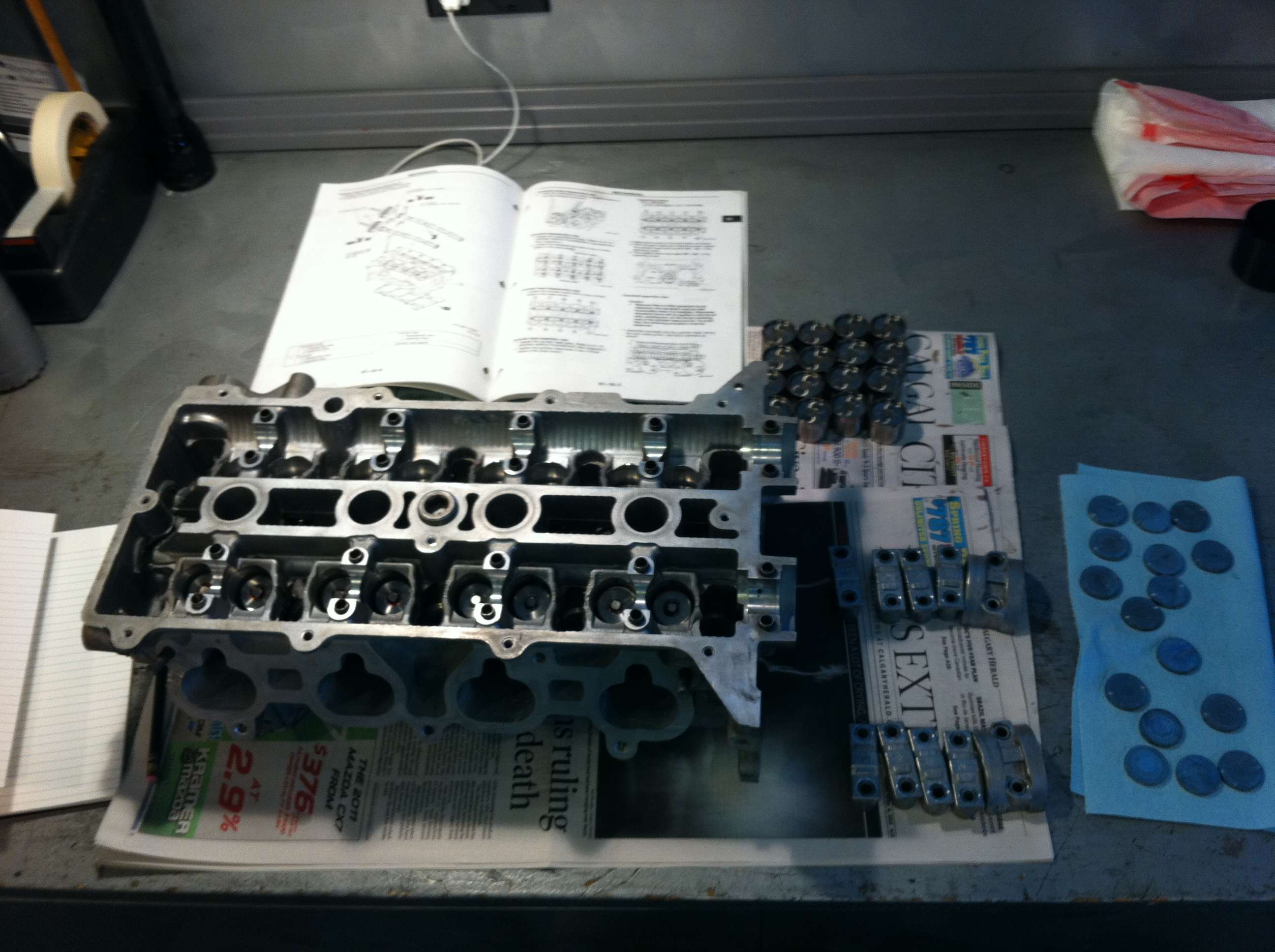

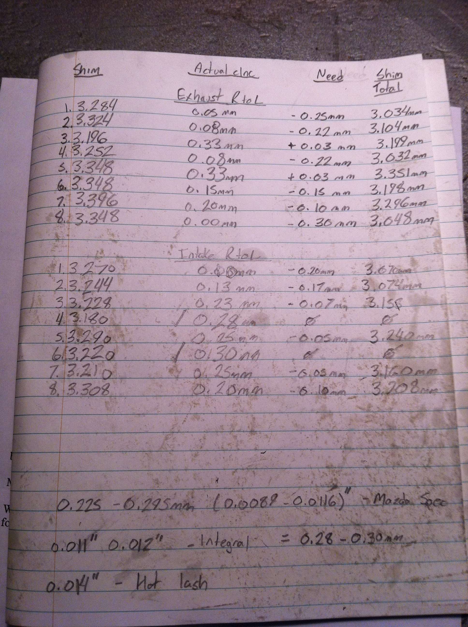

Setup the head today and took lash measurements. The key to this process is to document everything. Excuse my messy notepad, but it works for me. Got all the parts cleaned up, and removed the shims from the buckets. Because I'm installing new cams, the position they were in previously with my old cams is irrelevant. I started by taking a baseline measurement of the actual clearance, with the cams installed, measured on the backside of the lobes with the lobes straight up, as per the FSM. Stock Mazda lash spec is 0.225mm-0.295mm. The specs provided with my Integral cams lists a cold lash spec of 0.011"-0.012". (0.28mm-0.30mm) I'm choosing to shim to the looser side of spec, of 0.30mm final valve clearance.
Parts all layed out, and shim thickness recorded based on where I installed it.
On some of the shims, the etched measurement on the backside had worn away, so I had to measure their thickness manually:

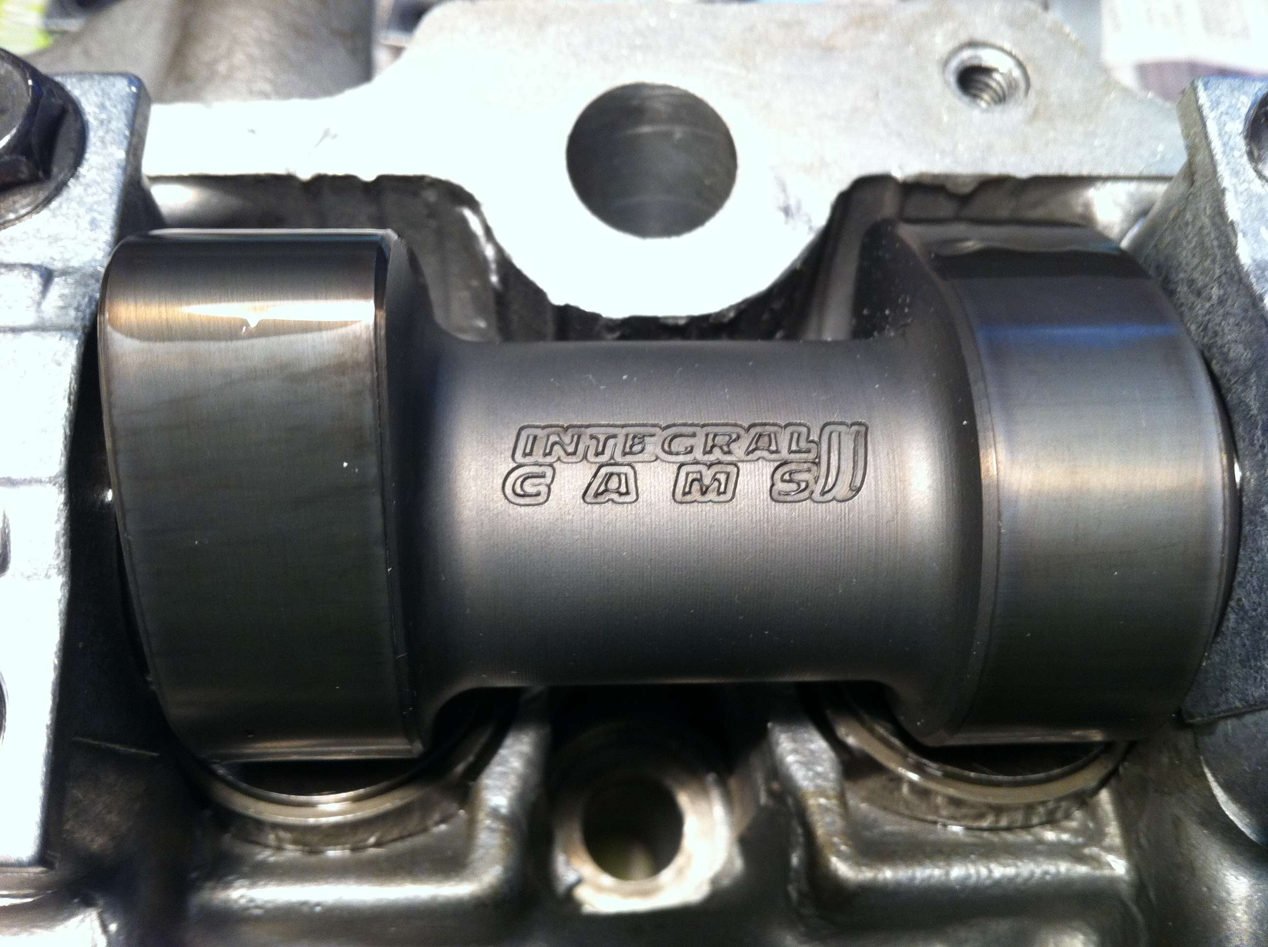

Check the hotness! Integral Stage 3 turbo cams, all lubed up and torqued down:
After all measurements were taken and documented, I can take it back apart, order my shims, and then re-install and measure it all over again. Here's my chicken scratch:
For the cams themselves, I'm very excited. The specs on these things are insane. Combined with the oversized valves, and ported head, there will be no shortage of air entering or exiting these combustion chambers. The idle will have a noticeable "lope" to it. I'm hoping the car will start with my Haltech map from when the JDM cams were installed, so I can at least get it running to re-tune.

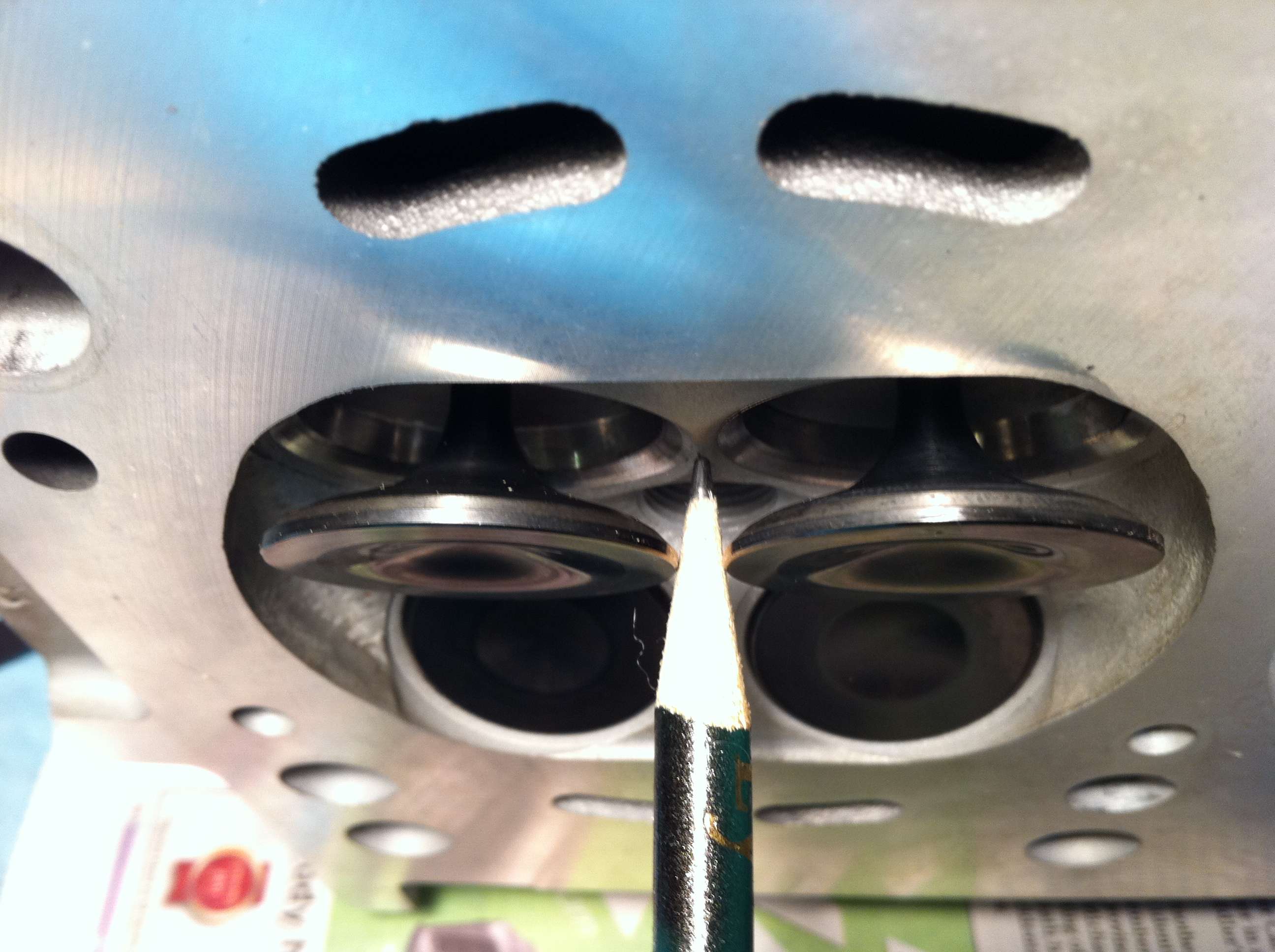

Here's what 0.371" of intake lift looks like! If I remember correctly these cams will now make my FS an "interference" engine. This is nearly 3/8" of lift!
A pencil is used for scale:
Now a look at the exhaust side. 0.371" as well:

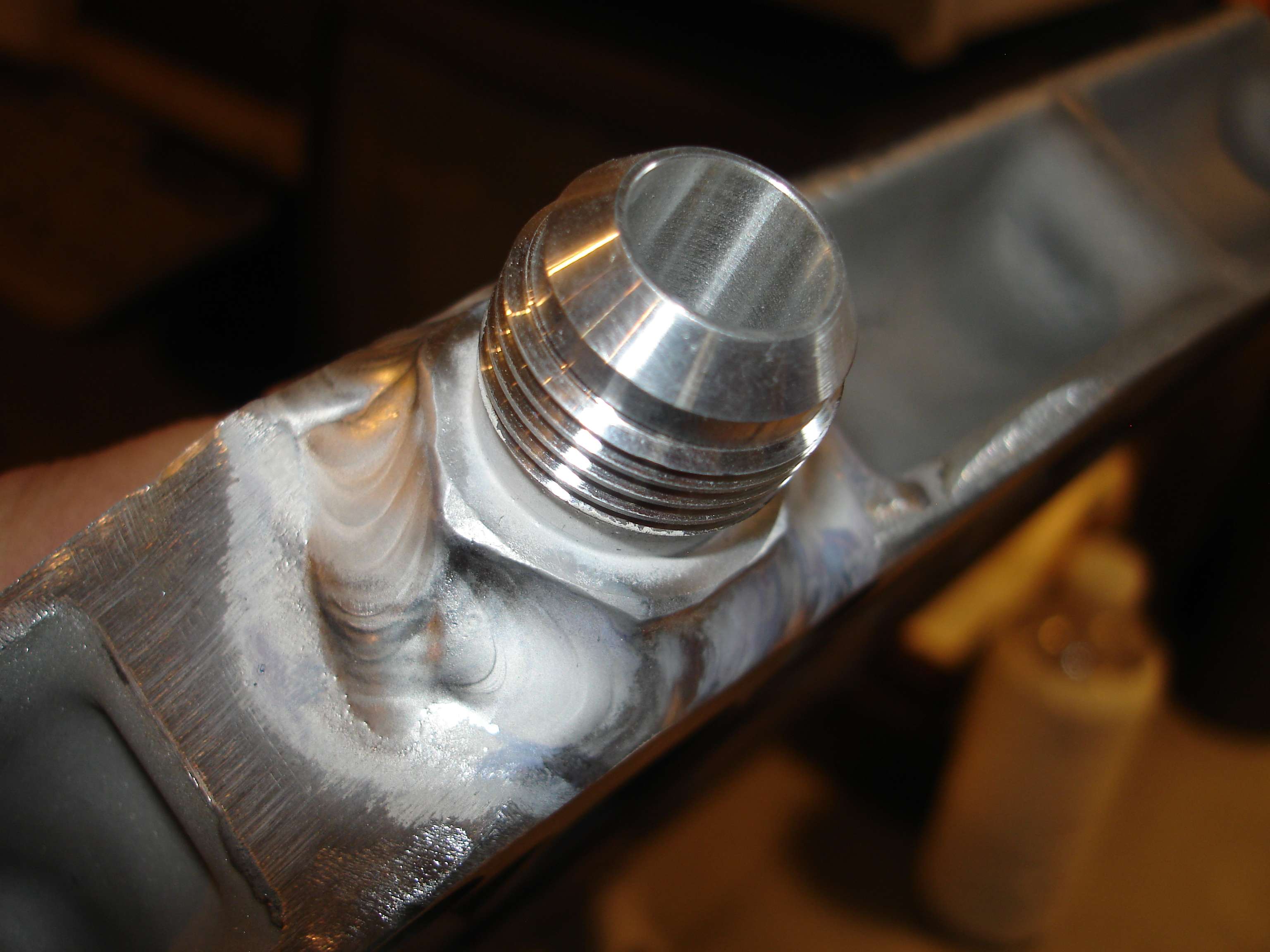

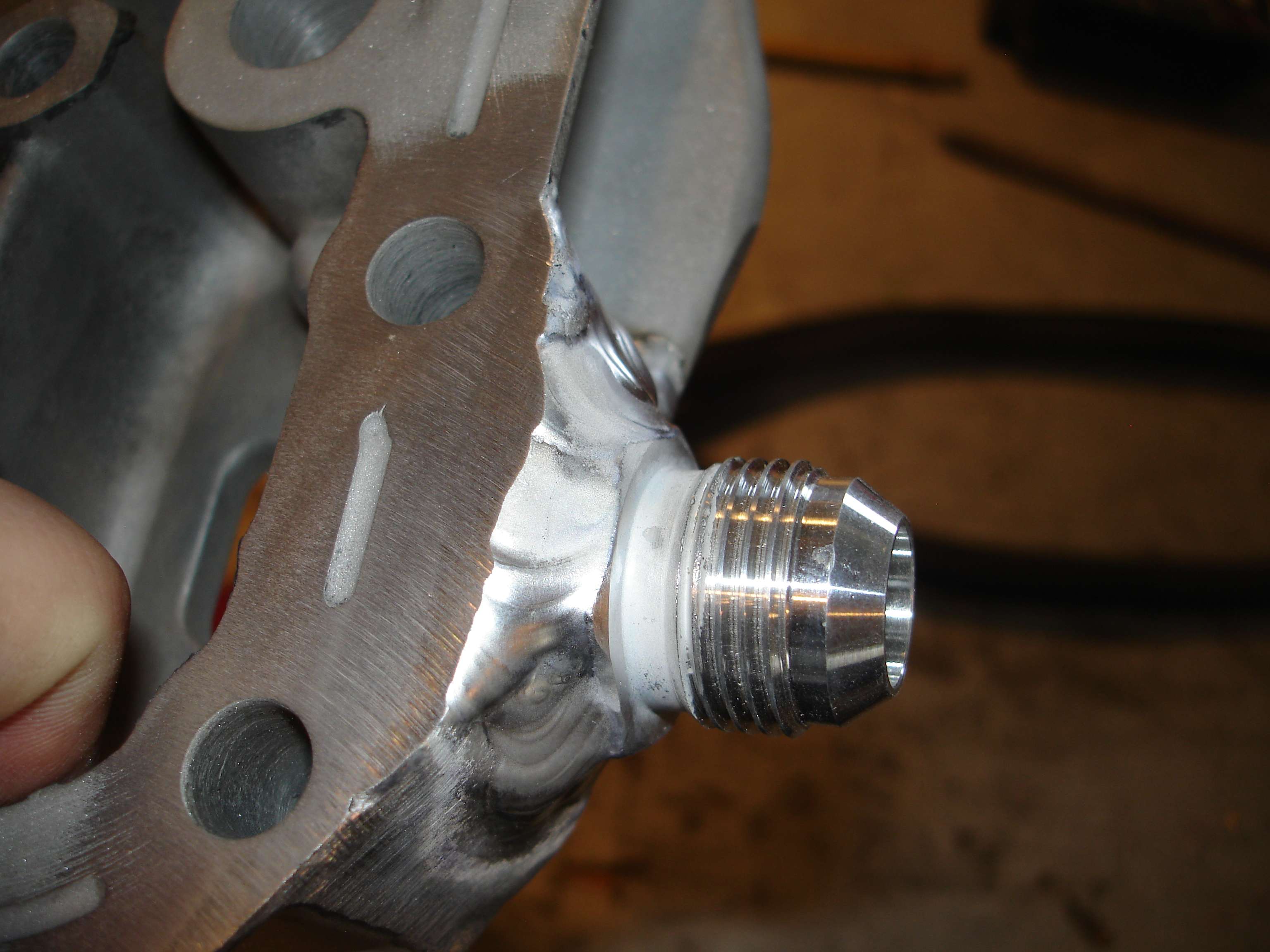

Welded on an AN-10 male fitting for the return line of my external oil pressure regulator. The DocB setup, as some of you have heard of, uses a special coating inside the oil pump to increase its available pressure, even after extended hard running, and the stock (feeble) oil pressure regulator is removed. A Peterson external oil pressure regulator is run. It has a raw input from the pump that will now be putting out well over 100psi, an out to the engine, and a bypass line where all the excess pressure is released back into the MBSP to keep the oil pressure where I have it set at. Oil pressures of 50psi at hot idle are easily obtainable with this setup, and will ensure that my engine has a long and happy life, with no risk of oil starvation.
Welded bung: (It's not pretty, but it's solid and doesn't leak!)

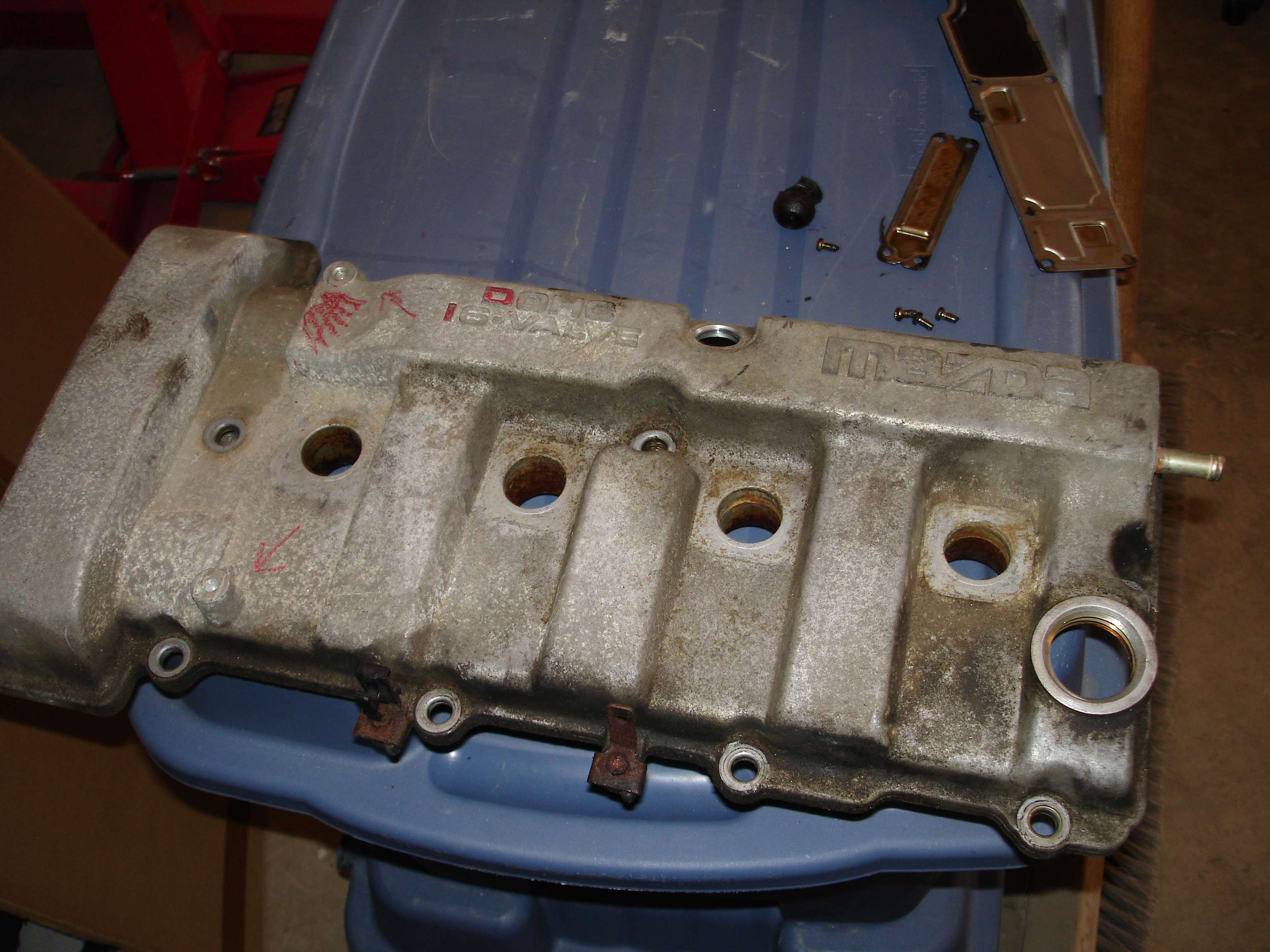

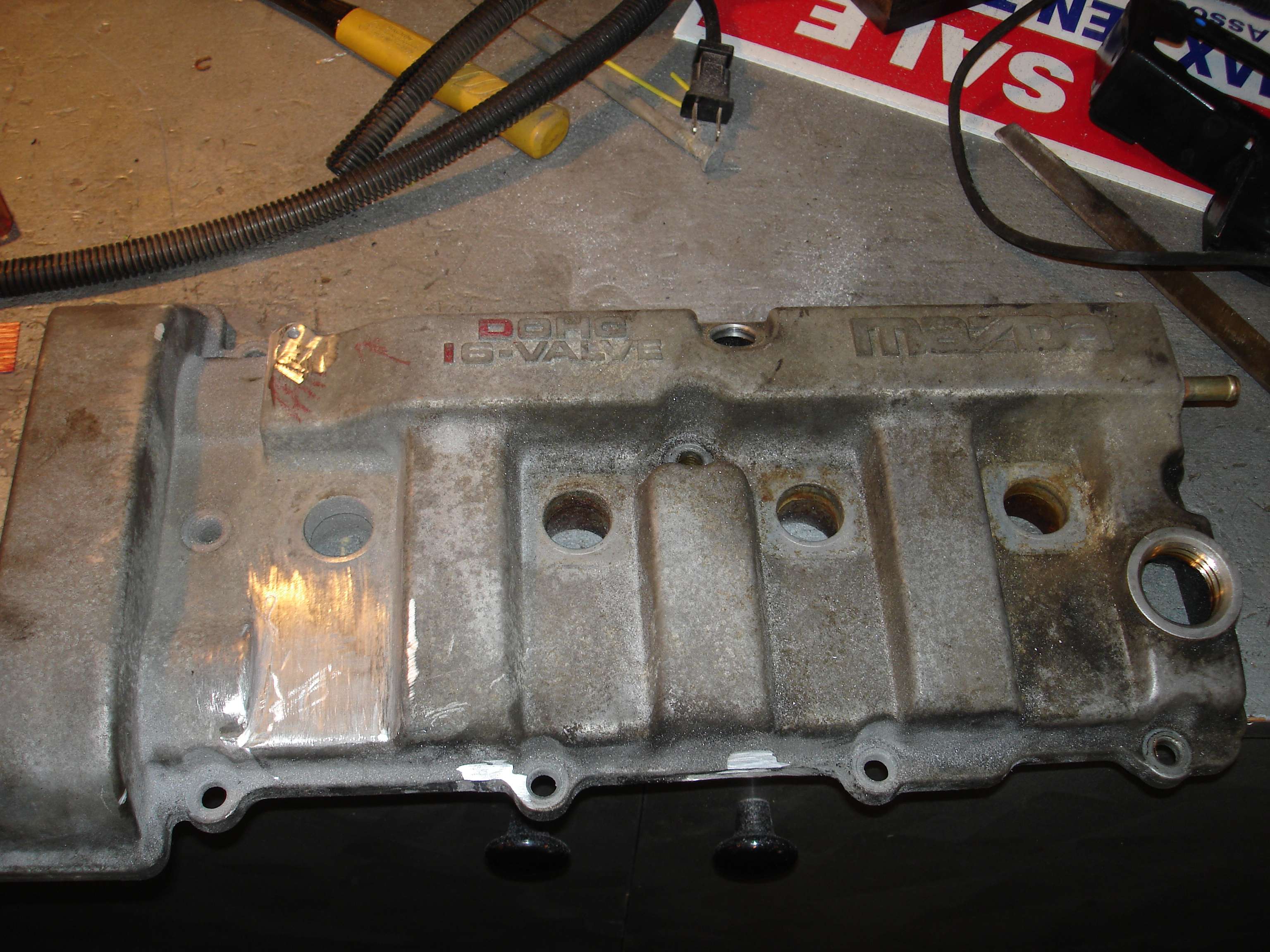

FunkyBuddha hooked me up with a 626 valve cover. Since I no longer have any wires running over the valve cover whatsoever, I can remove the standoffs, as well as the two on the front edge of the cover:
Standoffs removed. The rearward one goes right through to the inside of the cover, so it's not possible to remove it completely, but I may weld it up and smooth it out tomorrow.

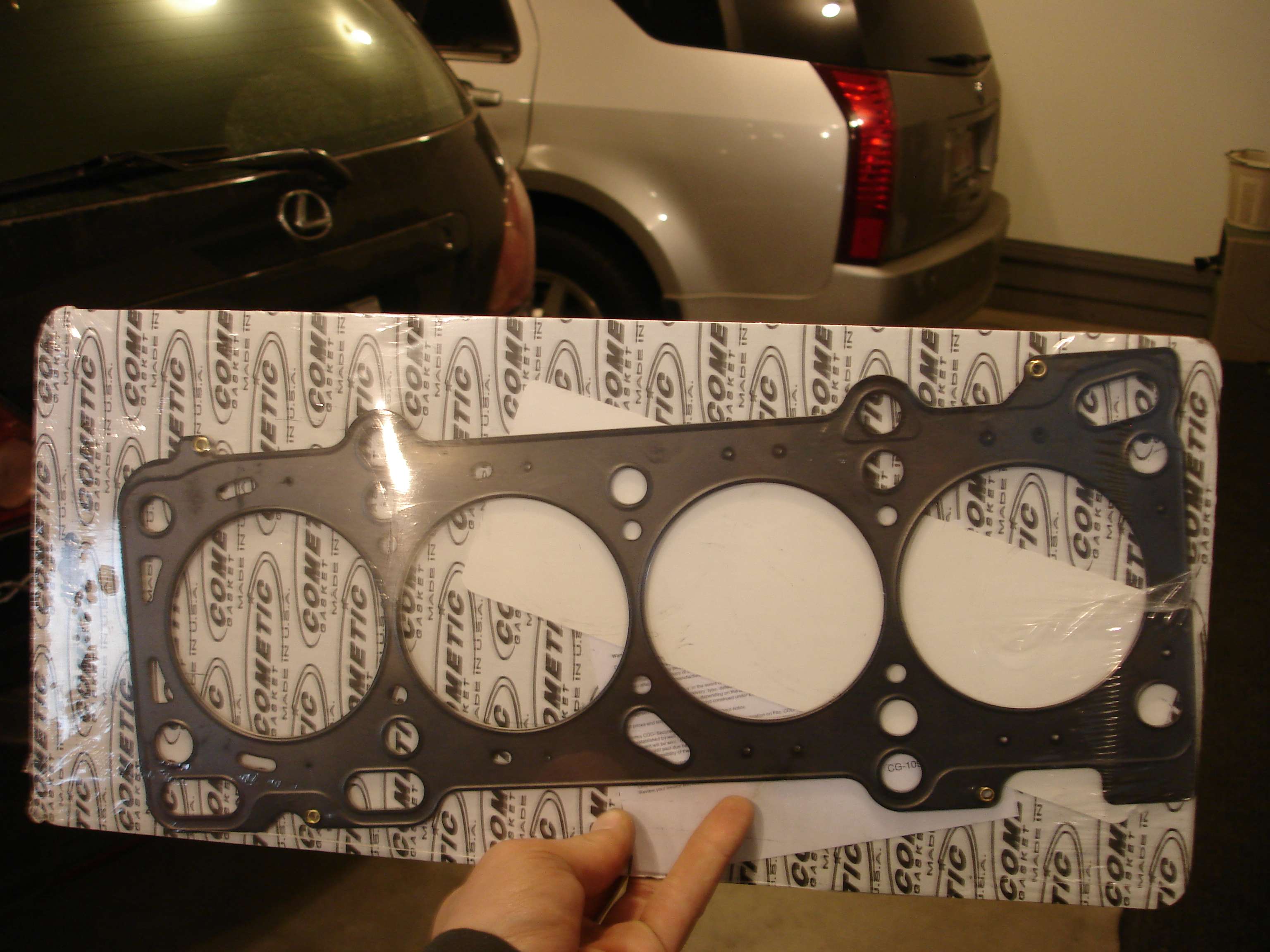

Picked up a Cometic head gasket while I was out today. 0.040" thickness.
