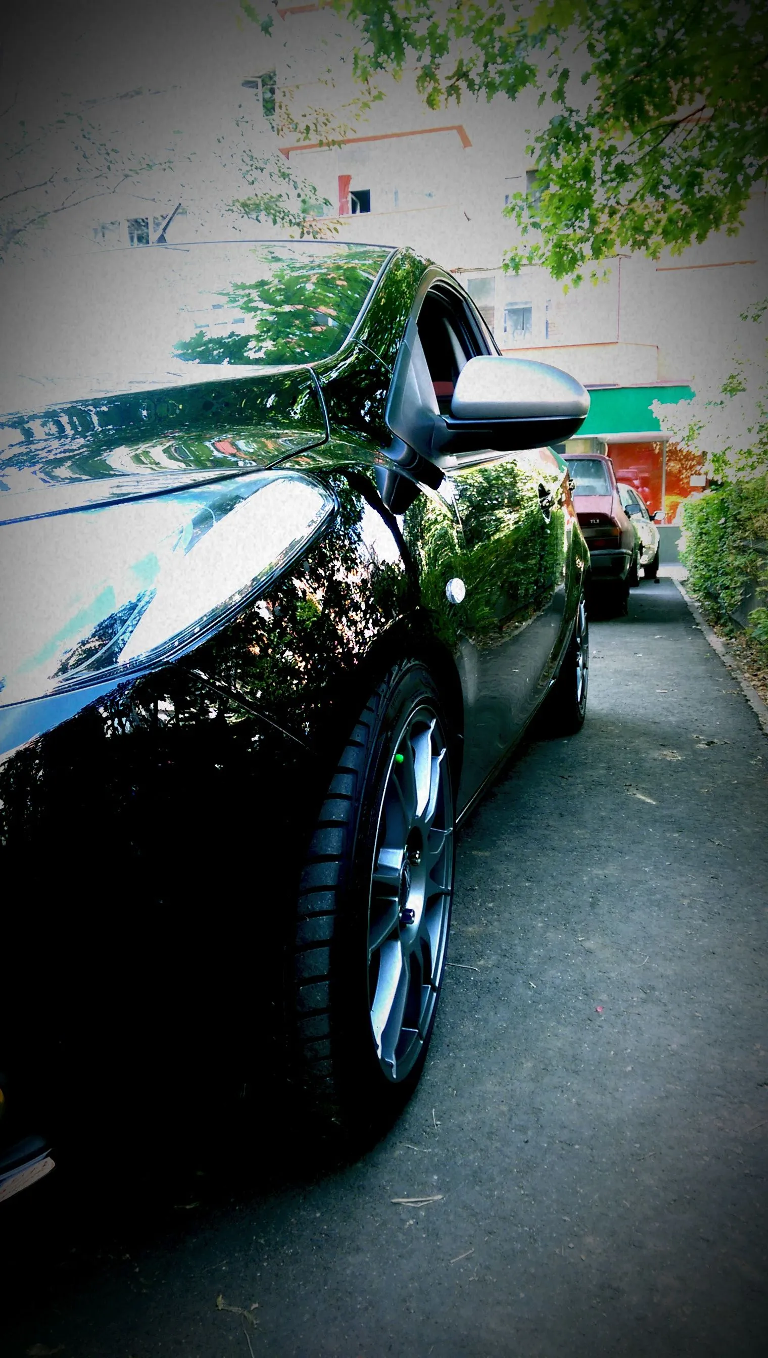

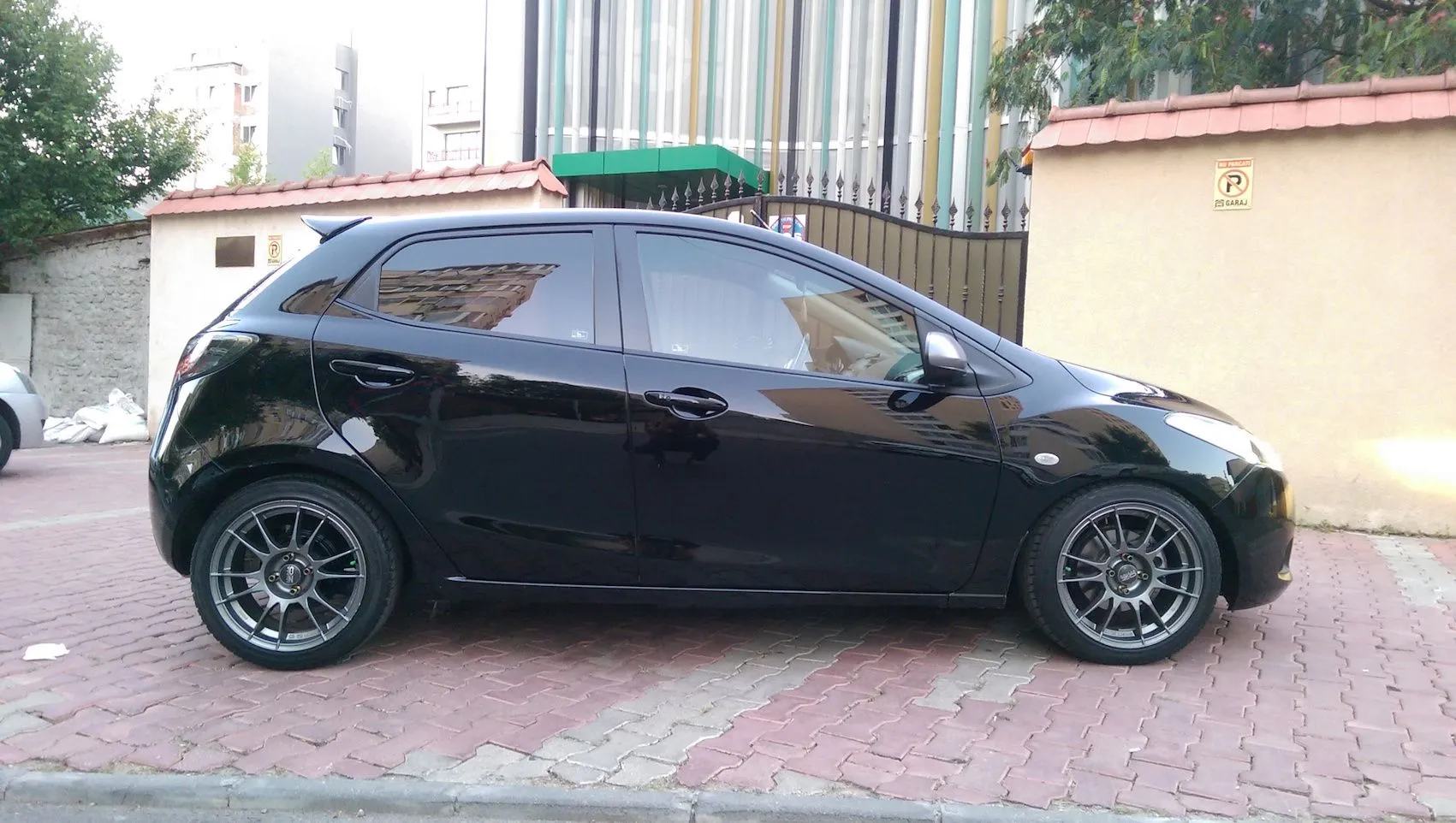

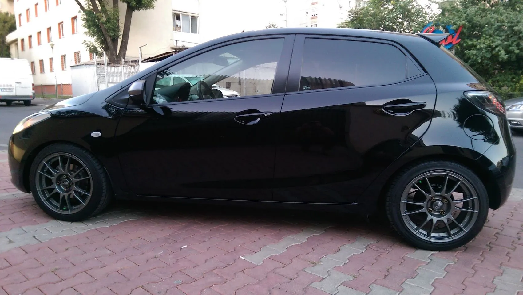

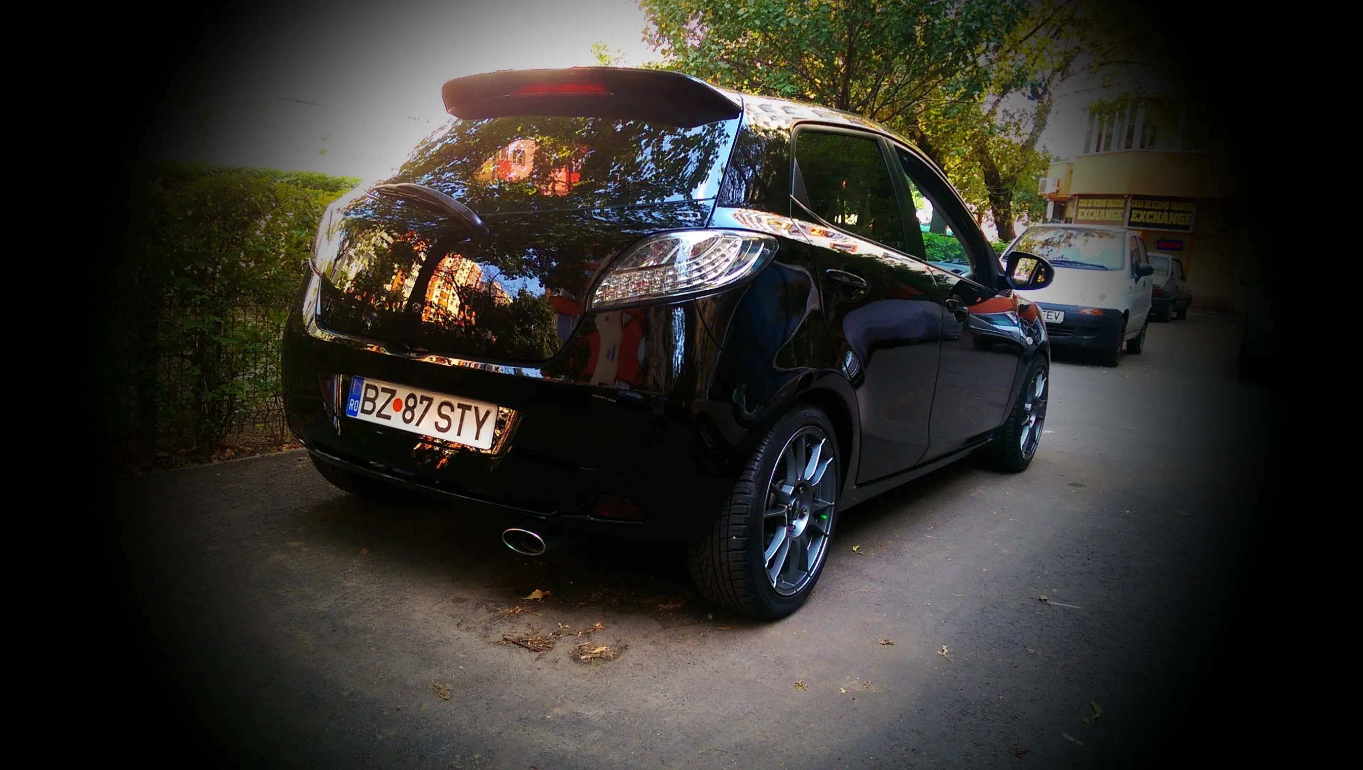

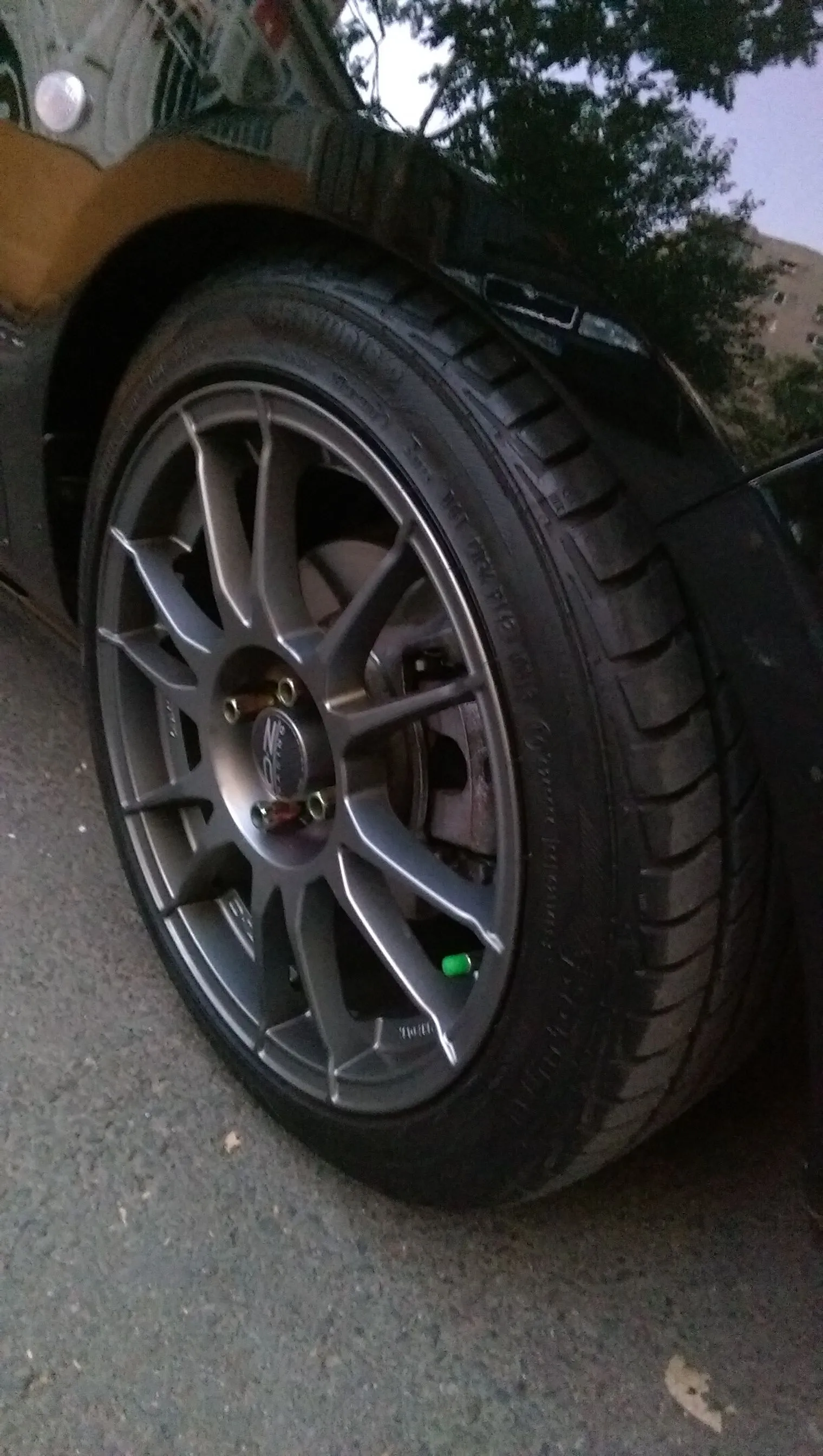

IMAG0370.webpIMAG0366.webpIMAG0370.webpIMAG0366.webpIMAG0356.webpIMAG0332.webpIMAG0333.webpThat's good. I have the same width 16x7 oz ultrallegera wheels but my tire is 195/45/16 so if i attach a 15 mm spacer it will be no problem. I have a coilover set from AP, and the dropping is no more than 30 mm on the back from the stock.

From eyeballing, without knowing the offset of those, a 15mm space would be ideal. Do as inspekt did, and go with a bolt-on spacer though, the slip-ons may cause problems with a spacer that big. Looks good though. (nana)
