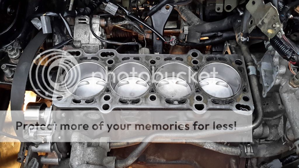

You'll have to be very careful with the depth. That's another reason to go with a ball hone, you won't hurt the jet if you snag it.
It's not a huge deal if you can't reach all the way to the bottom, you only need to run the hone where the rings contact the cylinder wall.
I wouldn't worry about the oil pan. If you paint it, there is a good chance of it flaking off and clogging the oil pickup. It'll never rust while submerged in oil anyway.
Thanks for the quick reply! Moment of panic... LOL. I had a closer look at the situation and I see that the oil squirter is in the protected zone below the piston travel - I will plunge carefully with the ball hone then. The machinist was recommending protecting the crankshaft with a rag but since it is defended by the oil squirter and I can rotate the crank to a lower position for each cylinder I won't bother.
The new head bolts will be shorter because they haven't been stretched yet. The length specified in the service manual is for the reuse of bolts that have already been torqued. Do not paint your oil pan inside.
Thanks!!! That's what I was hoping re the head bolts. Cylinders honed - no casualties! Weird mark in #4 gone - YAY! Off to get some dino oil and more brake clean... gawd that stuff goes by quick. Then more cleaning to do...

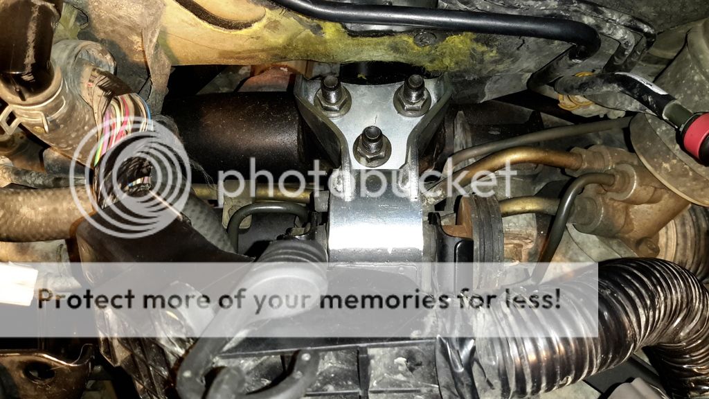

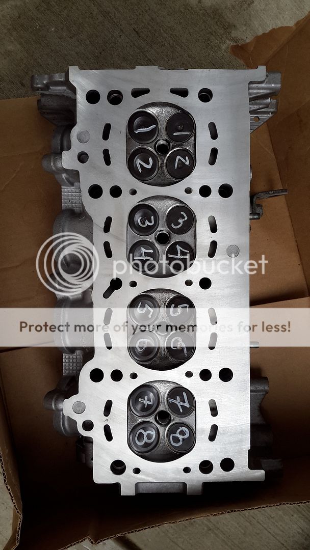

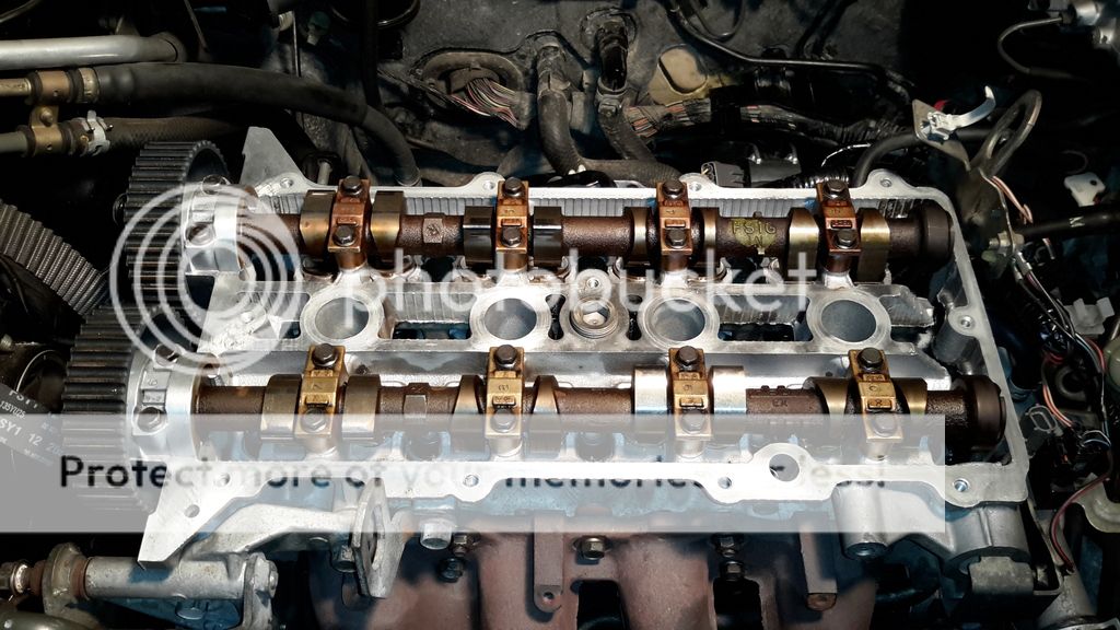

Ahhh yes... thanks for asking! Work in progress, sidetracked by life a little. Had to give back the loaner truck today so the pressure is on to get my ride back in order. So far got the cylinders honed; pistons installed; bell housing to block re-mated; lower and upper oil pans forensically cleaned, siliconed and reinstalled; head installed/torques - holy crap that was a fun job! (rolleyes) ; lifters, cams, caps and sprockets installed; starter taken apart, cleaned and reinstalled; exhaust manifold/CAT reinstalled, various hoses, bolts fittings reconnected.... AND the rear engine mount from hell FINALLY installed after carrying the darn thing around for 6 months. It was torn too so glad I won. Changed the first three (two were torn) with zero difficulty, but kept getting stumped on the lower 10mm nut from the electrical bracket - what a dumb ass design! They totally could have moved that bracket over so the lower bracket stud was in the middle (and well above) between the two engine bolt studs/nuts adjacent to the firewall. Tried bending the stud out of the way to get on the affected 17mm nut but ended up rounding the nut so in the end I cut the offending stud off with a hack saw... may it RIP. The torque on the last nut was particularly difficult to break despite repeated and prolonged soaking and I didn't want to risk pooching it further. The upper nut will have to take the load of the wiring harness from here on in.
Tomorrow it's intake and timing... and all the other remaining bits and pieces... fingers crossed I can run it and if so no issues. Looking forward to tearing down the road and seating those new rings! AND hopefully finding that my oil is not all departing out the exhaust anymore - or anywhere else for that matter.
