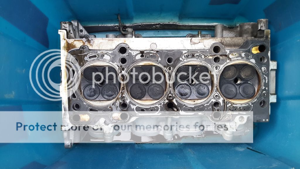

Head is off - taking it over to a machine shop for estimate and possible rebuild tomorrow. Aside from the buildup on the pistons which looks to be recent, and worst on #4 don't the pistons and the walls look pretty good? I did put seafoam in both the oil and the gas recently (half a can in each) so not sure if that made any difference in what we see here. The valves and the underside of the head looked pretty awful though (or is this normal?).

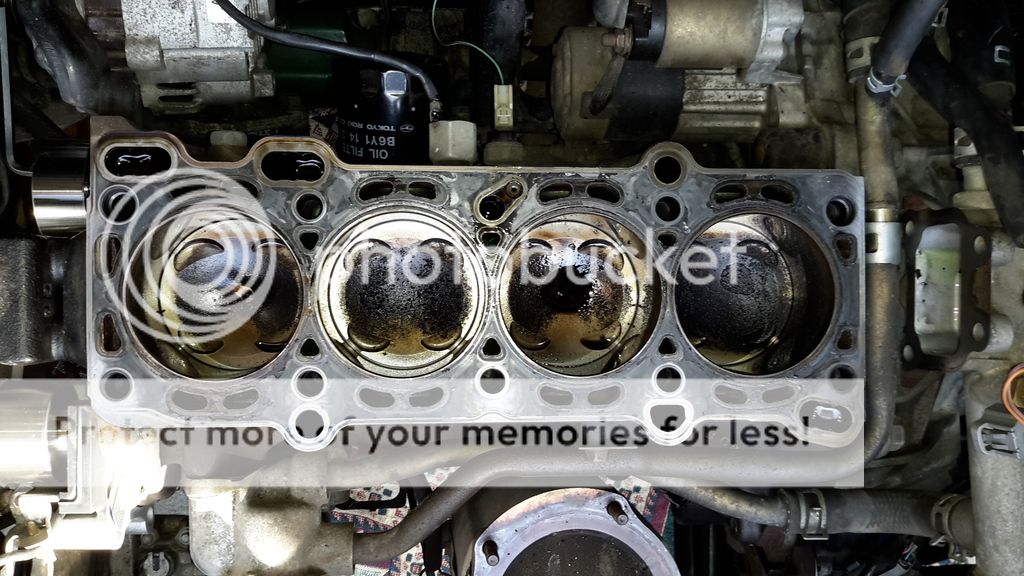

Cyl #1 is on the left in the below picture....

Nope. Seals are fine - machine shop has the head right now for disassembly, cleaning, another vacuum check post-cleaning to verify the valves and very light machining. A couple of valves on #2 cyl weren't sealing 100% but all 16 valves are really carboned up. I'm sure they will work much more efficiently post-cleaning. It seems like I really lucked out with this machine shop - very helpful guy heard out my whole story from start to finish, was genuinely interested in the service information/troubleshooting process. He gave some really great information, explained in detail with live samples how some things worked a little differently than I thought and unlike one of the other shops I talked to was very up on the exact specs/tolerance numbers - like they care. Gave me some good pointers for honing/pistons/rings etc. I'm looking forward to getting the pistons out to check the condition of the rings.

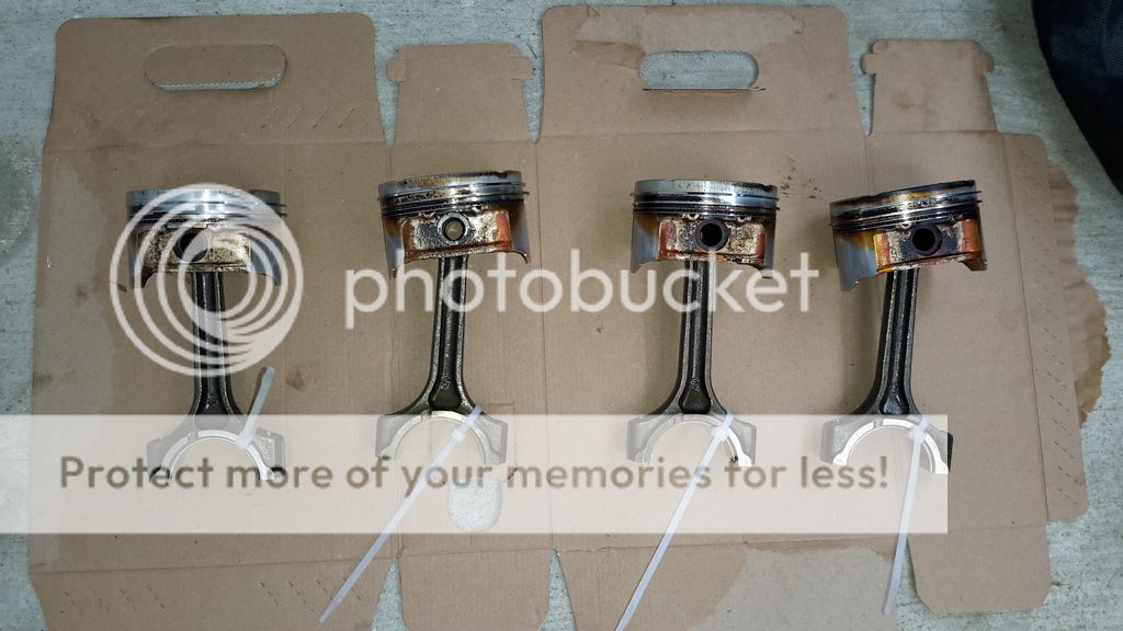

Got the pistons out this morning (after I built a tarp tent in the pouring rain!), and over to the machine shop for inspection/advice. The mission was fairly uneventful, but glad I got the 3/8 drive socket instead of the 1/4" drive (12 point 10mm) as I had to upsize to 1/2" drive ratchet for a better pull.
Aftermarket rings ordered and should be here tomorrow but I'm going to have to dig around for some cash - still need all the gaskets/oil, cylinder head bots etc. and it's starting to add up. I think my upper O2 sensor is failing too from all the abuse but that one is going to have to wait.
After everyone's comments, and after the input from the machine shop I'm switching back to dino oil.

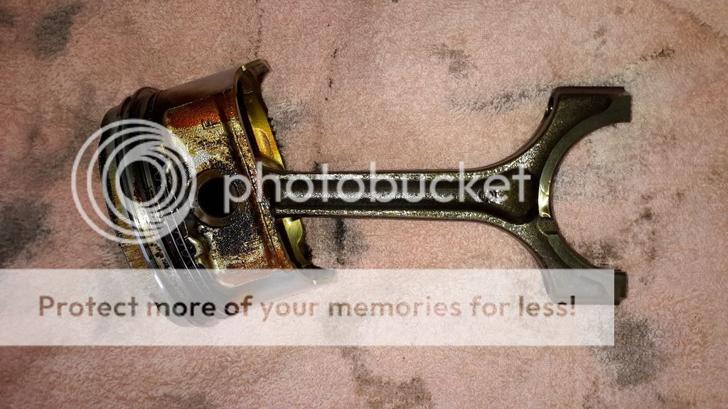

Ring state: The last ring (3-ring combo) on #4 cyl was seized, same ring on a couple of other cylinders stiff but none broken. Apparently the wear on the shims (if that's what those are called) is minimal. I'm going to soak the pistons in carb cleaner and clean out the grooves - then I can ask the fellow at the machine shop to put them on for me when I pick up the rest of the parts. LOL he was going to lend me the ring pliers/compressor tool but this way he can get rid of me faster and then I'll know they're on right... ;)
The machinist did a really nice job on the head/valves but he said it took a long time to get the carbon off - it was really burnt on apparently. Valve guides and seals all fine. Another time (hopefully many months from now!) I'll maybe pull the head and do the valve grind/adjustment but since the head doesn't appear to be the culprit for the oil issue and given my budget he figured it wasn't necessary to get the car back on the road. The intake side is sealing 100% and the exhaust side not quite as good but he figured it would be fine under operating power.
Cylinder bores all look ok, except for an odd mark on Cyl #4 that I thought was quite concerning. I'm going to check it over more thoroughly in the morning now that I've had my debrief from the machinist and with any luck it will turn out to be nothing.

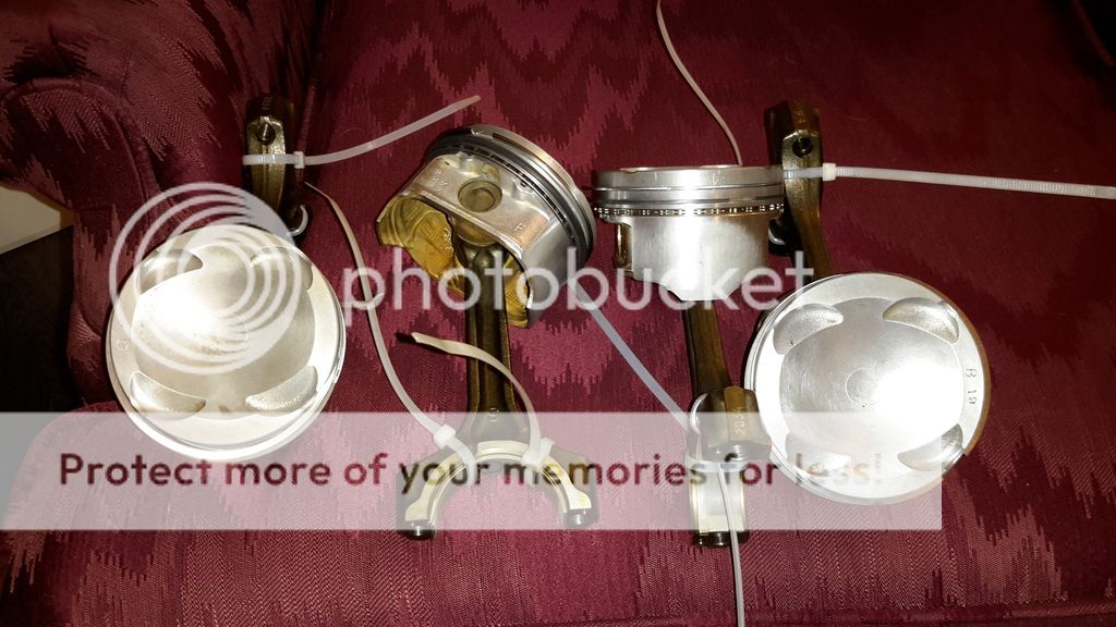

Well, scraped a bit of cash together and picked up some of my parts today... very excited to see my new piston rings (NPR) installed! LOL, first time and all... The machinist was kind enough to lend me a set of honing stones with instructions, so that is tomorrow's project. As well he lent me a piston ring compressor, also with instructions so I'm looking forward to getting these babies back in the appropriate holes as well.
I'm very grateful for all the reassembly tips and answers to my many questions, and I'm trying to feel a little guilty over asking so many... ;). One of the biggest mistakes I might have made had I not been so inquisitive was during reassembly. Apparently when reassembling the shims to the piston ends/caps it is imperative no oil get between the shim and piston ends/caps - only a bit of oil should go on the crank side of the shims. Apparently many engines have been ruined by oiling everything!
The before...
The bling...
