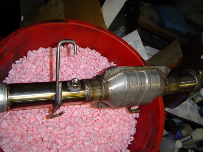

What is the O2 sensor bung on the midpipe for?
I only have 2 O2 sensors .. and both are on my header right now...
I can post pics if you want.. just gotta shrink em
added pics.

I think I know what happened.. they sent me one with the extra O2 bung welded in..
"ll of our midpipes come with a flex joint,rear gasket and new hardware.
The midpipe bolts between the J-pipe and catback.All midpipes are 2.5" and come in either Aluminized Mild Steel or Stainless steel.
If you have an MSP or would like an extra O2 bung, it's $10 extra."
****.. what do I do now? Take it to an exhaust shop and have it welded closed?
I guess he thought I had the MSP? Dunno..
Hope it doesnt cost much to get it fixed.
oh s*** i forgot the time difference... i was like how the **** do you expect to install this at 4AM...LOL
go to the autoparts store and see if they have a plug that will just screw into that bung. i would assume they would have something.
don't weld it, you may get a WB in the future, or sell it, and then you'd be kicking yourself.
its an 18mm (1.25 thread I think), just plug it or throw in an old spark plug
yea you can get the plug for cheap, i'm sure beau has one he can send you
I went to Checkers Auto Parts and bought an 18mm oil drain plug.. fits like it was meant to be there...
