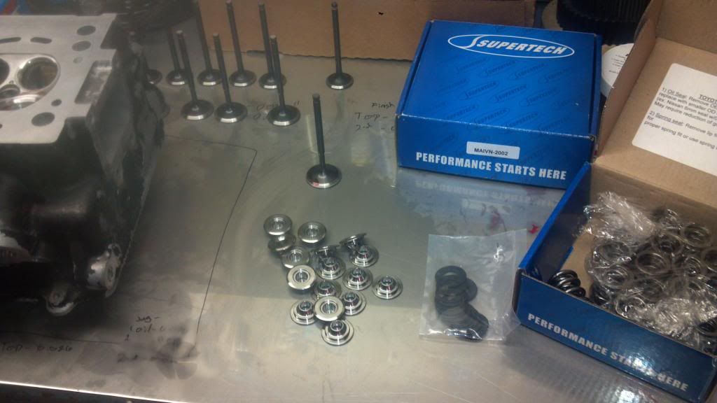

Super tech dual springs
Super tech ti retainers
Super tech Valves

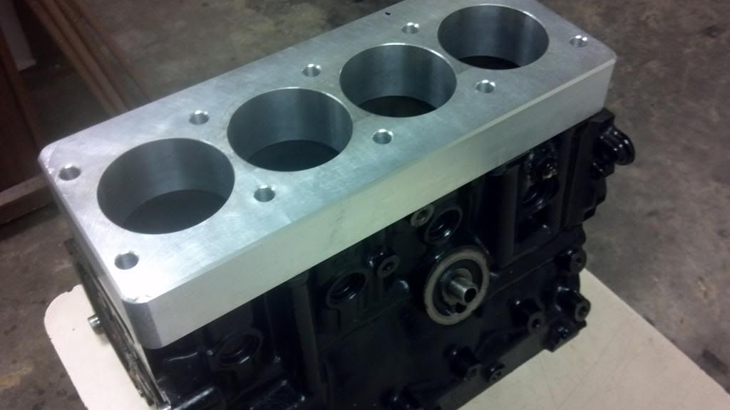

Torque plate I made.

SuperTech Goodies

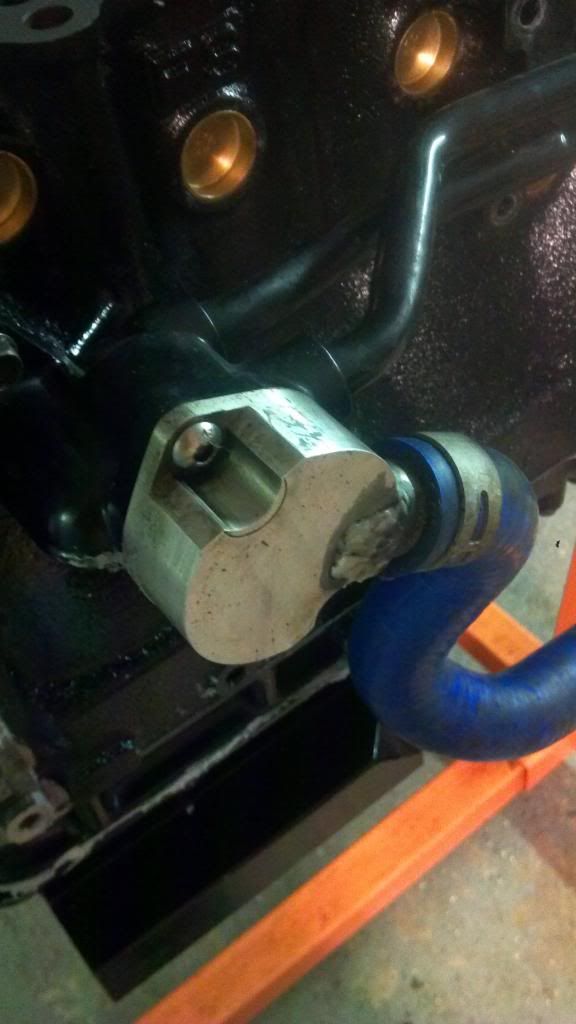

Made this little guy

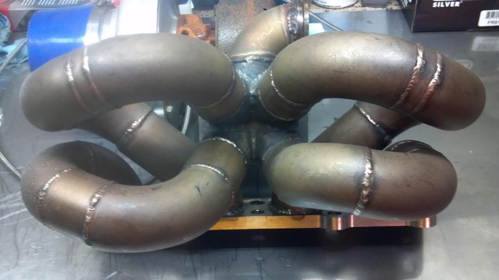

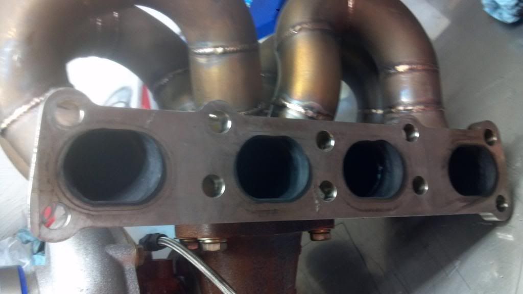

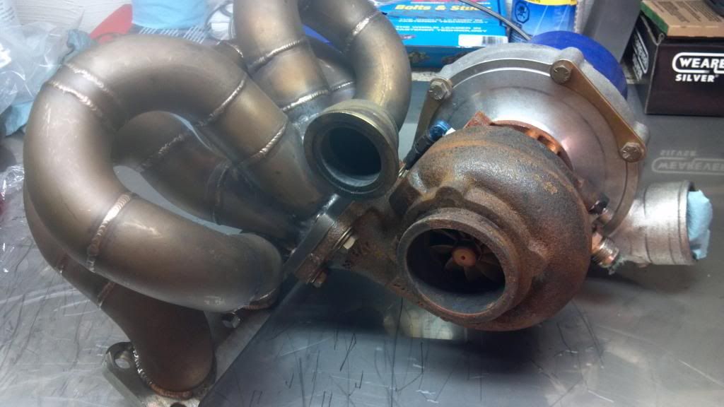

Turbo set up wouldn't fit with the stock one so this rerouted things around.

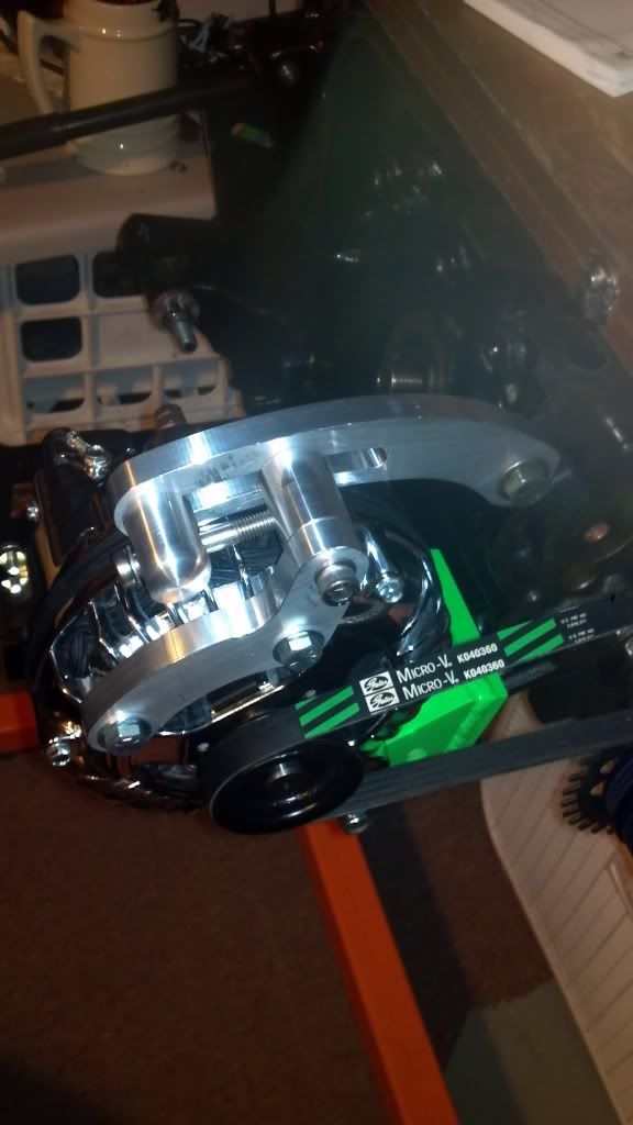

One wire alternator and brackets
Excuse my ignorance, but what is a tourque plate?

Torque plates prevent distortion the bore undergoes when the head + gasket are torqued onto the block :)
Torque plates simulate the distortion allowing for a better hone. Prolly some finer points I don't know but essentially thats it.
Yup, that pretty much sums it up thanks!

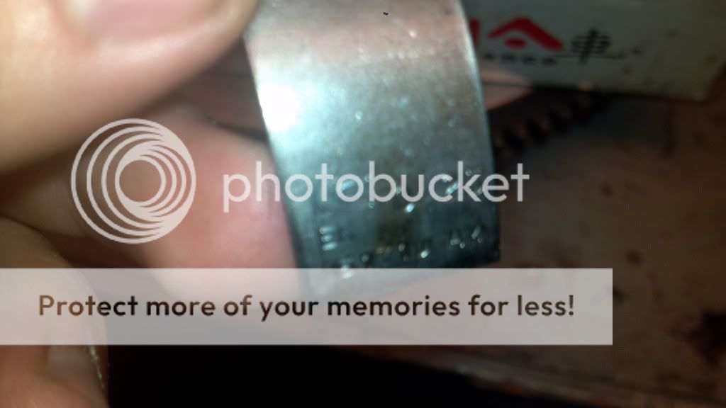

Something I thought was intresting was that these togas bearing i used to run were stamped with the king bearing logo. Which after measuring that oil pump I had is are these even a " preformance" bearing or just an oem replacement? Ill be running clevites this next season and hopefully these hold up better. I wish Acl would make some bearings for this platform.
One wire alternator and brackets pictures added. Currently wrapping up on the electrical system and will post pics when finished.
