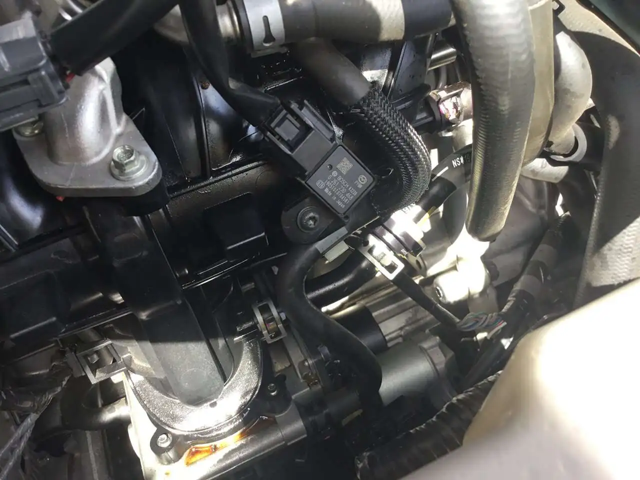

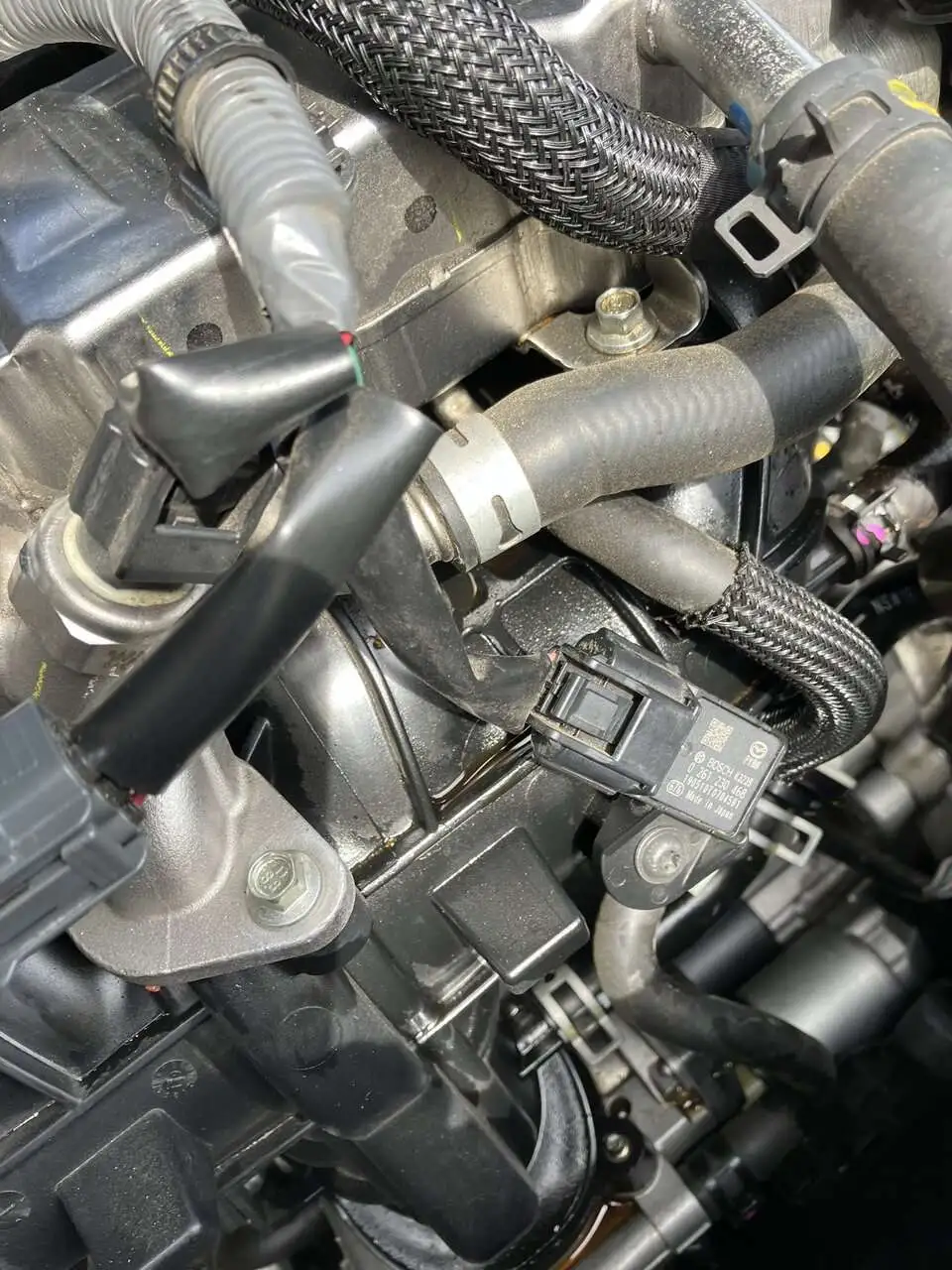

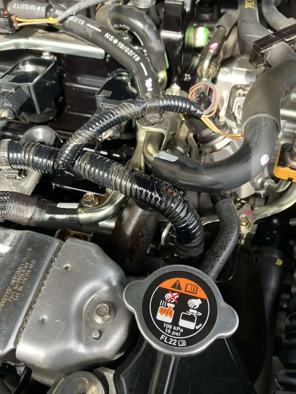

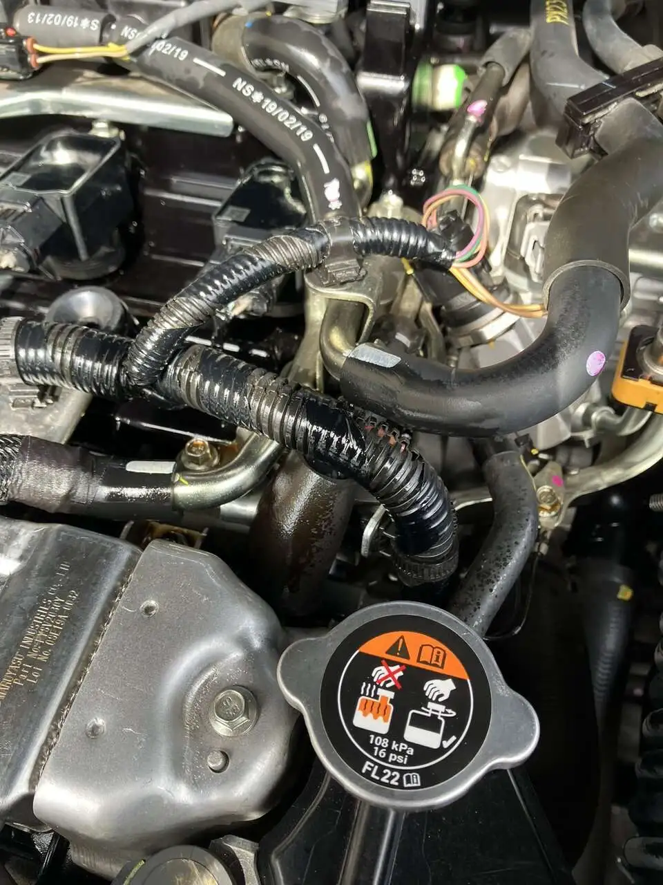

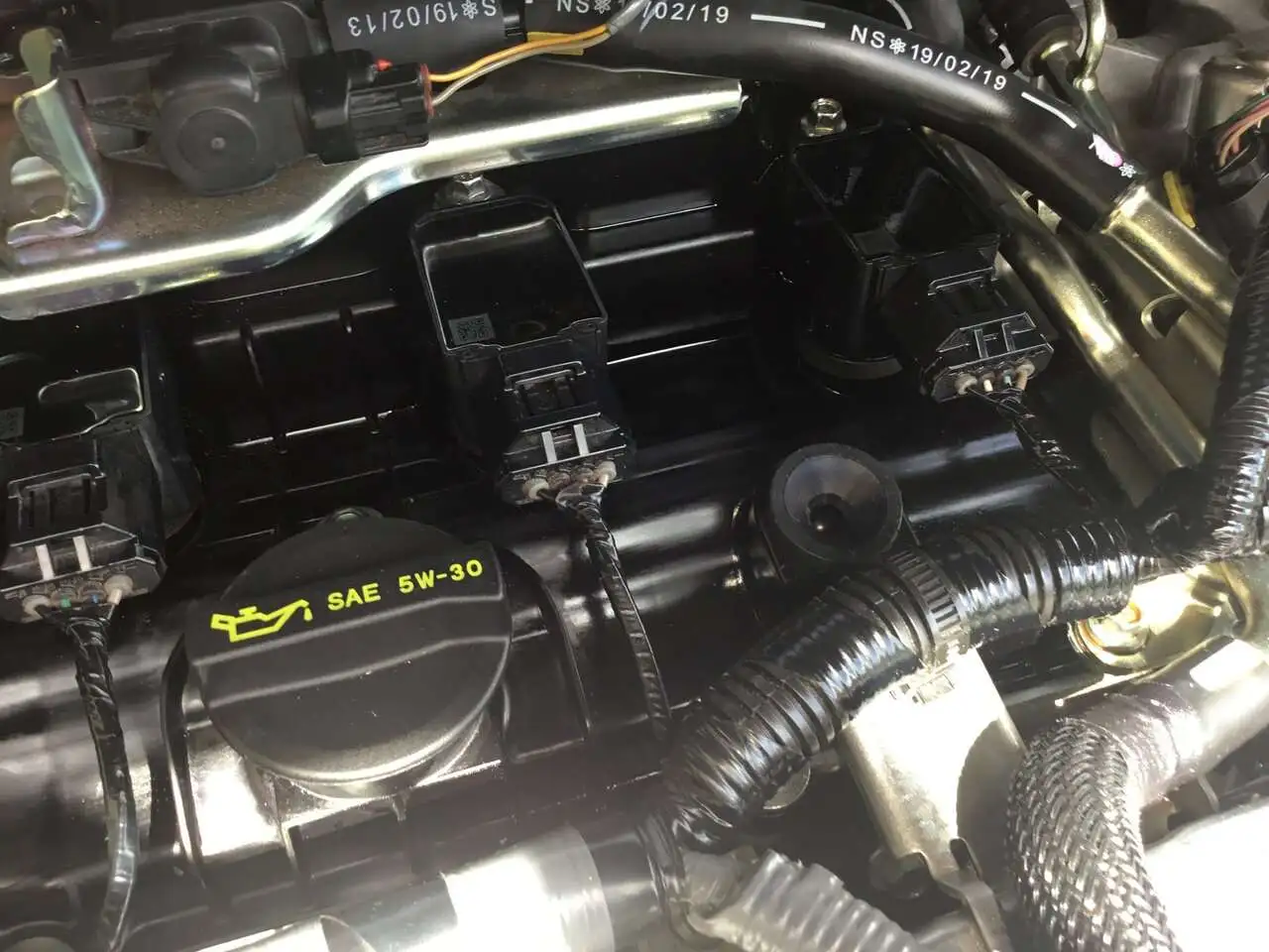

As the title states…my Mazda Dealer replaced the valve cover assembly on my 2019 CX-5 Signature last week (6/28/22). I noticed some oil on top of the (driver side) valve cover when I got home and wiped it off with a rag. I chalked it up to sloppy work by the technician. After I drove the car a couple of days later, I popped off the engine cover to check if there actually was a leak or if it was just oil from a sloppy valve cover installation. Unfortunately it was a fairly major oil leak. I’ll attach pictures below…and the car is back at the Dealer (7/2/22) to assess what went wrong and what they need to do in order to fix the problem. I started this thread to see if anyone has any ideas as to what might have gone wrong with the valve cover swap…and to let everyone (that is interested) know what ends up being done to correct the problem. My first thought was that maybe they failed to install the center gasket? Thanks for any help/comments…

Curious what was the reason of the replacement in the first place?
The Oil Control Valve seal/gasket was leaking. Originally the Dealer informed me that they were going to replace the seal and the valve cover gaskets…but they ended up replacing the entire valve cover and gaskets instead. Now the leak is 20x what it was…

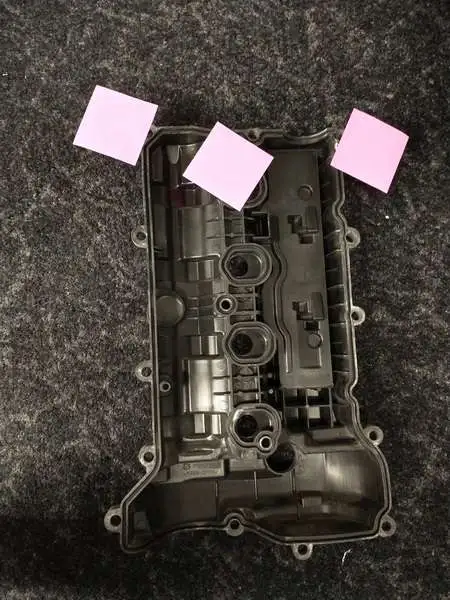

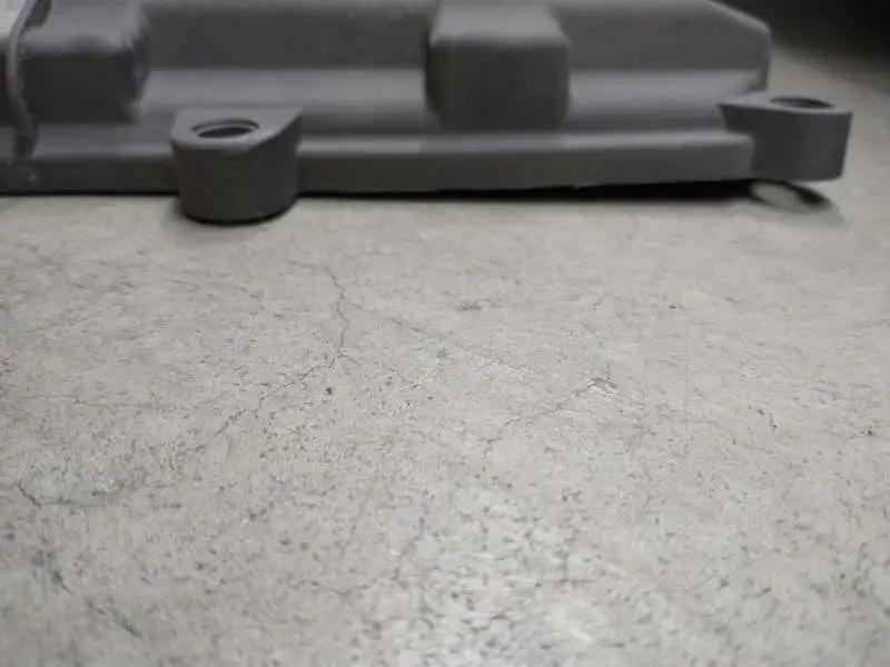

There are 4 areas on a valve cover gasket that IMHO must have sealer and not just the gasket alone.
MAZDA valve covers went through a manufacturing phase that some had a tendency to warp. Not suggesting that you valve cover did! I am not aware of any *TSBs but MAZDA did correct the problem with a newer valve cover design.
MY "guess" and only a guess is that the dealer service tech followed the FSM and, on your model, there may have been no indication needing sealer in some areas of the valve cover. In this case I don't really see it was a sloppy service and I know that that dealership will take care of you!

A basic step for any gasket job like this one is to completely examine the entire mating surface for even the slightest bit of wetness, with the vehicle having been completely warmed up. Given the amount of oil in the posted pics, IMO there is no possible way the tech checked his/her work properly, because leaking like this would have showed up somewhere immediately, if they had been looking for it.

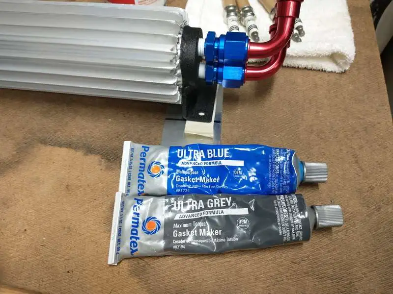

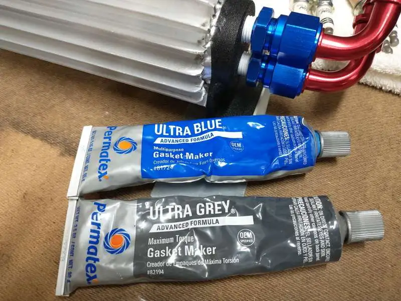

I went and took some pictures for you. I have a couple of spare valve cover s one is warped very bad. The other I place post-its where I personally place sealer. The recommended seal should be one of the 2 I posted. Most of the time I prefer the grey over the blue. Color preference really :LOL:
