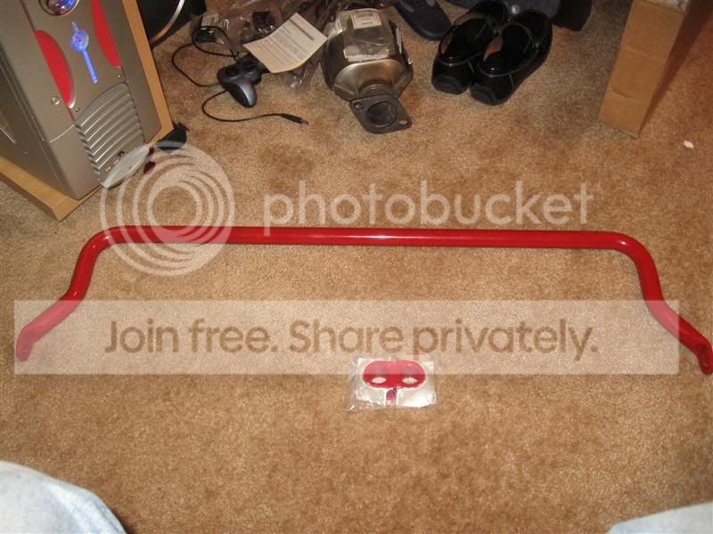

Racing Beat 1 1/8" front Sway (that thing is fat as hell):
Also in the background you can see the new Cat from http://www.finishlineperformance.com/ along with new valve cover gasket, and stock pedal covers

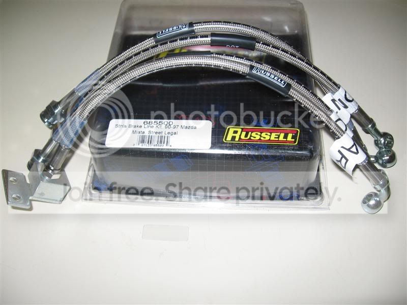

Russell Stainless braided brake lines:
