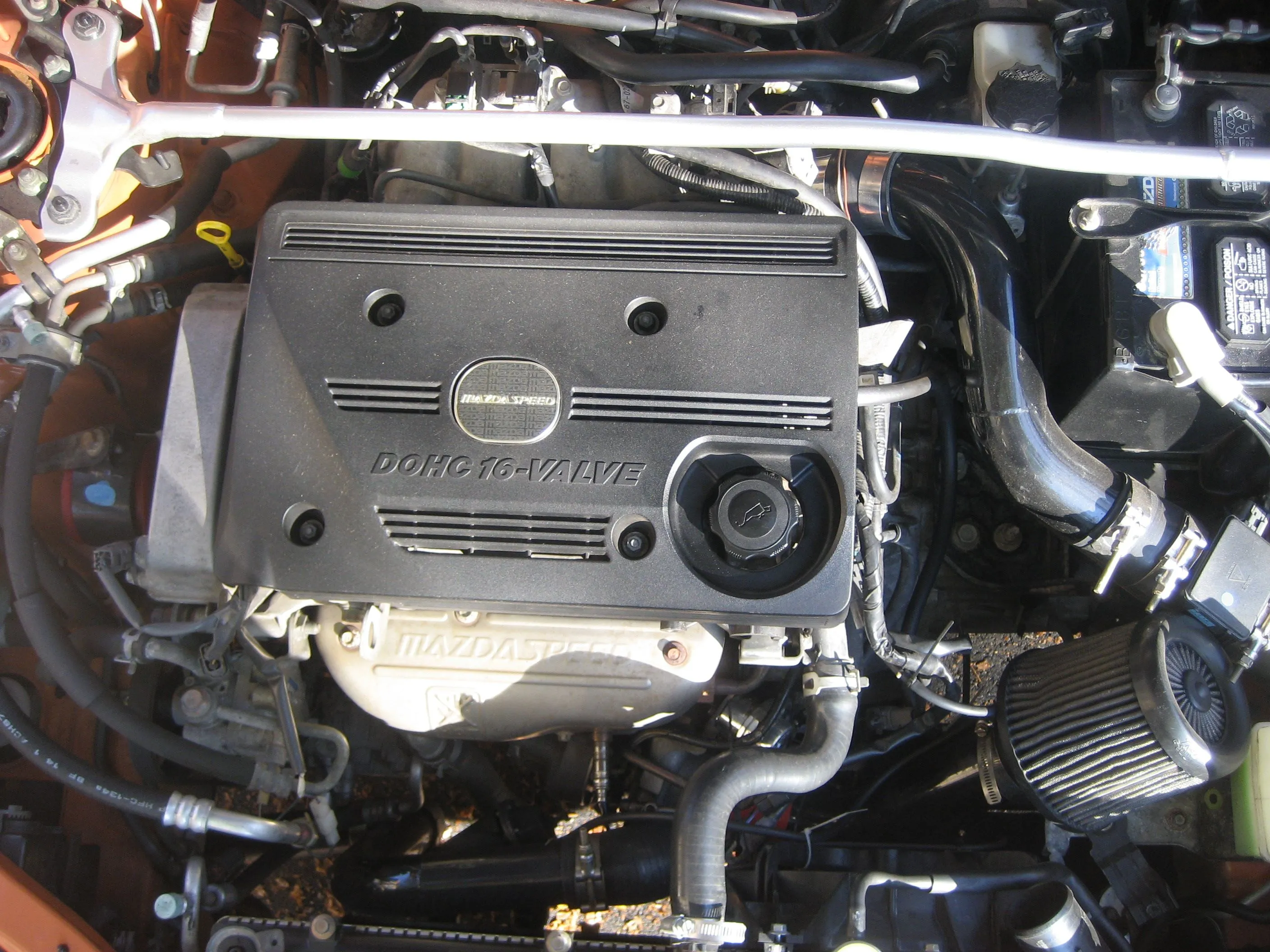

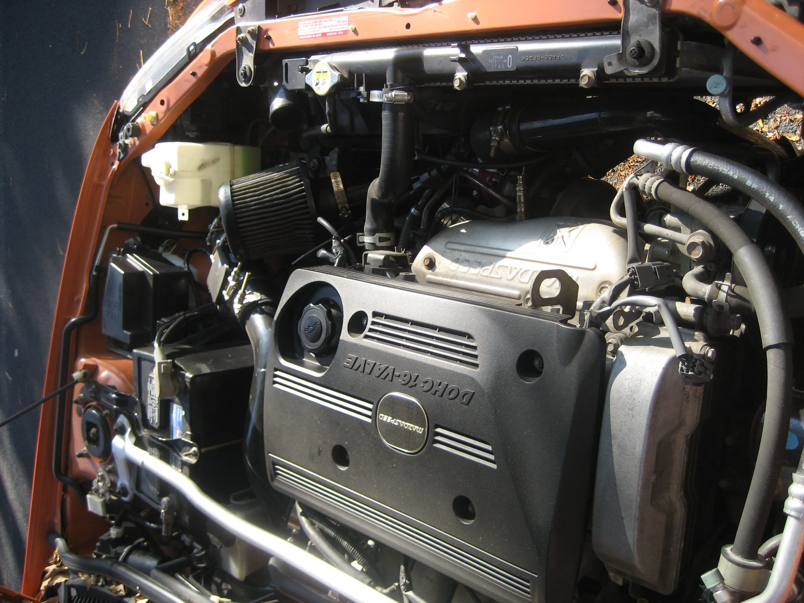

Ok here's some of mine.
Rush...I'm a bit suprised to find the lack of CF under your hood. It looks like you not the only one that had to do away with the AC fan with the MAM Hard pipes. I'll be clocking the turbo this coming spring to get that taken care of though.
She has the entire kit so I imagine she has some slim fans in there you can't see. The MAM kit originally came with two SPAL fans: one 12" puller to mount on the backside of the radiator and one 9" pusher to mount on the front of the A/C condensor.
Magnum's right -- I have the SPAL fans. You can just barely see the top edges of them in that pic.
And I purposely chose not to have CF in the engine bay .. cause I know that it eventually discolors thanks to all the heat. Figured I'd save myself the trouble and use the money elsewhere. ;)
