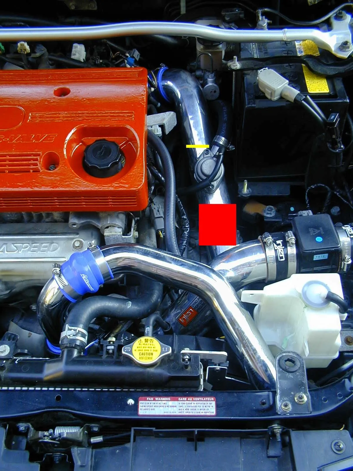

Here is an idea of what the MAF should look like. THis is my old setup. The BOV can be 6 - 12" down from there.

this is my setup... wow i just called mazda and they told me the reason my engine was loud was because my intake gasket was leaking... hmm
If you don't mind cutting you could remove the red box part (get the sections rewelded or use a coupler) to make a little room for the maf. I would make the cut for the maf on the yellow line. My maf comes right after the bov and it doesn't seem to affect how it reads.

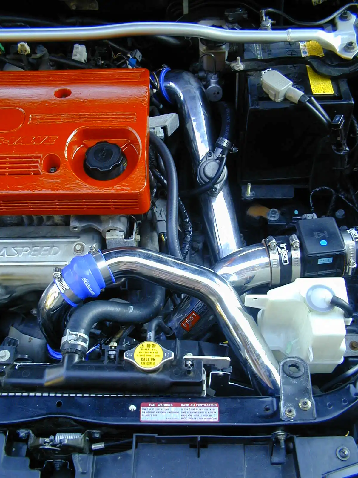

I personally wouldn't cut up that nice intercooler piping. If stalling is driving you nuts like it did me I can see why you would want to, but I would recirculate. There is also the fact that having the MAF on the pressure side is still being proven as a safe mod.
well i heard that it helped with even acceleration and the hks bpv tightened down HARD and then a turn and a half has almost no stalling AT ALL! so i think i will stick with the stock position for now

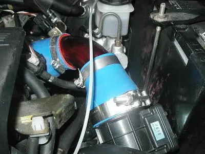

Today, I went to the gas station and when I got back into the car, I shifted into reverse and then I forgot about it. A few seconds later, I abruptly let out the clutch and the car ofcourse shook like mad as it stalled.
Before this the car ran stoich to lean, now all of a sudden it is running pig rich. The MAF is kinda pressed against the battery box. I am fearing that when I did that it smacked the battery and knocked it slightly out of cal. Hopefully the ECU will learn around this and start running normal in a few days.
