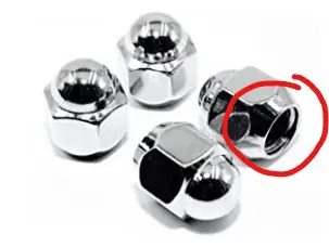

I have a 2018 CX-5 with the 19" factory wheels; I recently purchased a set of factory 19" wheels from a 2019 CX-5 to update my vehicle. The seller included a full set of lug nuts with the replacement wheels. The new lug nuts are "acorn" style, while the old ones on the vehicle have a bulge on the bottom. Just wondering if the acorn style ones are typically used on the newer model wheels, or if I should mount the new wheels with the bulge type lug nuts.
The Mazda lug nuts on the vehicles have been the same since early 2006 from all of the Mazda vehicles I've owned.
If you are going from 2018 OEM to 2019 OEM, I'd use the lugs you currently have. Not clear if the 2019 owner changed from stock.
Without pics, not quite sure what the differences are. Mazda's are supposed to use Acorn style lug nuts and I'm referring to the seat of the lug as opposed to the overall shape.
