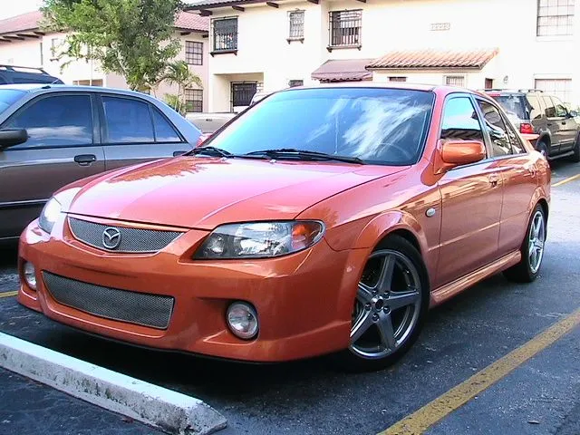

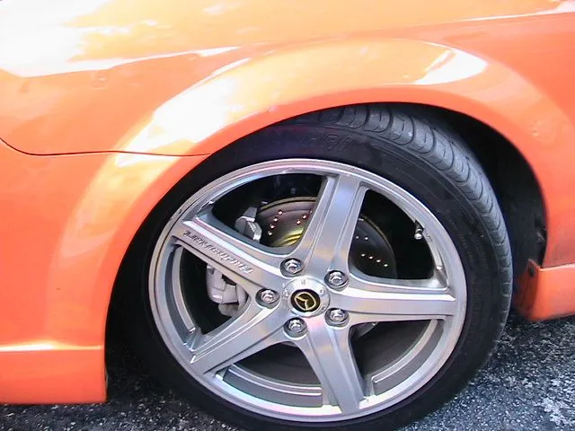

i just got a set of TEIN S-tech springs...will install this weekend...ill post before and after pics...i hear great things about em..
Just put my Eibach Pro-Kit's on about a week and a half ago. The ride is a bit stiffer but the handling difference is definately noticiable. Not to extreme of a drop which is nice and its only got a little bit of a rake. I had to get an alignment afterwards and the dealership couldn't get it perfect but got it damn close. Of course they also broke my front windsplitter in the process because the car was to low to get off of the alignment machin, lol.
just put on my tein's...drop is definitely noticeable and ride is nice...worth every penny
