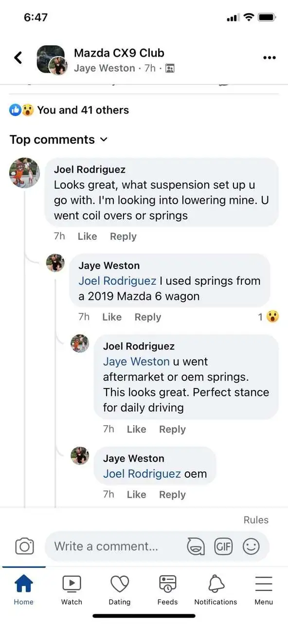

I know there was talk about this a while back, so it might be useful.....
Wow, that's over 1000 lb difference in curb weight! Surprising that it still rides nicely. It sounds like they did OEM CX-9 shocks with the OEM Mazda6 springs. I'm also wondering if they only swapped the springs and nothing else, like the lower seat and/or upper spring insulator.

Fair point. Might ride fine with just the driver. Should be roughly equivalent to loading a 6 at 1000 pounds. At CX-9 maximum load though, you’d be over the theoretical Mazda 6 spring load by 1400 pounds and I would not want to be in that vehicle

springs meant for a 3200lb car. gross of 4500lb. now on a 4400lb car gross of 6000. that thing is gonna bottom out and be a handling hazard on the street. needs stiffer springs.
