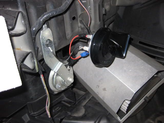

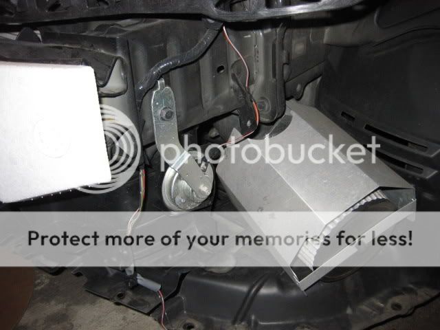

I'm off work this week (unpaid!) so I have some extra time and was in the mood for a car project. I remember seeing a thread about adding in a low tone horn to our cars, but after searching all I could find was a youtube clip about it. After watching the clip I went to autozone and for $17 bought a low tone horn. It is very easy to install, the only hard part is taking off your bumper. I had taken my bumper off once before for my CAI install, so I wasnt as hesitate about doing it again.
What I cant get over is right next to our factory horn there is a threaded hole that the low horn mounts perfectly into. Why didnt Mazda just put one there! Anyways, here are some pictures and clips of before and after, let me know if you have any questions. Thanks to retrobmx63 for posting the youtube video.
Factory horn
Horn before
Low tone horn added
