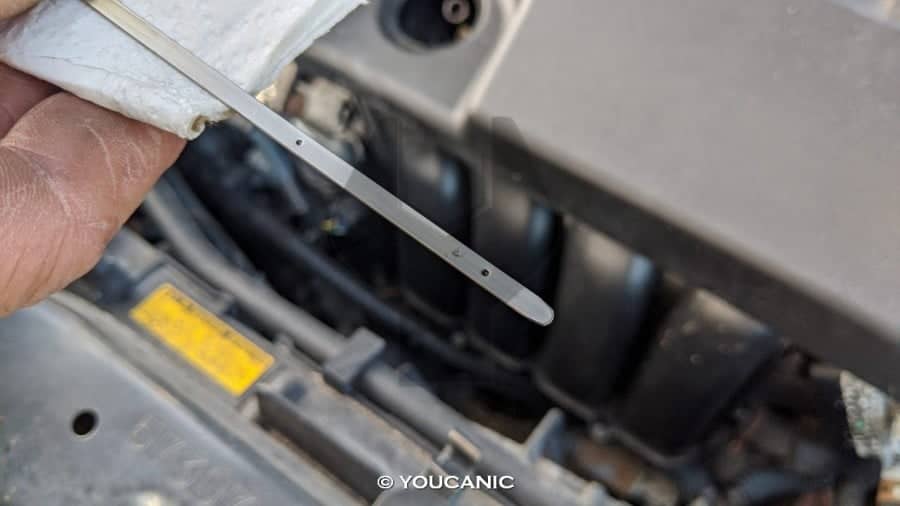

Another data point - 4098 miles since the last oil change, oil level is down 1/3rd quart. Still looks pretty clean too. Combination of suburban, freeway and city driving, in that order.
I saw my dealer and they suggested they do an oil consumption test. They will change oil and mark the level on the dip stick. They seal the dipstick so on one can add or subtract oil. They recheck the oil level over XXX miles. At what mileage do they recheck the oil level? Ed
I've never heard of a specific test for oil consumption. I always record the date and mileage for each oil change amd reference.
For the first time in my life, I took advantage of the dealer free oil change. I mentioned again about the add oil light but, turned down their oil consumption test. They changed the oil and next morning I checked the oil level and found it to be 7/16" above the full hole. I have not reduced the oil level and probable won't. This may be the way the dealer is avoiding excessive oil usage claims?
There is an oil consumption test but, getting information is difficult. Rummer(sp) is that it is a 2,000-mile test but, nothing in writing. If they start the test with an overfill, then the test is Bogus anyway.
Mazda is working on the excess oil consumption issue according to the factory. I found the consumption test and if your vehicle doesn't exceed 1,200 miles per quart, you don't have a problem=BS in my opinion. Ed
