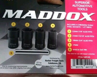

There are sockets made specifically for removing locking lugs. Many different one's available.
Example:
Something a little more unique or difficult may be enough of a deterrent to prevent wheel theft. Maybe the McGards @N7turbo is referencing fall into the "just enough" category.
Example:
So I looked at those.
They look like standard size sockets.
The thing about having "tuner" wheels is that the lug holes are very small, and standard size sockets don't fit in them. I also went with short lug nuts that don't stick out of the holes.
It's enough of a pain that unless someone is carrying the right tool, or a pair of these keys, they will probably not invest the time.
Not applicable to OEM setups, of course.
