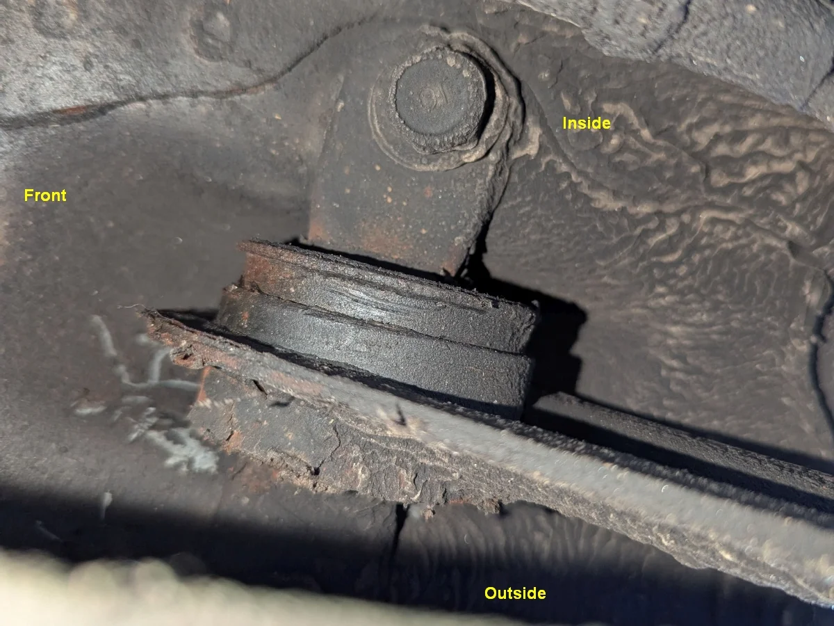

Trailing arm bushings look like they are no longer pressed all the way in (both sides similar)?
Is this typical/normal? Hard to find images online. Definitely some movement when I pry on them - I wonder if the traling arm is hitting the side of the unibody and clunking over bumps?
Yes, trailing arm bushings are known to go out. You can test by opening the hatch door and rocking the rear end left and right. If you hear quacking, it's them.
