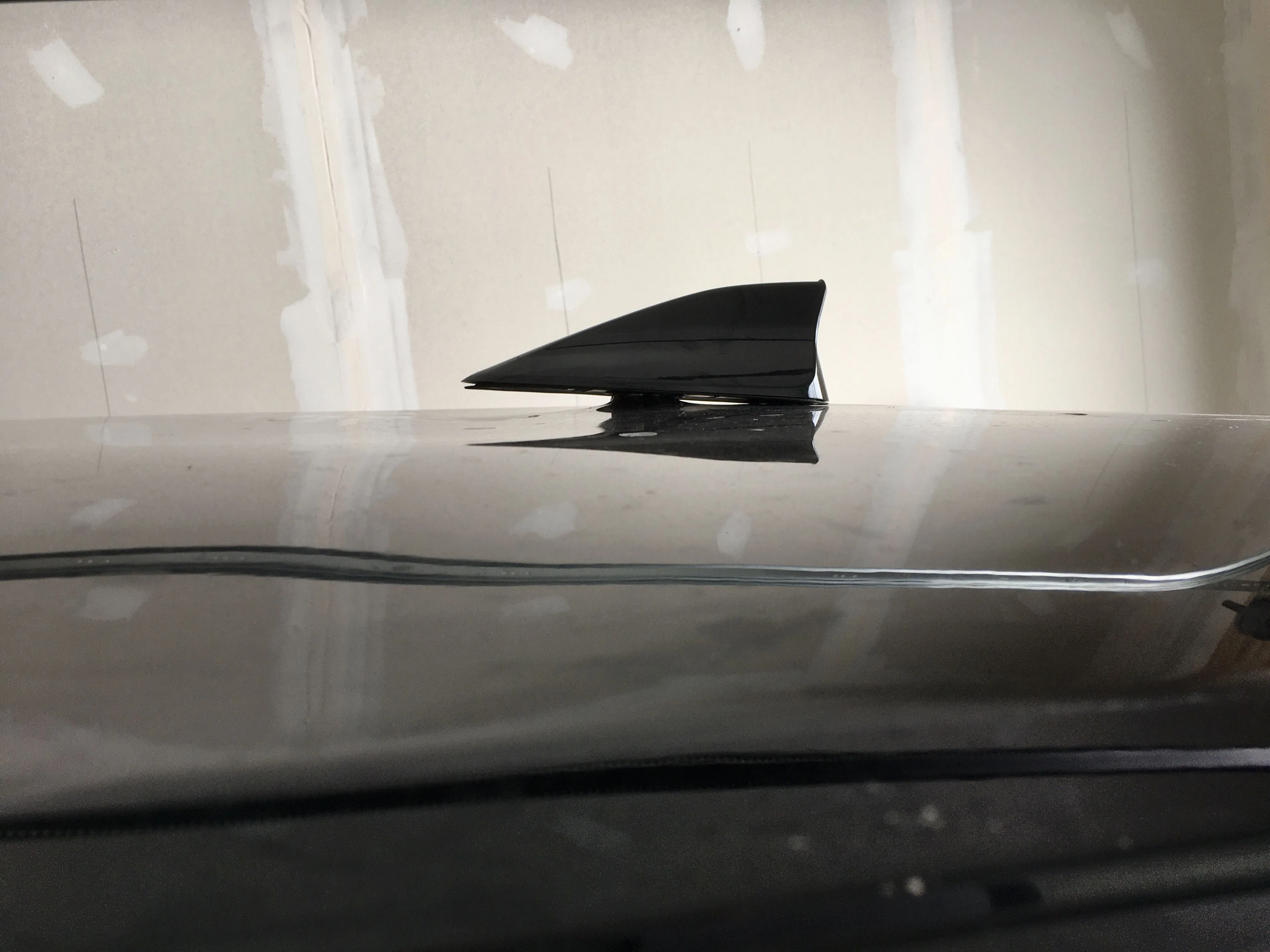

2019 CX 5 GT non turbo (Canadian Spec). While backing out of garage the antenna rammed the bottom of the overhead door. Now the roof has a dent (not too noticeable from afar). The shark fin antenna however is not sitting flush and is loose although still firmly attached (pic below). Basically the hit forced the antenna forward and down and pushed in the roof. The body shop estimates at least $2000-$2500 with roof repair plus antenna replacement. It's a all or nothing repair so they won't do just the antenna. I'm not too concerned about the roof having a dent as everything still works fine. I'm thinking to just leave the roof and deal with the antenna for now. Does anyone know if rain will get in below the fin and underneath the roof panel or if I go through a car wash? Also, any suggestions on temporarily fixing the loose fin (tape or caulking?) and maybe cover up the gap to prevent water leak and so I can use the car wash?

Yikes. I believe the fin is threaded/bolted into your roof. You might be able to remove it by rotating it counter clockwise, but if thread is damaged it could be hard thread it back in.
Try looking for one of the PDR guys that can try to work the dent out.
They may need to pull the head liner to get behind and can then determine if the fin can be bolted back down. Maybe purchase a replacement fin from an Auto Recycler before the PDR guy so he can maybe swap out while working the dent.

It looks like basically you need to unscrew the antenna and pound that sheet metal flat. Then reattach the antenna.
I would guess a body man might hold a heavy block under the damaged area. I don't know what they call them but they might be almost like a small anvil. Then hammer from the top to flatten the area.

First thing I would do is call my insurance adjuster and find out what my options are. Check with another recomended body shop. I am fairly sure you will get leaks if not fixed. If it were 5+ years old I'd caulk with a clear silicon caulk. For a new vehicle I'd fix it correctly. Ed
