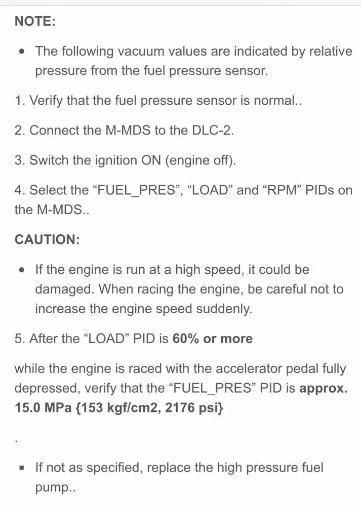

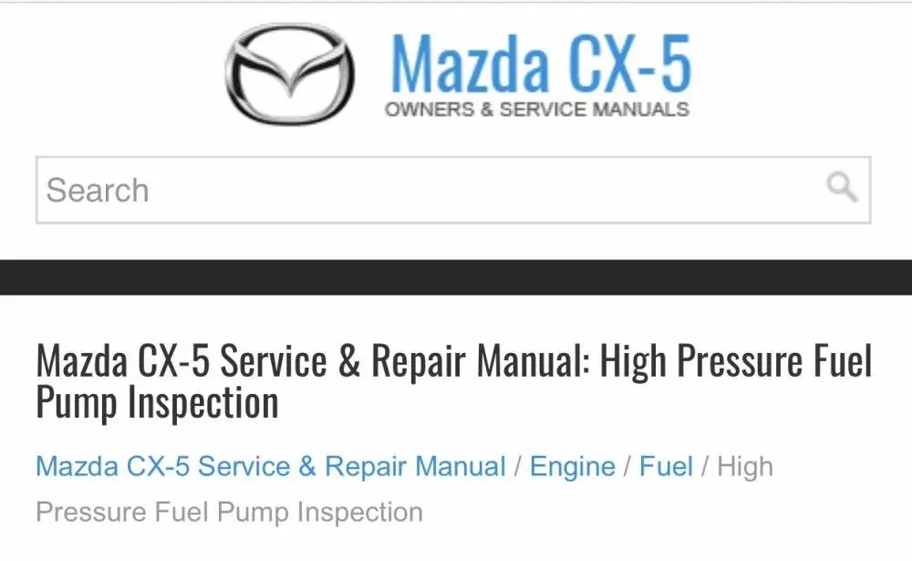

Stock fuel pump pressure: 1600-1800psi
Upgraded/ aftermarket pump pressure: 2100+psi
The high pressure fuel pump on Mazda’s SkyActiv-G 2.5L NA already has very high fuel pressure, rated at least 2176 psi with full throttle.

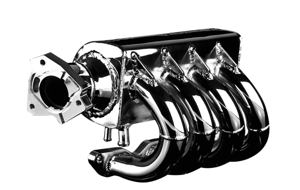

Just curious, for the intake, are you going to a custom fabricated sheet metal? Also, who are you getting to port your head? Who you choose to do it is the difference between making power and not. Choose wisely.

This is a custom sheet metal intake.
Something tells me you're not quite sure what you're trying to accomplish here. You may want to drop back, punt, and do some research, talk to engine builders, and get a cohesive plan together before you go spending a bunch of money on parts that won't work well together. A reputable engine builder will know exactly what you need to accomplish whatever your goals are.
