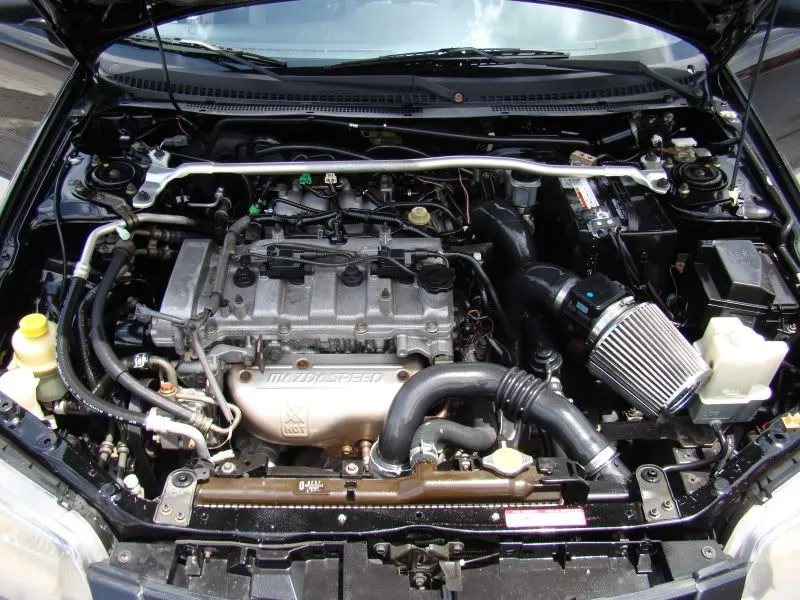

Engine Bay of MSP im considering
Hi everyone. I have owned a miata for several years and want to make the jump to something i fit the kids into. I would like an MSP. The particular one im looking at today has 100k, so that's pretty high. I have not owned a turbo but am looking thru the sticky and have a pretty good idea of things to look for. Just wanted to run this pic by you to see if im missing any mods. To me it just looks like its missing its engine cover and and pretty basic air box replacement. any other things catch your eye. thanks.. If its a horrible idea fire away, but its my impression that the protege 2.0 will run quite a while.

Maybe a replacement radiator? Looks different than mine...did you run the carfax on it pelicanruck?
Looks pretty clean. That radiator is NOT OEM, but that's no big deal.
People are going to get mad at me for saying this, but: If you have kids and need something really reliable, I'd consider skipping the MSP. Then again, some people say that in 100% stock form the MSP is very reliable.
Either way, it looks clean. Depending on the price it may be a good buy.
haha Id have to agree. but..in the msp's defense, mine ran great for 2 years until I started tearing into it. except for the clunk and the cold weather squeaks that is.
yeah that rad. looks exactly like my stock but its that odd color instead of black

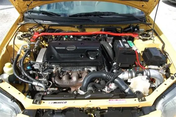

Hey guys, sorry for the delay.. Carfax was clean, but i found one with 37k miles for not a ton more and feel pretty good about it.. I know there are probably more reliable cars, but not for the fun and I do 70miles a day.. I like to enjoy it.. Anyway. the new one i am hopefully buying this weekend has some differences on the engine. Looks to me like the intake is different. And the sway bar looked aftermarket, but i don't know why b/c stock the thing was a riot to drive. Have another look if you dont mind. Just dont want anything heavily modded b/c my goal is fun reliable.

I hate to be the bad news guy, but that engine bay doesn't look like the engine bay of a 35k car. I bought mine with 32k so I have a pretty good idea. The strut bar is not original, the exhaust mani heat shield is missing, and the whole motor just looks more "used" to me. I'd run the carfax or better yet find a friend who can run the full Autocheck report.
Well the car body might have 37k on it, But it looked like whoever owned it has no taste..... ahahaha
Cold-air intake. Mani is stock but heatshield has been removed so may have had a different mani on there at some point.
Interesting that there's a Wiseco sticker above the radiator as that may indicate the engine may have been rebuilt with forged pistons?
