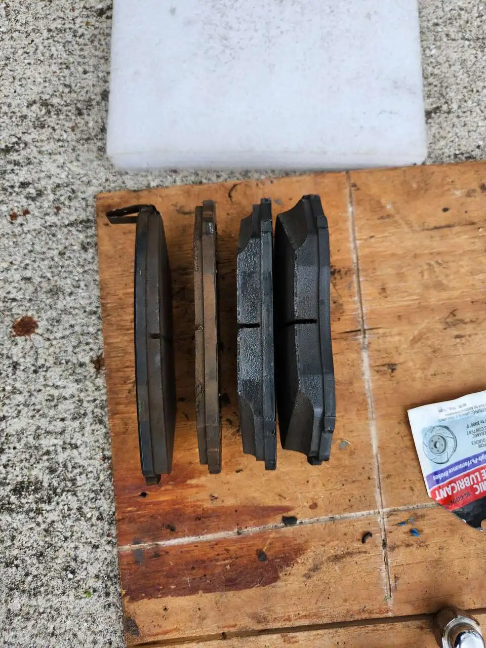

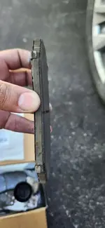

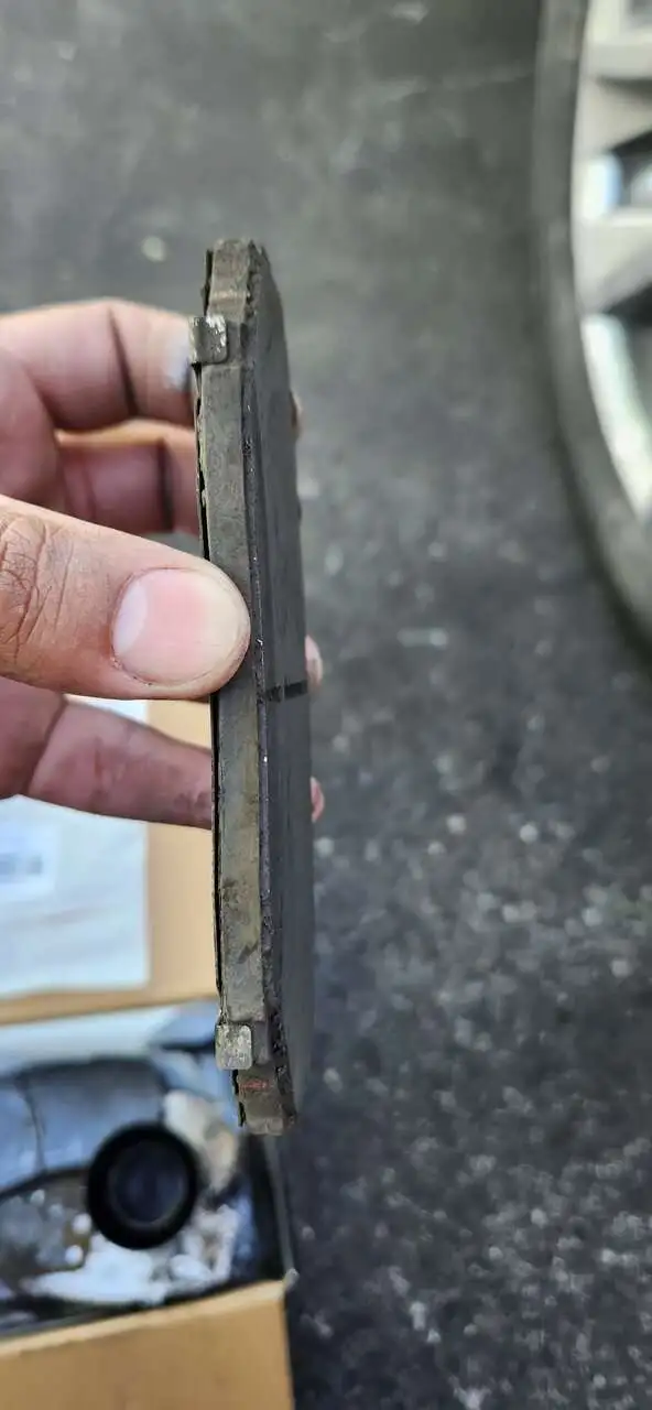

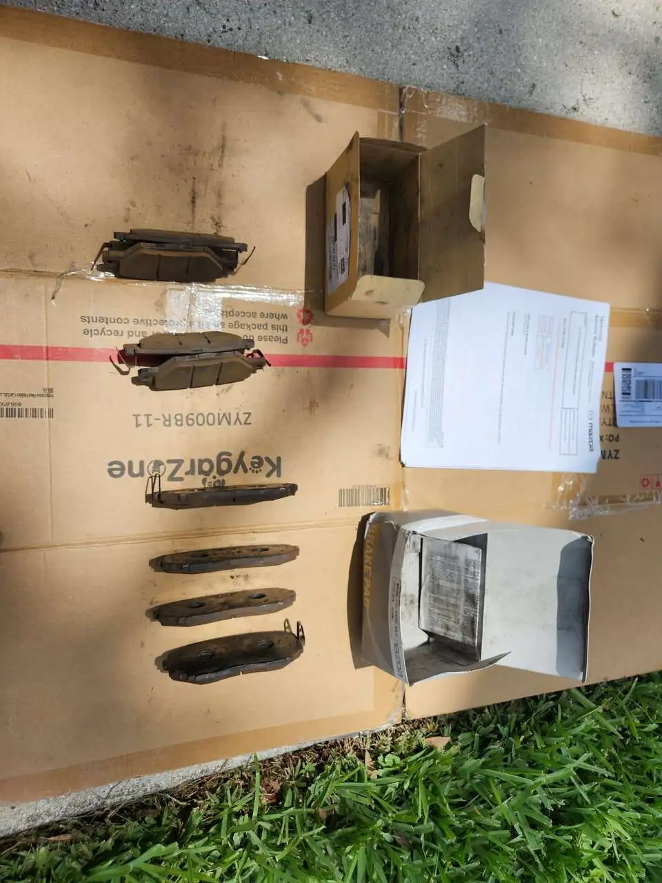

I ended up going with Z23s all the way around with new rotors as well. I was at the 120k km mark. First time the fronts were being changed, the rears were changed before at about the 60k km mark. The fronts were also completely done!!
I recommend the Z23s. It has more bite, less brake dust and a perfect fit. Total cost with shipping and duty etc from Rock auto was $800 CAD or so for the complete set with rotors.
You weren't kidding when you said they were done lol
Right!?!
They were serviced by the dealer, I think they swapped them around and re greased etc to get extra life out of it. Didn't think it was that bad until I started hearing the metal pins rubbing..
Right!?!
I just changed my rear pads and they were only a bit better than yours.

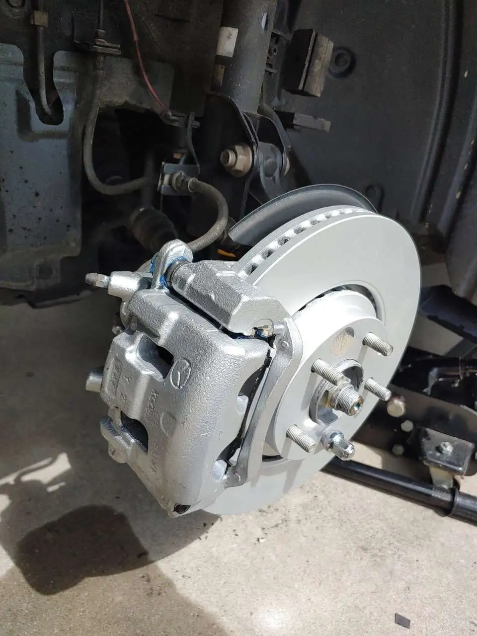

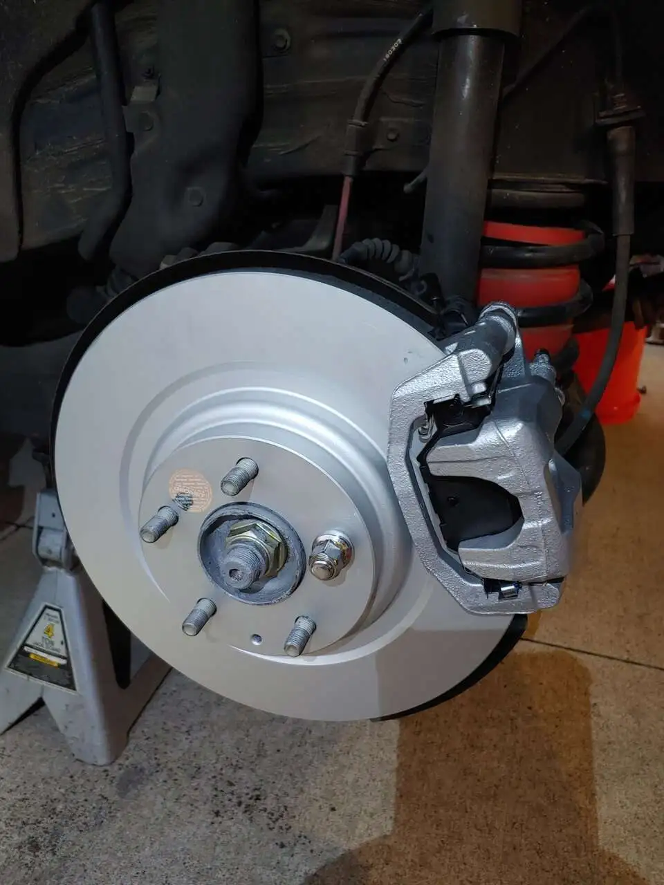

I never dhowed pictures when I made my earlier post on this thread. Here they are.
Again, I used Powerstop geomet coated rotors and evolution plus ceramic pads
11,000 miles later at 51k, the geomet coated rotors are holding up well, with minimal rust even after 2 NE Ohio winters. Same for the POR15 caliper silver paint, still looks new.
The evolution pads are the only dissapointment, i usually do OE pads, and now after driving with them for some time, they don't have the bite I think is appropriate. The bite normal but after you get heat in them after some normal driving and stops, but OEs would have been better with no warm up needed
Im contemplating switching them out.
Lesson learned, go OE or with Z23, Akibonos, nothing ceramic or low dust.
They are wearing very well however.

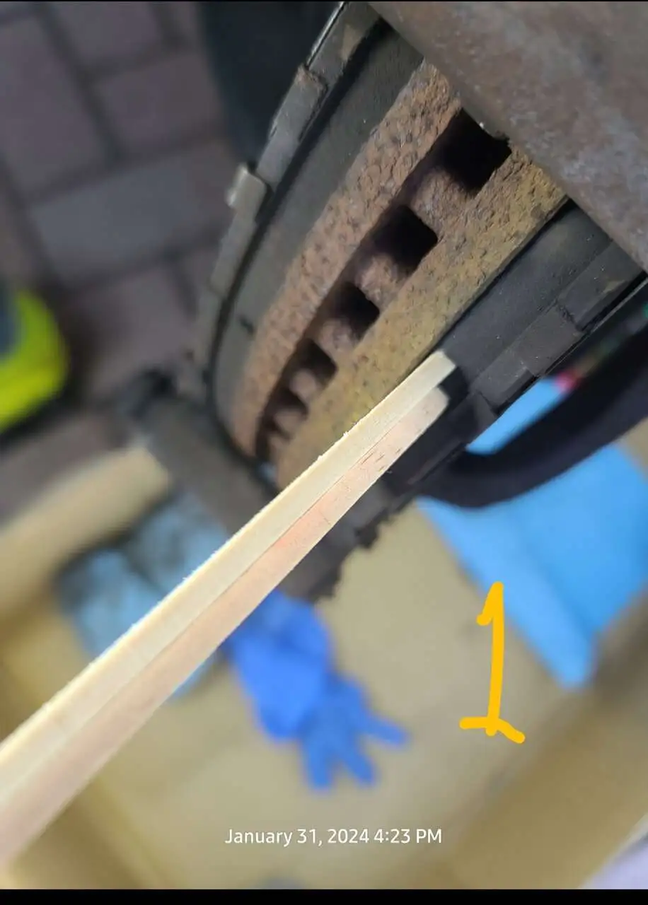

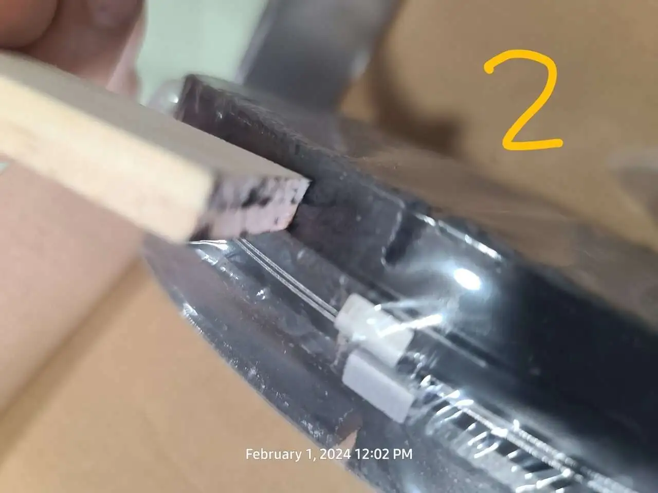

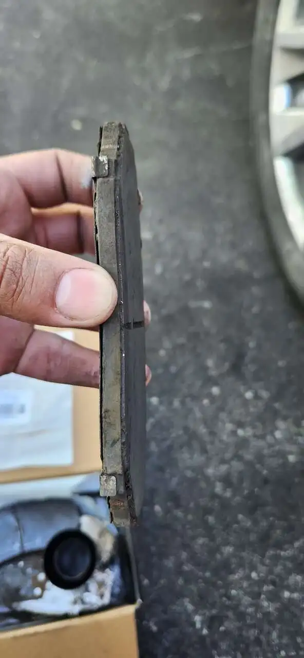

Cx9 2016. 2WD. Got 52k on OEM and 28k on Wagner OEX. It felt a bit better, but not worth the miles.... Just switch to Raybestos eht1934H. If this doesn't work well, I'm going back to OEM. I hate doing my back break with the EBP system. My front is at 72k have 85% still. I attach a photo of it on the brake front and new set in bag. I use two 1 gallon paint stirring stick 😂
See the other post
View attachment 324953View attachment 324954
