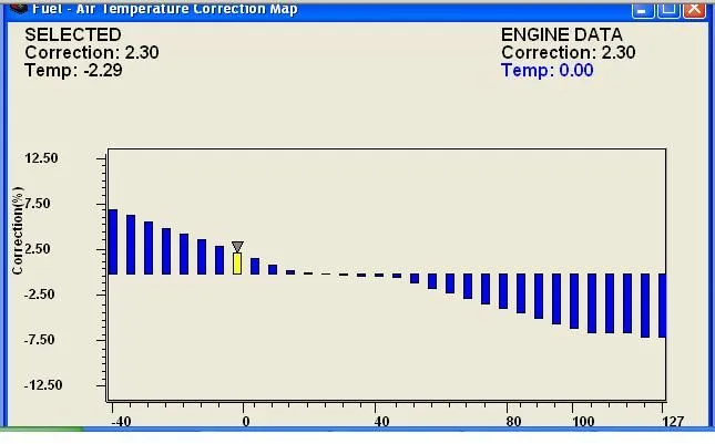

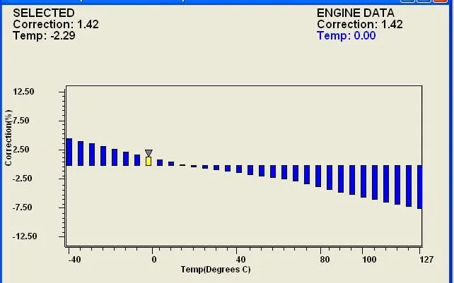

attached are pics of the changes i made to the air temp correction. i dropped it down ALOT across the board. the first attachment is the one Linux sent me and the second one shows the changes i made.

I'm surprised at how linear you guys have those graphs... I know when I got mine right they were FAR from linear.... but it could just be the way things are stacking.
mine is not so linear, i just wanted to give him a good place to start from.
