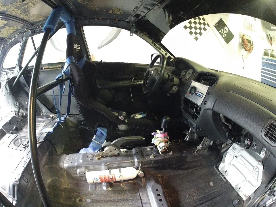

After installing the 5-pt harness and getting everything adjusted I'm beginning to think I should have spent the extra $10 and got the 6-pt. Probably much more comfortable but I didn't want to drill more holes in the car than absolutely necessary. Remember the 5/6th mounting points on a 6-pt harness are a different from the 5th mounting point on a 5-pt harness!
I used all stock pre threaded seat mounts to install mine.
attachment.php
I did the same in my Miata. Had to drill holes for the sub-belts though.
iracemine, you just bolted in the lap belts into the OEM 3-point locations? What did you do for your 5th/6th crotch harness?
I was planning on bolting them to the Corbeau seat brackets or using the eye bolts into the floor with the large backing washer.
I've read the Schroth harness manual a couple times but I always have questions. haha
ps- awesome pic. I love race cars and P5's. Double win.
Anti-sub points are bolted between the front of sparco's side mounts and seat base adapter. The lap mounts are at the rear of the seat base adapter. The rear shoulders are of the "h" style so they drop over the roll bar (to make the correct angle for competition) and then bolt to the front of the rear seat holes.
Belts expired (and for sale) but definitely will buy the same again. However I don't think I want to keep the sparco (yeah, that's for sale too). I think I want a dirt circle race seat. I am kinda on the thin side so I need a bit more side support. Slicks and 800lbs spring rate make a bit of gs (yes I am getting lazy).
