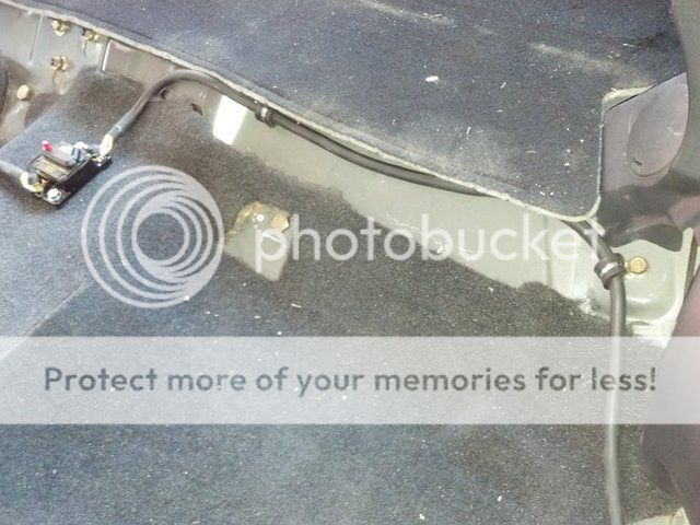

Got some stuff done today. I relocated the relocated battery again. I grounded it on a seat belt bolt (and ground off the paint) and everything is bolted in and I tested continuity with my multimeter.

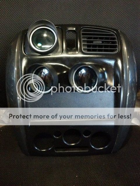

I also pulled the stock center housing to swap the new one in. Water temp on top, oil press on left and oil temp on right. My wideband will go over the steering wheel like last time. I also made and glued in the stereo block-off plate.

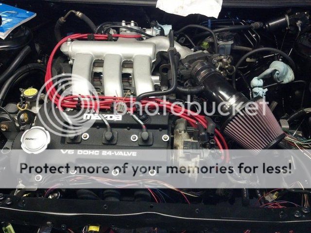

For s**** and giggles I mocked up the intake since I won't be running a MAF with the MS I can run a shorty intake. I will probably run it over to the drivers fender and route an air tube up to it for cool air. But I'm not hip to cold air intakes since my Civic hydro-locked.

You need to have that mouth made into a vinyl and apply it to your radio block-off plate. I like your gauge layout. I was looking at my dash today thinking about doing a custom Subaru style gauge pod up top, if I ever KL swap/boost/actually need gauges....
